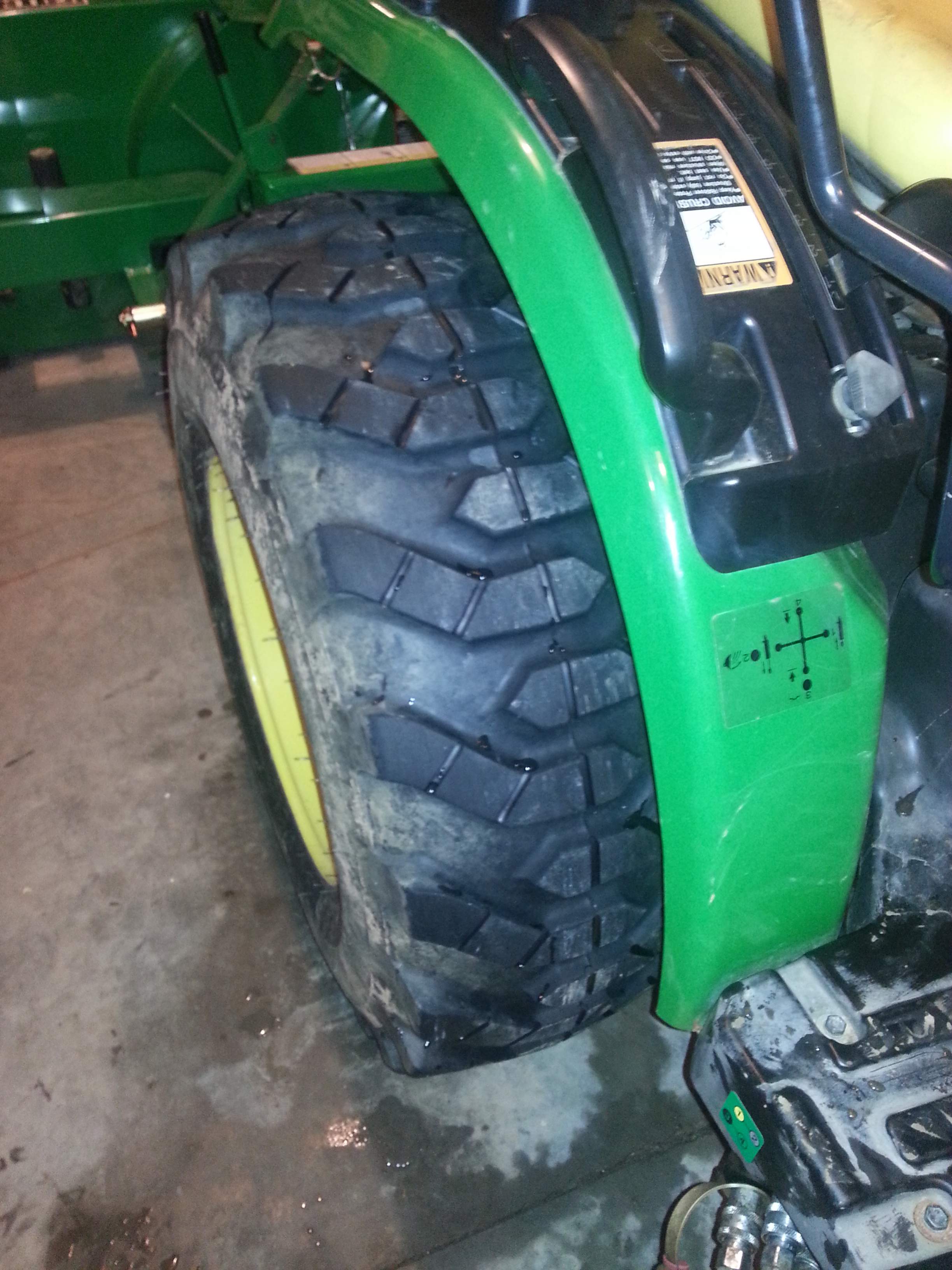

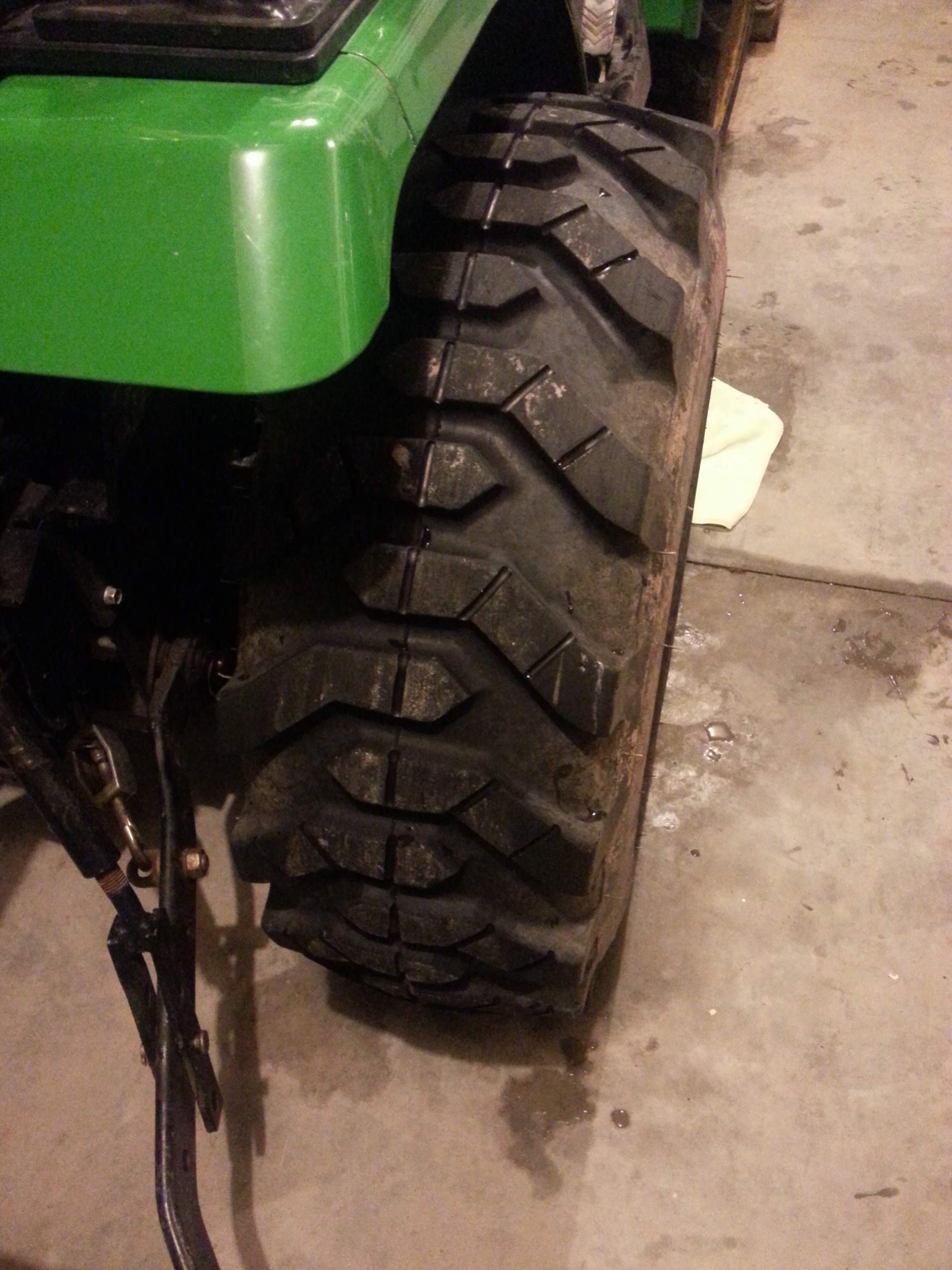

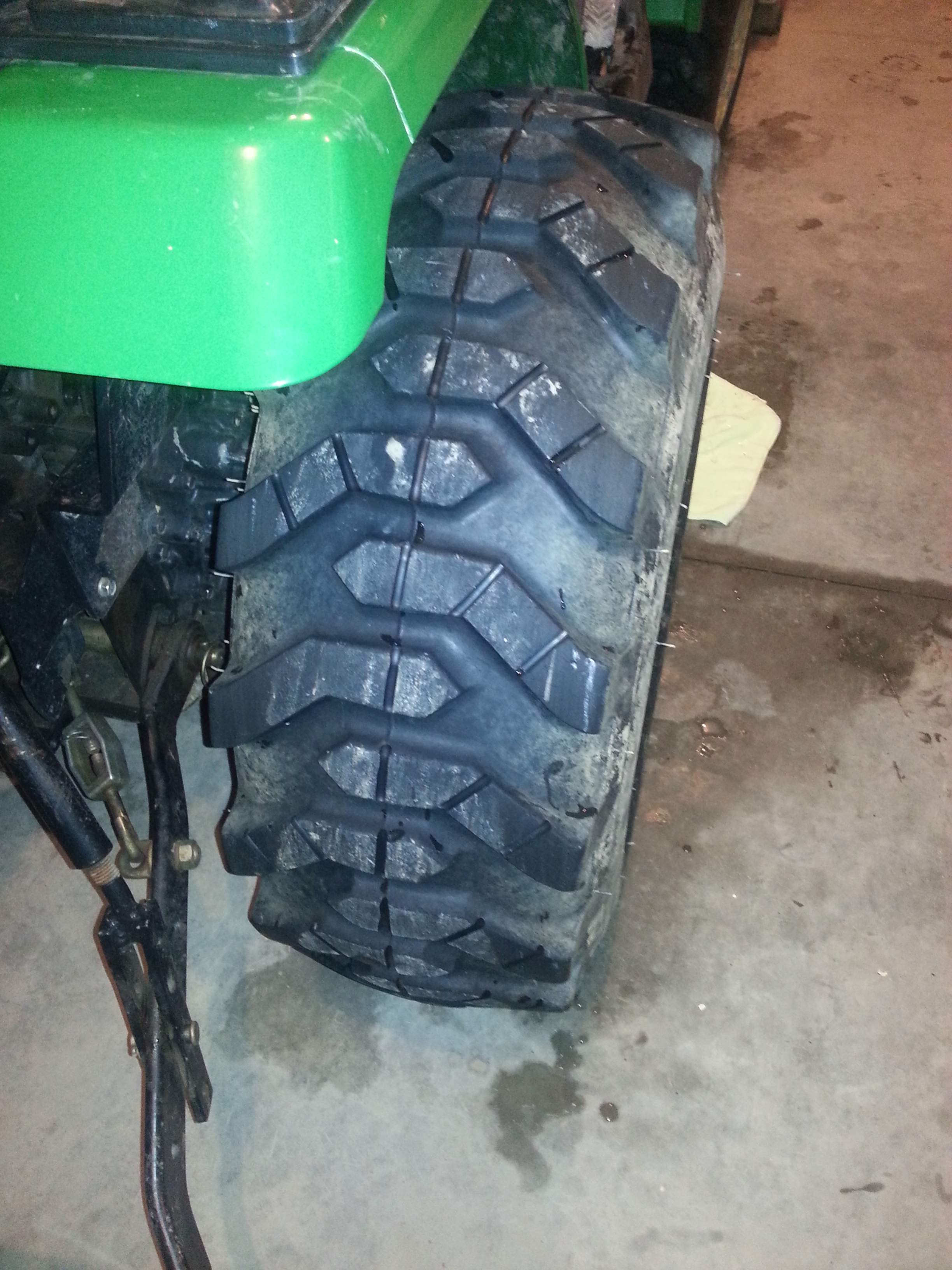

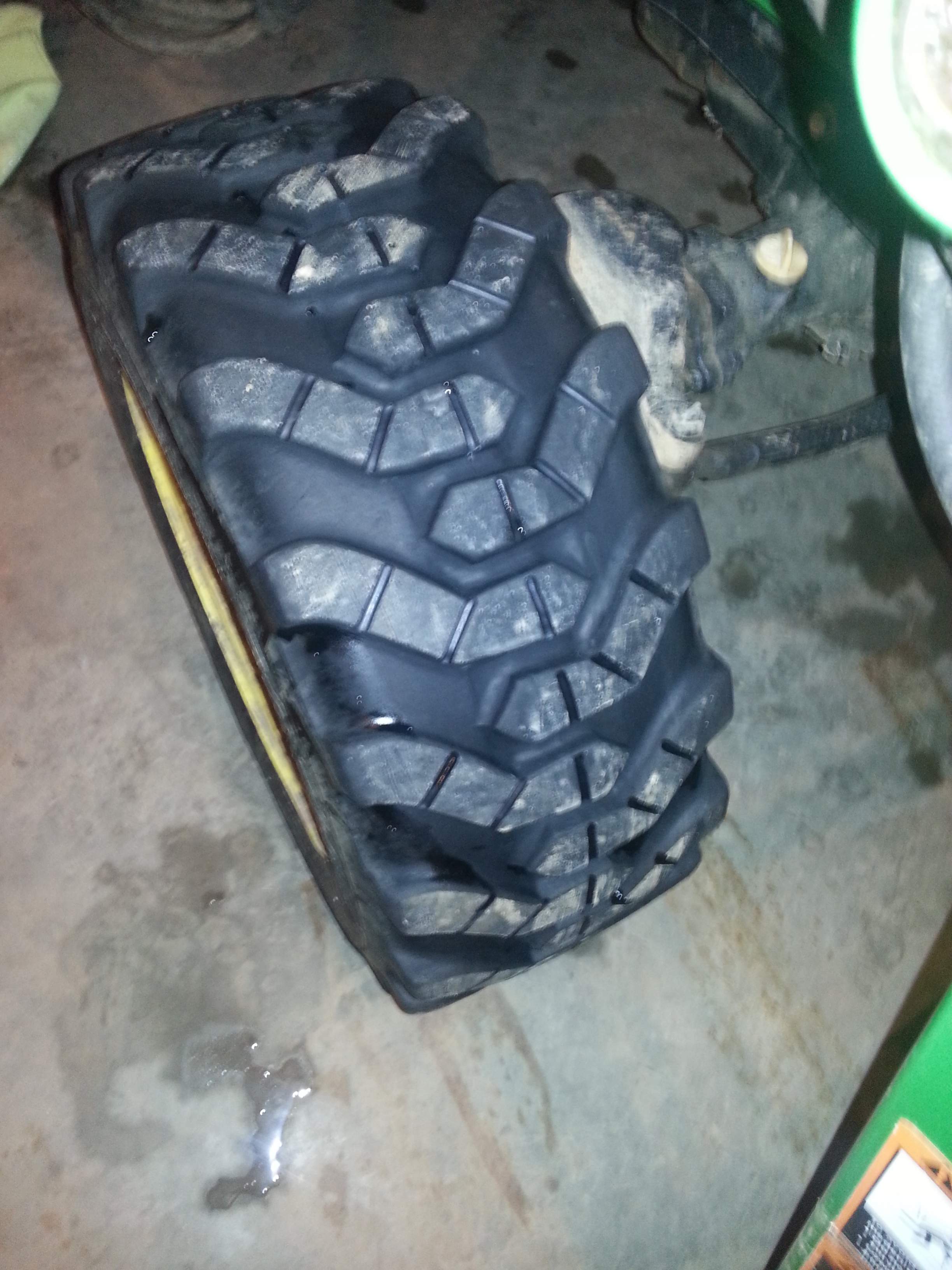

I just wanted to post pictures of the recent grooving of my R4 tires. I can confirm that it does make a noticeable difference in the snow... Not a replacement for chains or maybe even R3's, but there is a difference.
I ended up doing the front the same as the rear as I figure that any biting edge will help with the R4's due to the stiffness of the rubber compound.
We are also under a major ice storm right now so I am also hoping they will be better here as well. I know chains are the best here but for me I was looking for an improvement, mostly in snow.

What did you use to make the cuts?
   / Re: R4 Grooving #4
Re: R4 Grooving
The electric tire groovers drove me nuts with the smell of burning rubber. I took an old panel cutter from my air chisel and sharpened the spur. It will cut a groove only as wide and deep as the spur, but it will do it with almost no effort or smell.
Hmmm. I've grooved dozens of Jeep/Buggy tires with a groover like k0ua posted and never noticed burning rubber smell. You gotta stop and sip a Beer every so often to let it heat up again, but then it just gets hard to push.
