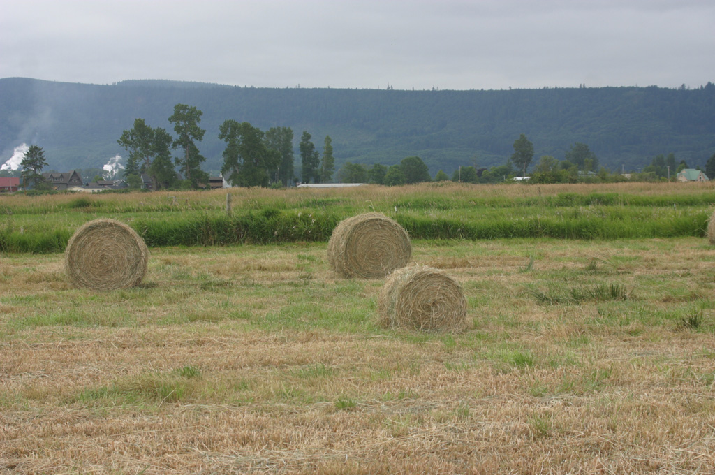

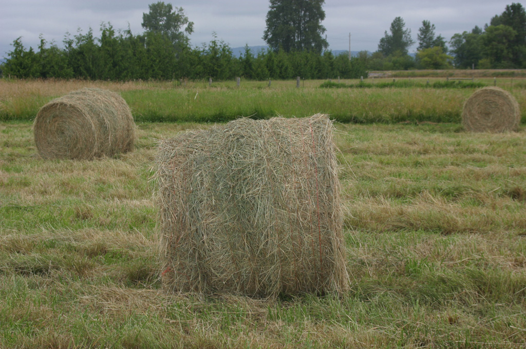

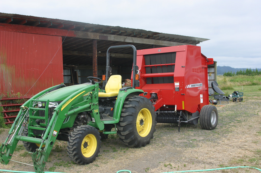

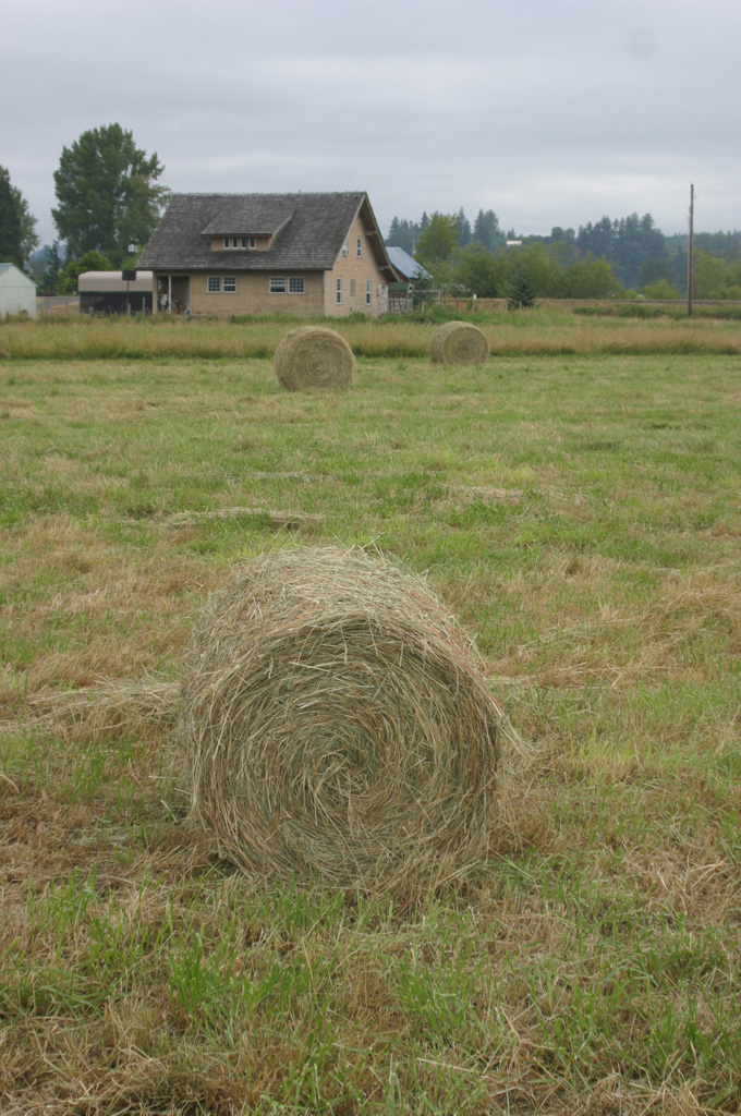

Ok, here are some bale photos. They should be self explanatory. Except the piggies, which is just a gratuitious animal photo. They were weaners last Sunday, so they'll be coming to breakfast about December. A few more days in the nurse pens there and they'll be out on the green pasture.

The baling looks great - even the wonkey bale isn't too bad. I'm jealous!
Greyfields said:
3) A made 30", 3', 4' and 5' diameter bales. After some discussion and head scratching, we decided that the 4' would be best for half our hay and the 30" for the other half. Two people can lift the 30" diameter (the lenght is 46") without too terrible a struggle and they will fit in my front loader. I was thinking of using these for goats, sheep, and other animals who won't eat the big bales quickly like cows would. 48" was really manageable on the tractor, it didn't bog the PTO down; whereas going from 48" out to 60" I had to throttle up a bit to keep things running smoothly.
One comment is that I wouldn't store anything smaller than 4x5 outside. The outer 8-12" or so of a bale is likely to go bad if stored outside. On a 4x5 this is somewhere around 40-50% of the bale - a pretty bad loss. But on a 30" it's basically the entire bale.
If you store them inside I see no issue.
We're now using 4x5 round bales for our horse, but everything we're feeding will be stored inside (13 already are) and we're planning to build an off-the-ground feeder to put large flakes in, to avoid having nearly the wastage we get from placing hay on the ground.

Great pictures! I was wondering how things would work out, since you went with the 1745 instead of the 1734. How did your tractor handle the larger baler?
   / 'Real Farming' with a CUT #30
Sorry, I missed your earlier comment. I am very interested, since I am planning on doing the same thing. I would like to do 4' bales, and would love to try the heavier 1745. My tractor is similar in horsepower to yours, a Mahindra 4530. However, it weighs about 1500 more pounds more than the JD, so if yours could handle the baler pounding, mine should not be a problem. I would not want to tax the tractor doing the baling, it is too important for so many other tasks.
