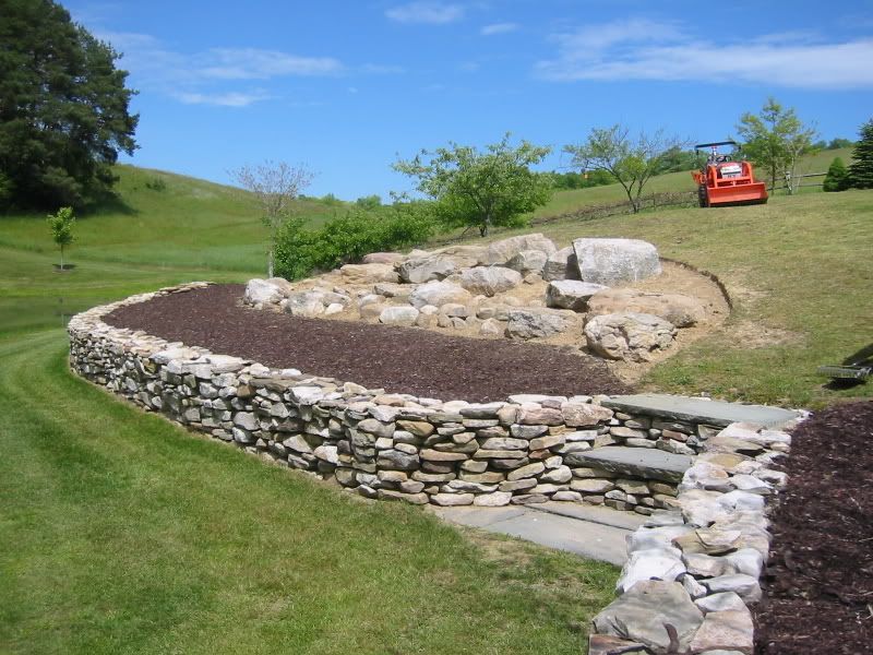

I have done free standing stone walls with field stone with various levels of success.
This one is around 2'-3' tall and 2'wide, backfilled with gravel to the edge,transitioned at a 45 degree angle for drainage off the hill,it has not pushed out after 4 years.
This one is about 4' in the highest placeand 2-3'foot wide,it pushes in the highest area, but its also on a hillside,I use the bota to push it back with 2"X12"'s across the bucket to spead the load.
78982d1181853905-pennsylvania-stone-wall
Here is that whole write up on the construction,but most of it applies to the rock garden
http://www.tractorbynet.com/forums/projects/102305-pennsylvania-stone-wall-project.html
I have had better success with versa lock(solid man made blocks using nylon interlocking pins),but engineering is needed after 48"of height due to the hydrolic load that will push. Mine are no higher than 45" and have had no issues since 93-1994 or so.
With lumber,you have to be sure to get the ones "treated for in ground contact" and deadmans are required. I chose to use deadmans and .50" rebar for anything over 2 ters high as I only wanna do it once, 2nd time round is always more than twice the work!
Prices vary,but if you look hard enough,you will find a good price. My two stone walls are over 120'long for each,and have a total of 120,000 lbs of rock, 39 3000lbs pallets. They cost under 4500.99 for all labor,and stones,including backfill gravel. I did as much as i could though,plantings,layout,trench cut, and all loader work. It took 2 months minimum and looks great 4 years later. All leveling was done by sight.
HINT: Use a garden hose to get the curves you want,keep radiuses with in the turning radius of your mower, once you have the hose where ya want it,spray a line with marker paint along the hose, then use a flat spaid to cut the leading edge into your sod for a clean line.On these,I went 2-3" deep, then used my back hoe,leveled up with the outriggers to cut the 2' trench without the teeth on the bucket, all this then went behind the wall for fill as I moved along.
