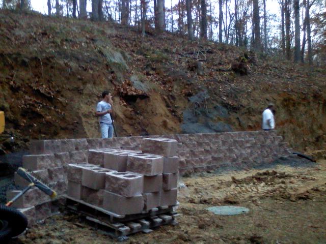

I have a professionally built dry stack retaining wall behind my house, and have been working on building a similar wall on the opposite side of my driveway. It is very simple to do with the dry stack blocks, which for the anchor diamond pro ( professional) run around $6 each for 8"x16". I think the homeowner blocks are ~$5 each but are only 6" tall.
With most of the dry stack blocks, drainage and the first layer is important, but creates an awesome finished product. First, a trench roughly a foot is dug down, and filled halfway with compacted base. then the first layer is laid down and perfectly leveled. If going higher than 4 blocks or if cars are going to be parked next to the wall, geofabric is laid down every two layers. After that, its basically stacking and filling with more base material. stump grinding.jpgretainin wall1.jpg

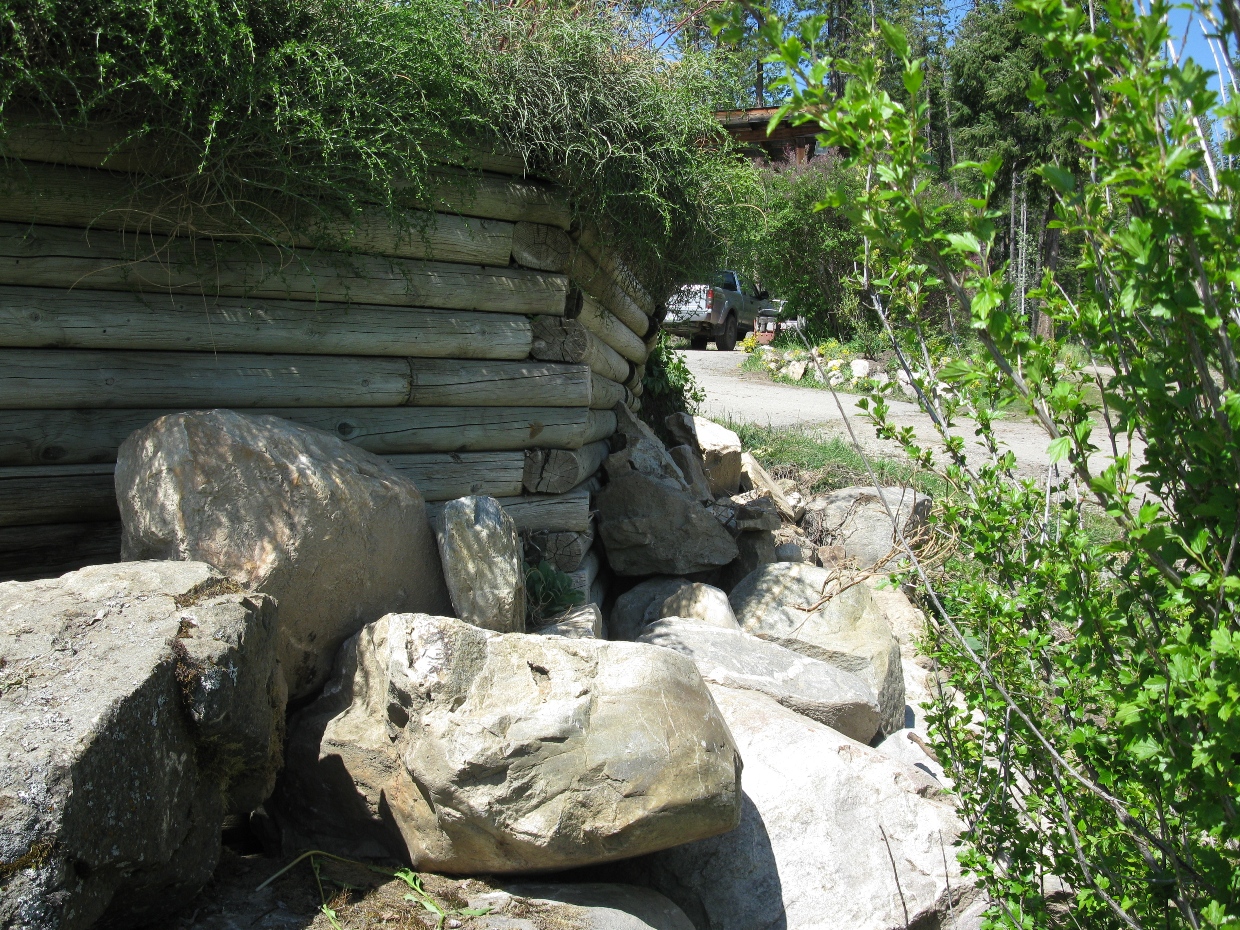

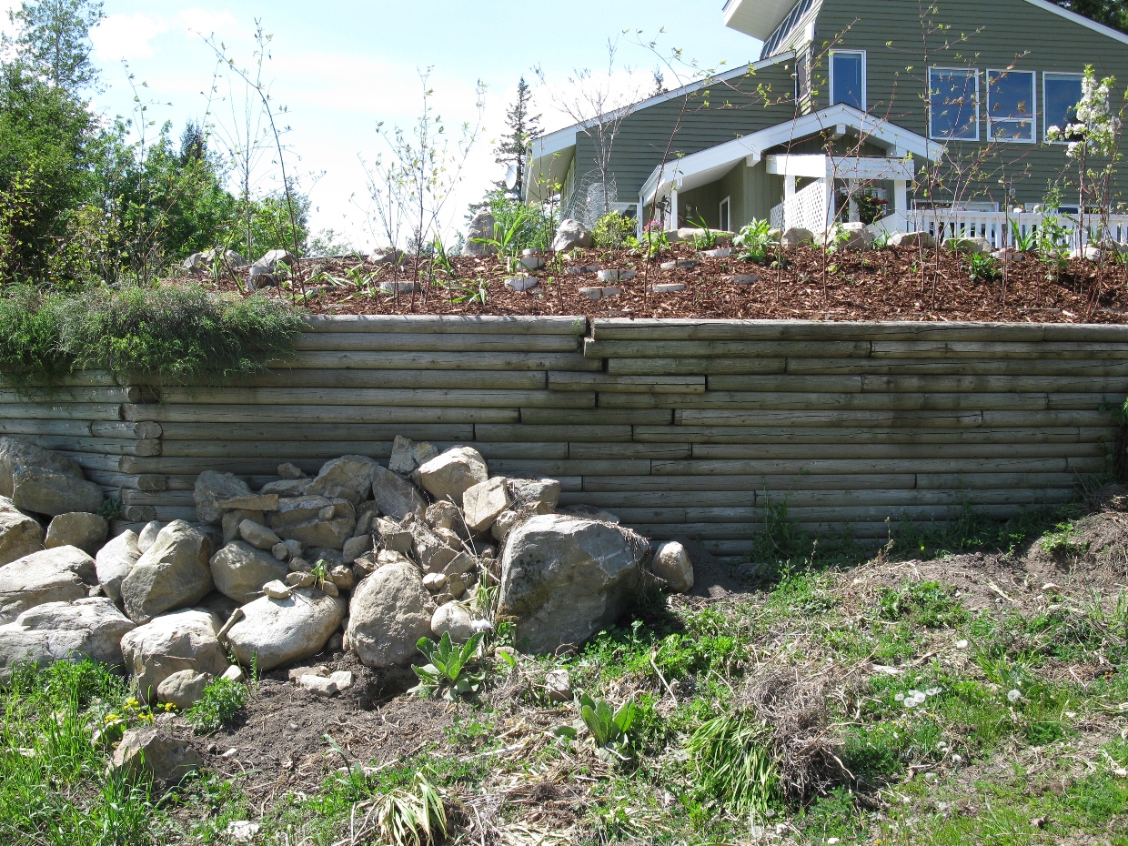

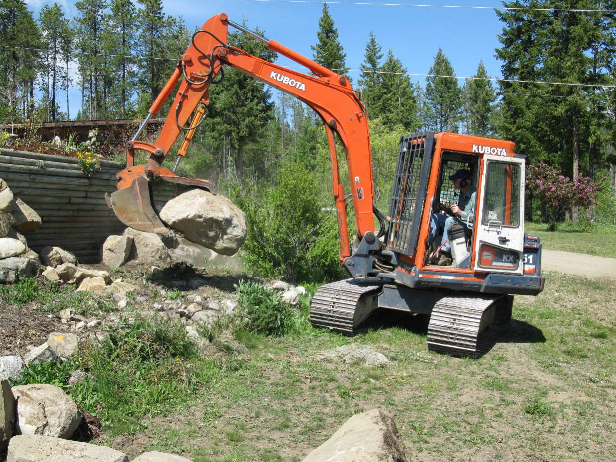

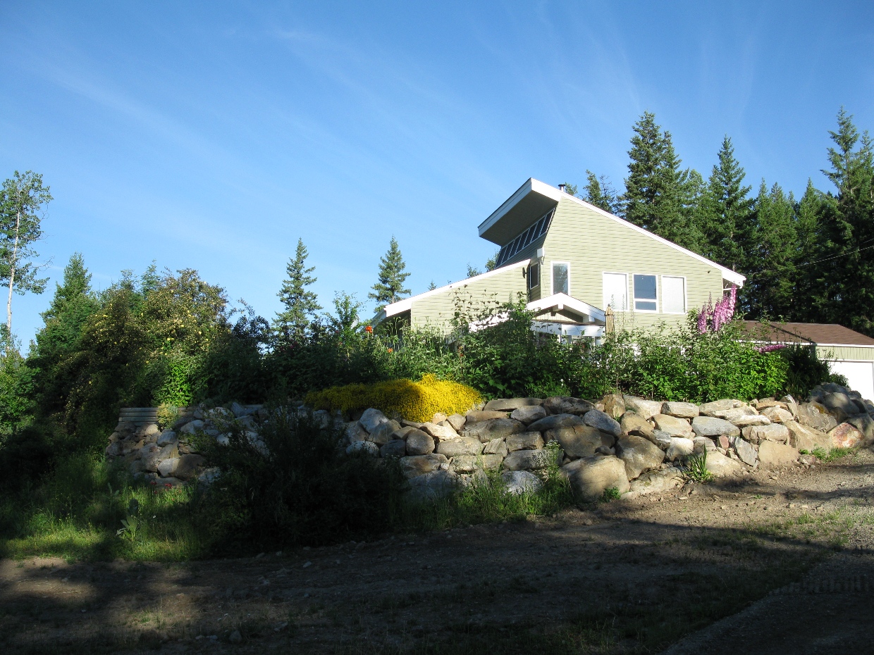

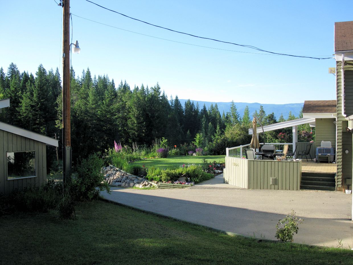

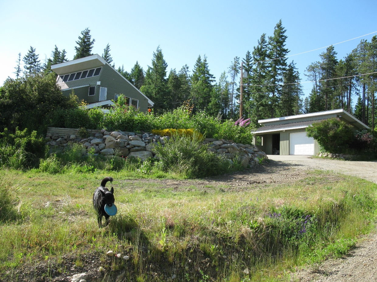

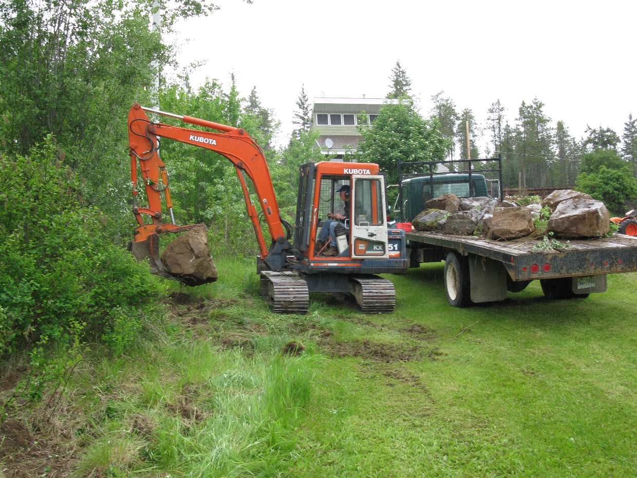

I think you should not build with wood since it will need to be replaced in 20 or 30 years (even if it is treated). I replaced one (very poorly built) wood wall at our first house in the mid 70's with a properly designed 4' to 5' reinforced concrete wall.
Our present house had a treated timber wall ranging from 1' to 7' high. It was built in 1981 and it had "deadmen" to make it as sturdy as possible. In 2009 we shored it up with rocks taken from a new driveway we built to reduce the grade of the old one. In the spring of 2010 it was obvious that was not going to work so we removed those rocks and built a proper wall with rocks we harvested from the property. In the spring of 2011 we finished the remaining wall that varies from about 4.5' to 1' as it was also starting to collapse. I have one more section of 1.5' wall bordering the driveway(in the foreground of the last photo) by the garage which needs to replaced. I'll likely use blocks for that.
We are in an area of old moraines and glacial till and it is quite easy to find large rocks.
Here are some photos showing the old, temporarily shored-up wall, gathering rocks, and the finished walls:
1_20100514_origWall1.JPG1_20100514_origWall2.JPG2_20100522_Gathering_Rocks1_.JPG2_20100522_Gathering_Rocks2.jpg2_20100522_Gathering_Rocks4.jpg3_20100522_FinishedWall.JPG4_20110703_FinishedWall1.JPG4_20110703_FinishedWall2.JPG5_20110704_FinishedWall1.JPG5_20110704_FinishedWall2.JPG
