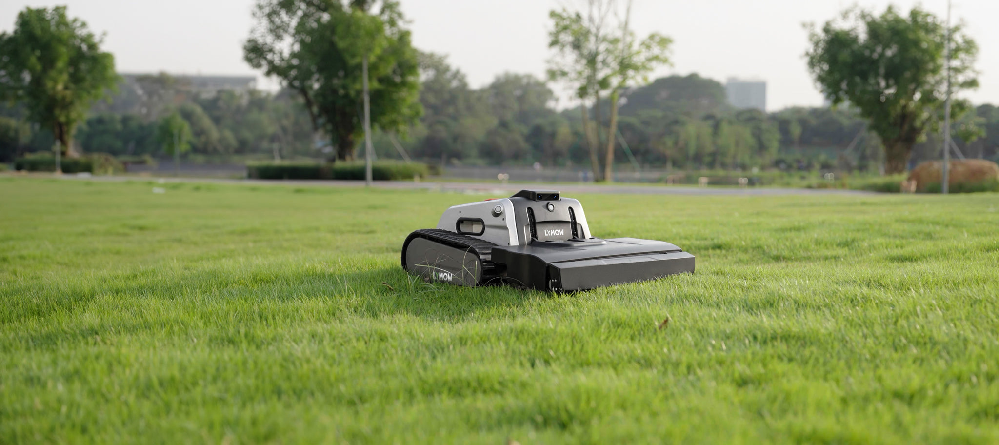

And its on sale for $2200 last day today.
At $2200 it’s really tempting. I’d probably buy one if I knew it could mow somewhat rough terrain on my property with reasonable results. I like the idea, I’m just not sure it would work on my property. Plus, I’d love to see a triple blade option for a better/more consistent cut.

I have some experience with RTK, which is the technology that the Lymow uses. See this thread from a few years ago where combined RTK with mapping for field layout:
Based on what I know about RTK, and what I've read about the Lymow, I'm super impressed. In my experience using RTK and GPS I could pinpoint location to within about half an inch. If they're able to get that working on a lawnmower it's a powerful combination.

It’s out mowing in the dark right now. Pretty amazing.
I am trying to ascertain how it would do in soft, wet ground. I see it weighs roughly 85 lbs without battery. With battery say it tops out near 100 lbs. Roughly scaling the contact patch of the treads. Maybe 10 inches long by 4 inches wide each?
Can you verify weight with battery and tread contact area when you get a chance?
If my guesses are close then perhaps 80 sq-in of contact supporting 100 lbs would be a ground pressure of around 1.2 p.s.i.
I have areas where if I walk after rain, I might leave a 3 inch deep boot imprint. I am guessing I am 4 to 5 times the ground pressure. I suppose I will have to measure.
What about the front "wheels"? would they dig and plow though the soft ground without turning as designed in your opinion?
Can it mower in reverse where the tracks lead the cutting blade? Would this help me in the soft ground pulling the wheels instead of pushing?
Anyway, I know you just got it; so anything you could weigh in on would be appreciated. Thanks in advance.
If nothing else there will be less pounds per square inch imparted into the ground without a full size human. If you can't walk on the ground, it might be sketchy.
For that and steep angles, I'd imagine one like this would work best.
