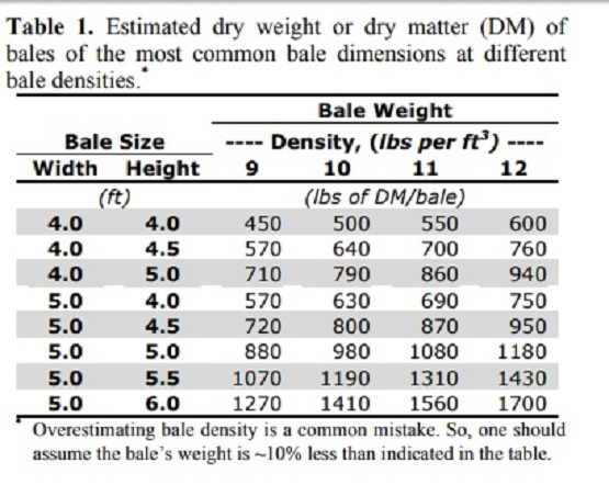

Here is one chart:

Thanks for the chart xman. Excellent summary. I always assume the weight would be based on the least dense number and had thought it was somewhere 400+ for 4 x 4s. I have horses so have bought a gazillion square bales locally (mountains of NC) over the years and can tell you when I see square bales listed as "60 lbs" I snicker. So I understand the craziness of the "1500 lb" 4x5 bale! I'm a girl and know how much I can comfortably lift. A sold 40 lbs is a good bale around here, many are closer to 30.
