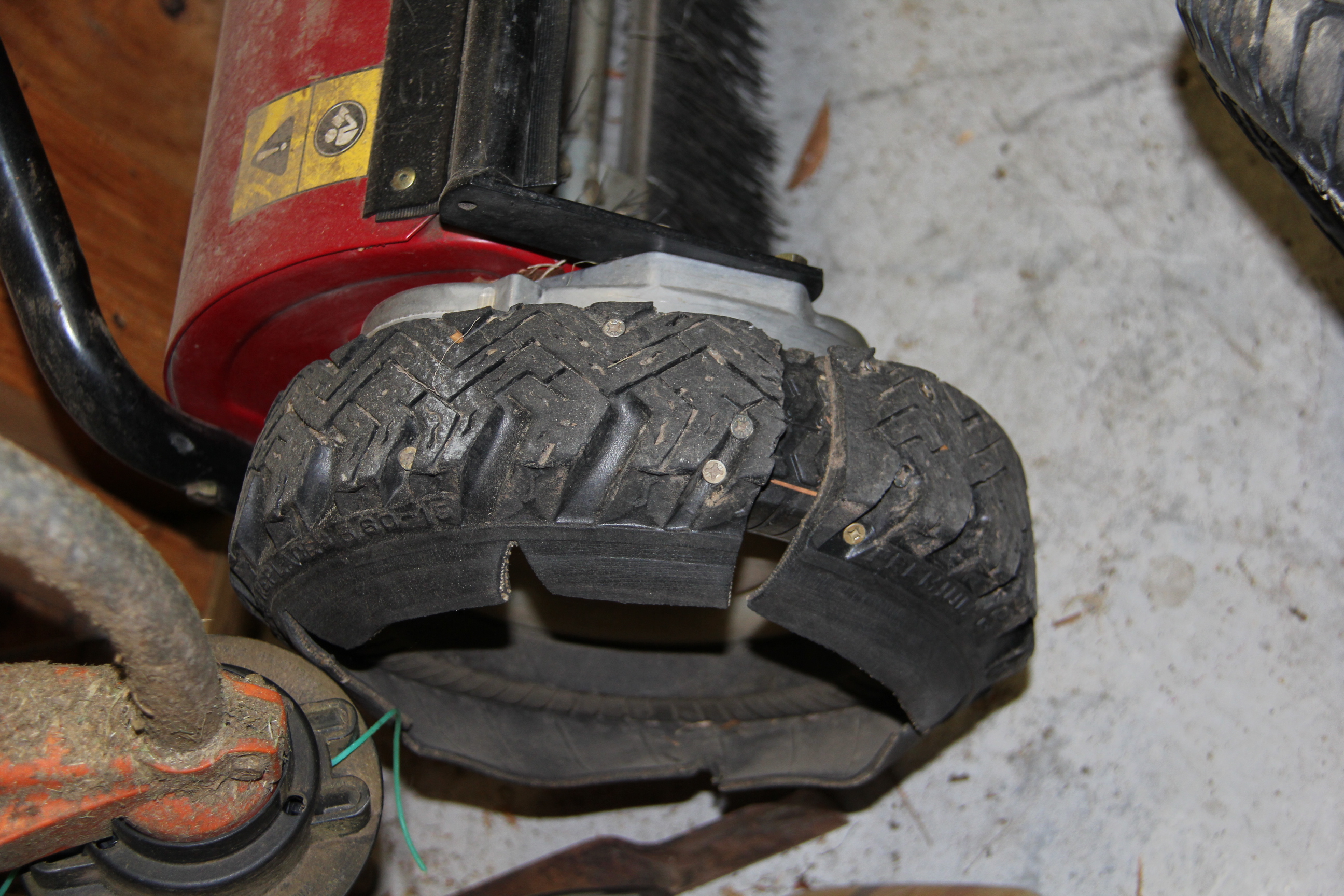

Sometimes driving parallel on hills, the smooth tires will not bite and turn the brushes. I made some more aggressive tires from an old VW beetles snow tires. I cut strips off the edge and used sheetrock screws to hold the strips on the existing tires. (Now that worked great, and they never came loose in over 20 years.)

Up date from the above post.
Here is a photo of the tire with the more aggressive tread. Until I took this photo I did not realize how worn they were. I remove them from my first sweeper and installed them on the newer one. I still have what is left of the tire above my garage, and another VW snow tire I have not yet cut, (from my 1963 Beetle I bought in 1972 :D)

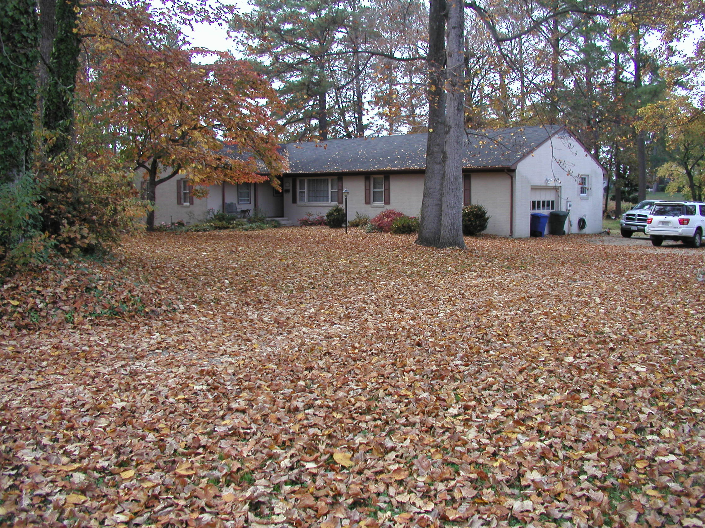

In my yard from October 15 to December 1, every 4-5 days, this is the amount of leaves that cover my yard. No mulching deck will make these disappear. Mostly tulip poplar leaves as big as your hand. Sometimes it is worse after some wind and rain.
I have to "Mulch and sweep" twice a week during this time to stay ahead of the game, or I will have to break out the rake, because soon it will block out the sun and kill my grass. I don't rake if I can help it. I do have the mulching deck on my new massey, but I got it in January, and I have not tried it on these. The OP doesn't have to spend 15K to take care of his leaves if he already has a JD; of course unless he wants the Massey like I did.

Greetings Ron,
Mile9's post wasn't "to spend 15K to take care of his leaves if he already has a JD;" he posted he wants to get his first tractor and mulch 1.5 acres of lawn in the process - plus deal with his leaves. Leaves aren't his primary purchasing a tractor motivation. And he wants a front loader because he has tractor tasks to do. His JD is 20 years old but apparently it still runs too.
Regarding your lawn's leaves - you might be surprised if you try what I do. When fall comes - I always let the lawn grow longer than spring or summer (timed to when the leaves start dropping. Then I set my mmm deck higher and I mulch them when things are dry. Because the grass is a little taller - the leaves are sitting up higher and mulching them when dry allows them to be cut up without matting the grass down underneath. The grass breaths well and the leaves create an excellent natural fertilizing over the winter with no buildup in spring. And by cutting this way in later fall, the worms work the ground until it freezes.
However if I cut the grass shorter during fall season then leaves can't mulch up and fall between the grass - they pack on top of it. I use no fertilizer at all on the lawn - only herbicides for occasional weeds, or pesticide for grubs. Part of my yard is open, and a part about the size of your picture gets leaf deposits like your picture shows.
Try it and see if it works for your lawn area. However - if you fertilize - it likely won't work well because fertilizer drives worms deep in the ground and doesn't allow the grass to develop as strong a root system either.

Thanks for the tip, I will give it a try with the Massey. The John Deere is currently set as high as it will go. I will be delighted if it works.
