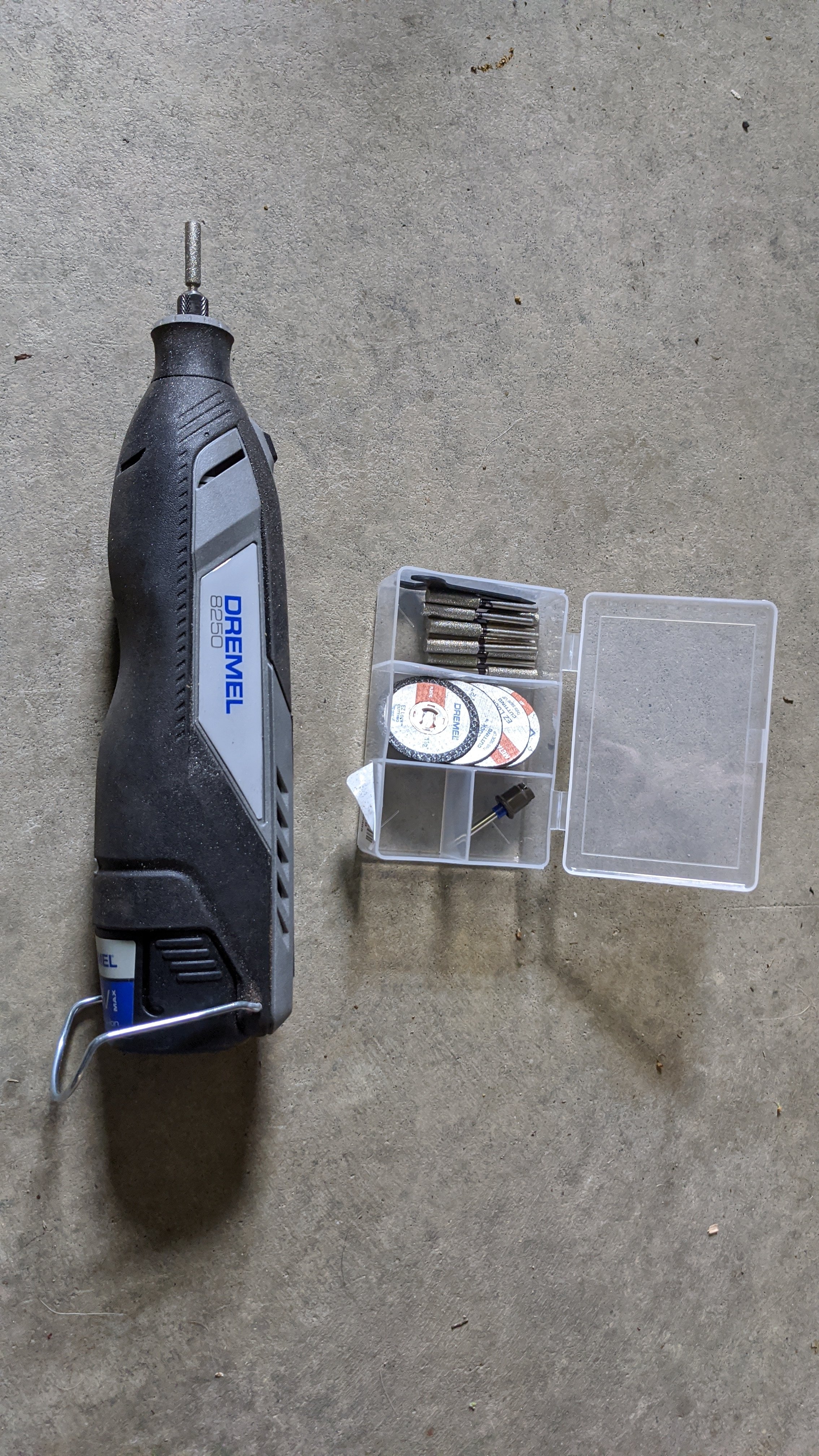

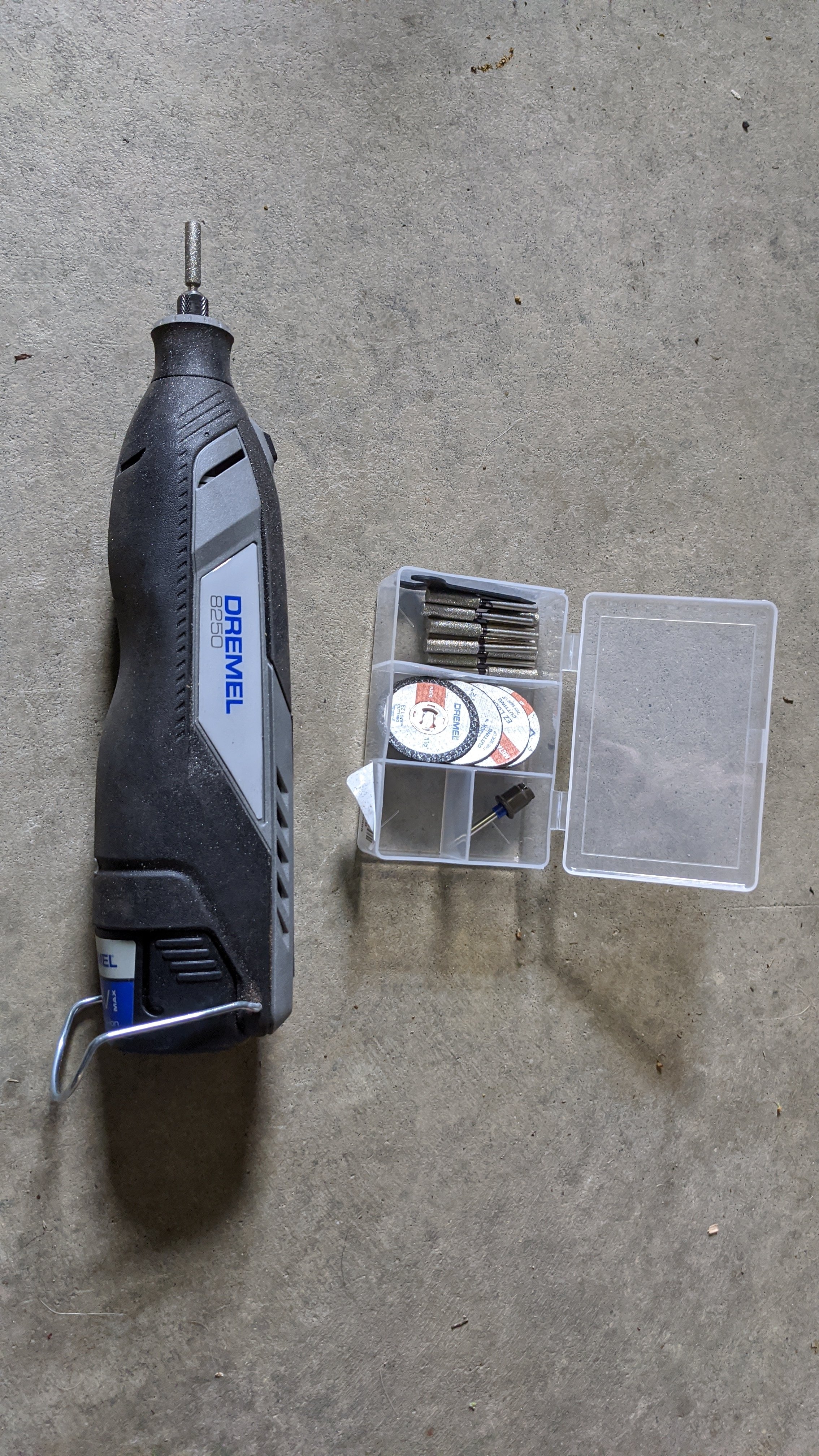

/ Sharpening chainsaws #140
I've never been very good at sharpening chains with a file. My results were always mediocre.
However, I discovered using a battery powered Dremel tool with diamond embedded bits. Correctly sized to the chain, I can get very sharp chains with very little effort. It's almost fool proof. Just go slow, as the bits can be aggressive when new/ fresh. This practice has been a game changer for me. And it's fast.
Good luck
YESSIR! It took me a little bit of trial and error but the rotary tools are so fast you can keep trying until you figure it out. Go too deep and the cutter point dulls out quickly.
