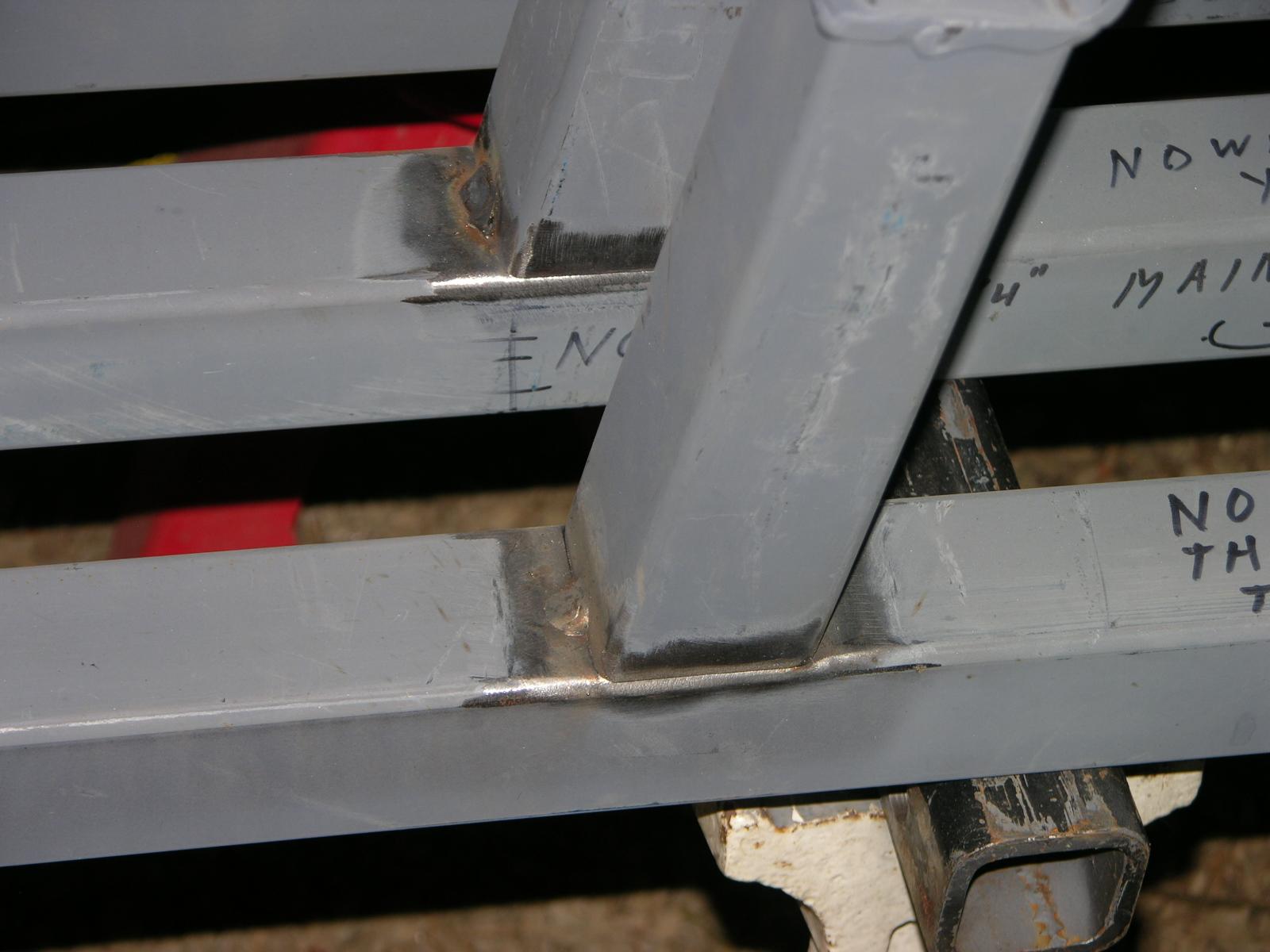

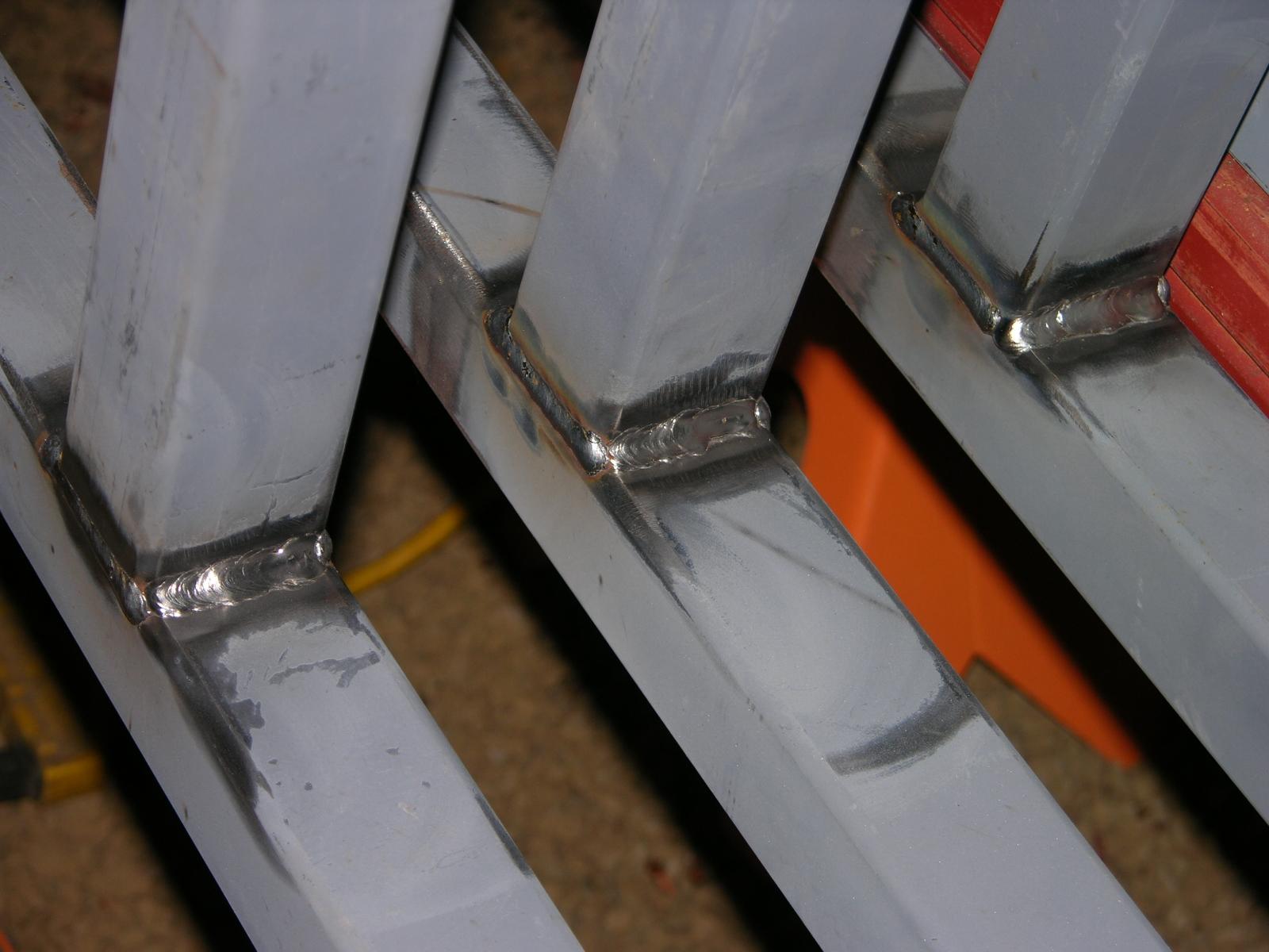

I try to stay away from stuff that just has to be cleaned off so paint will stick so I don't use anti-spatter - pic is .120" wall 2" square tube, mm252, C25 gas, thicker welds (because sides needed to be ground FLUSH) were wire brushed ONLY, sides are as welded in the pic - I will OCCASIONALLY get a couple little BB's, I can almost just let 'em LOOK at a slag hammer and they fall off :laughing:

I've had poor luck with my everlast mig and c-25. Lots and lots of splatter.
/ Sheild gas thoughts? #15
Maybe Everlast "tunes" 'em for CO2? Is there any kind of inductance control on it? Mark could very likely help you sort that out, he's not exactly a "noob" at welding like ShieldArc :laughing: ... Steve

Spatter is minimal on the units I've used. Yes, they do work well with CO2. I use a C18 mix myself. Smooth as silk.
