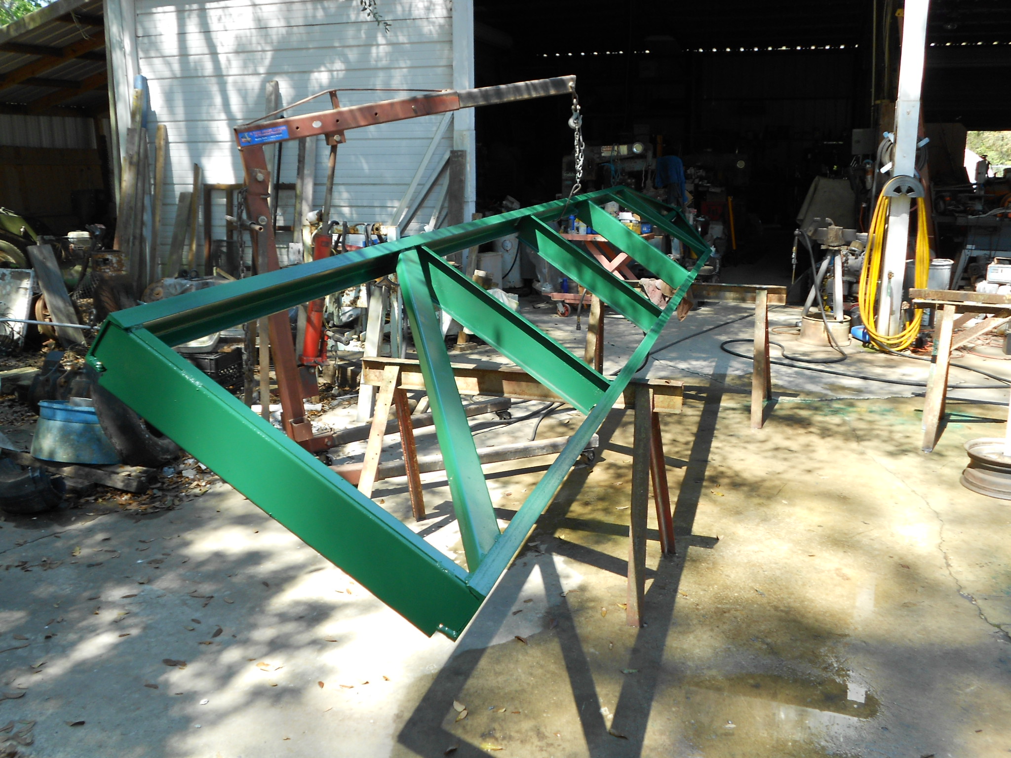

I bought a gallon of Rustoleum at Lowes a month ago for under $30. for another build that I was doing. see pic
