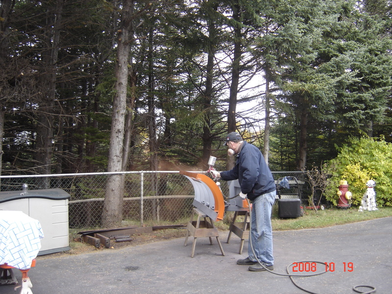

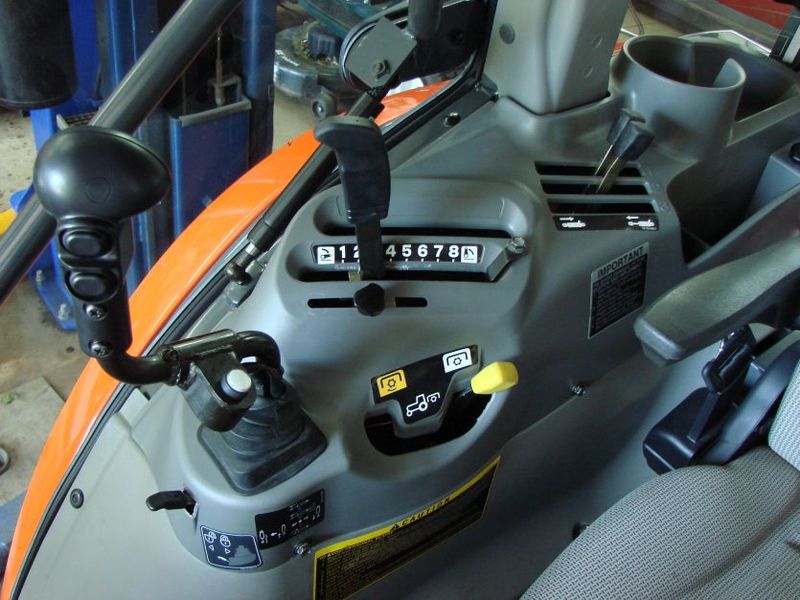

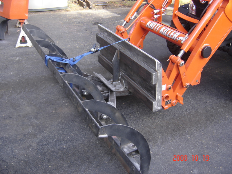

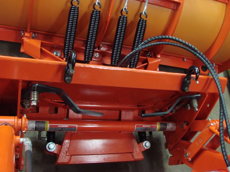

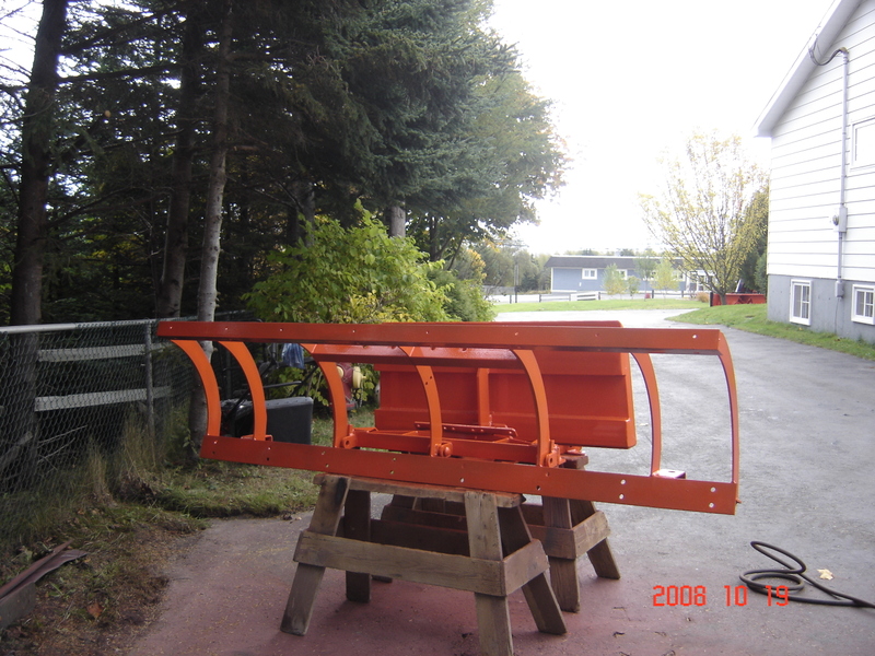

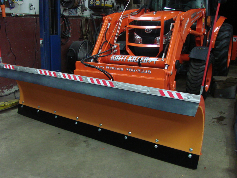

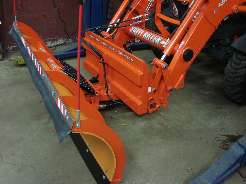

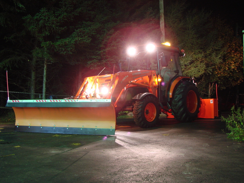

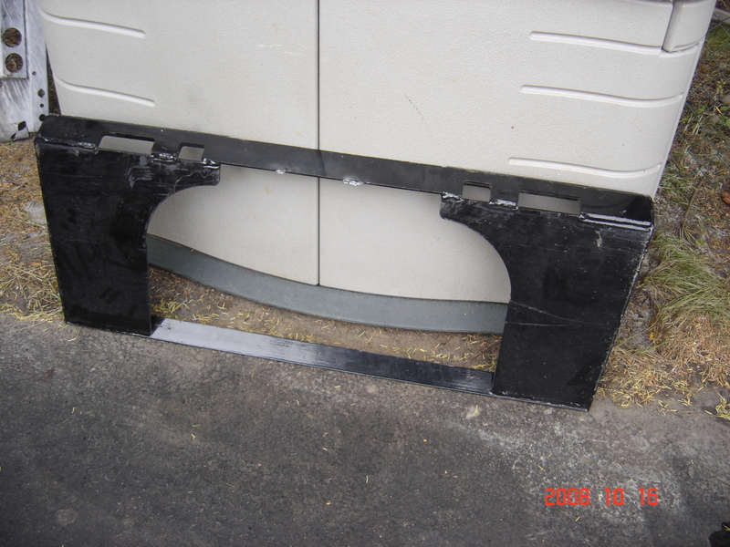

Seeing I'm not using my truck for plowing anymore I decided to adapt the plow to the Kubota . I've had the poly plow new and it was ten years old so it needed a little work to bring it up to snuff again. Took me about 25 hours from start to completion to do the modification but It's all done and working well. I left out a lot of steps here like the actual fab work and the sand blasting but it will give those who are interested a look into how it went.

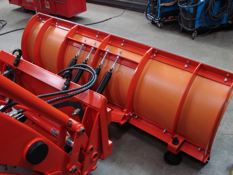

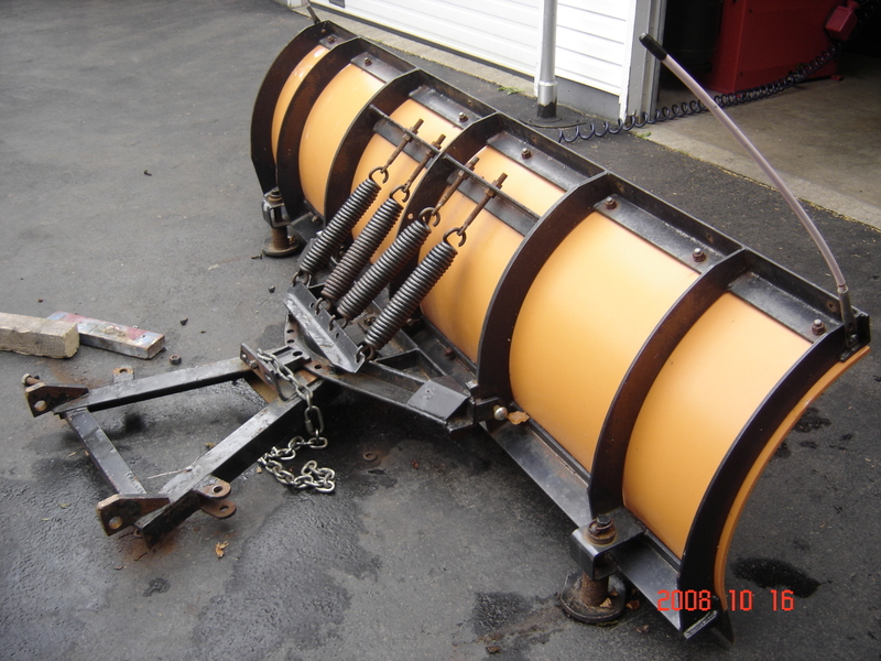

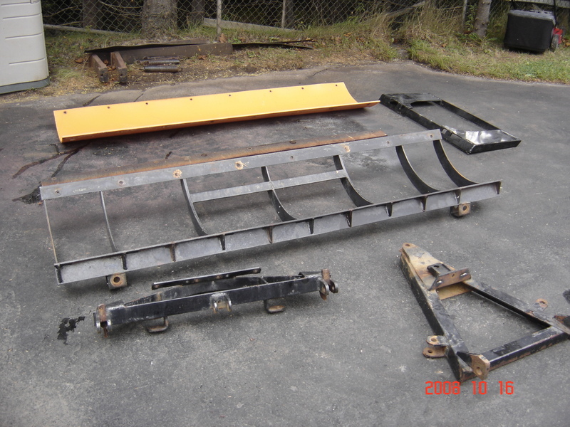

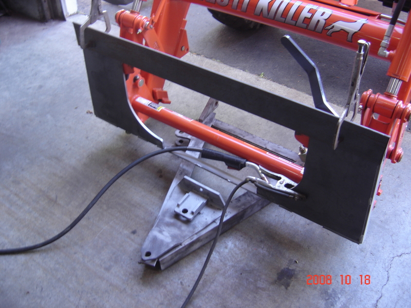

More pics of fabrication

Very nicely done!:D how close is it when its angled all the way. i see that you have moved the A frame as close as you can to bring plow closer to tractor
   / Snow plow adapted to the FEL
I got a little less than a foot at full angle, both sides. About the same as it was on the truck. I moved it all back a bit. I don't like them all mounted right on the front. I was looking for the right look I guess as well as being pratical. Thanks!

Thanks JD. I purchased the Skid Steer adapter for mine but I shouldn't have. Although it was made from 1/4 plate I felt it wasn't strong enough so I spent most of the day adding another 1/2 plate to it. I know for sure it's strong and the hyd's are really strong. With the full weight of the tractor on the plow it angles like there's no weight at all which is good if you need to push yourself out of a bank if you happen to get stuck. My plow is 7 1/2 and is an Artic with the poly front. I think it's going to work well on the tractor and by the looks of the snow today I'll soon find out ;) I'll be posting action shots as soon as I get out to play in the snow

Someone asked how far it angles. Here's a few pics.
