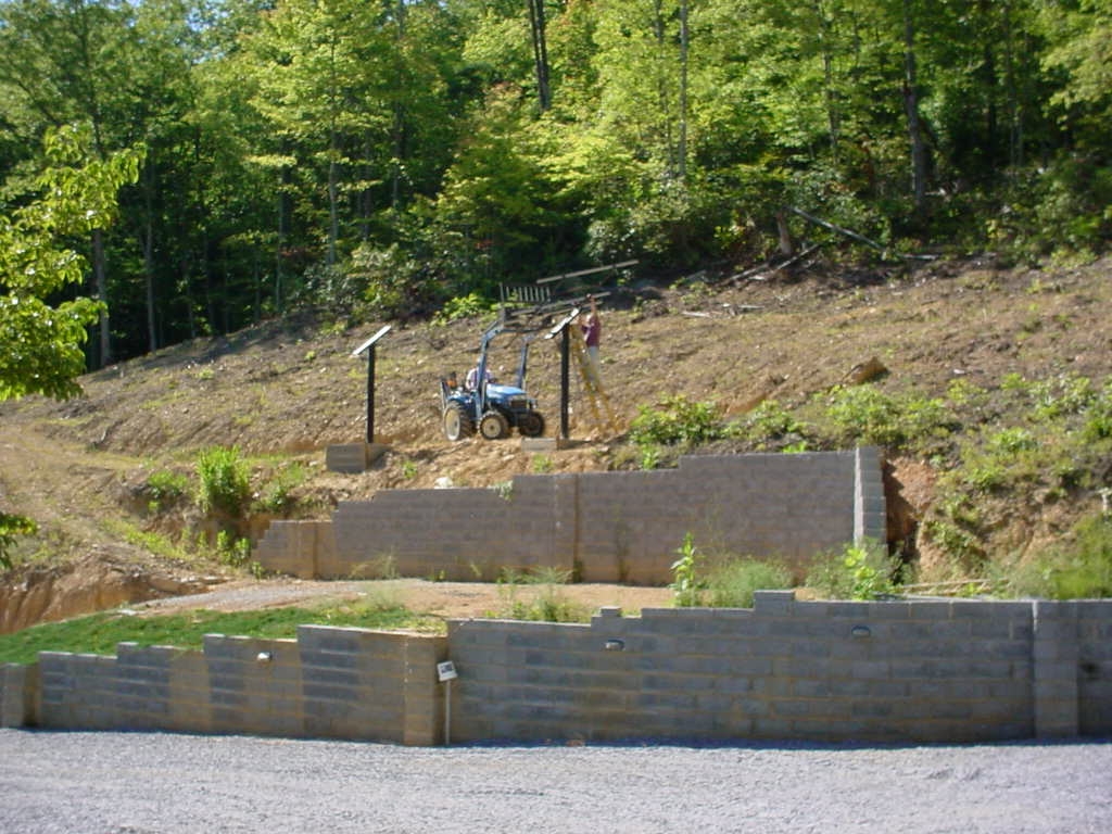

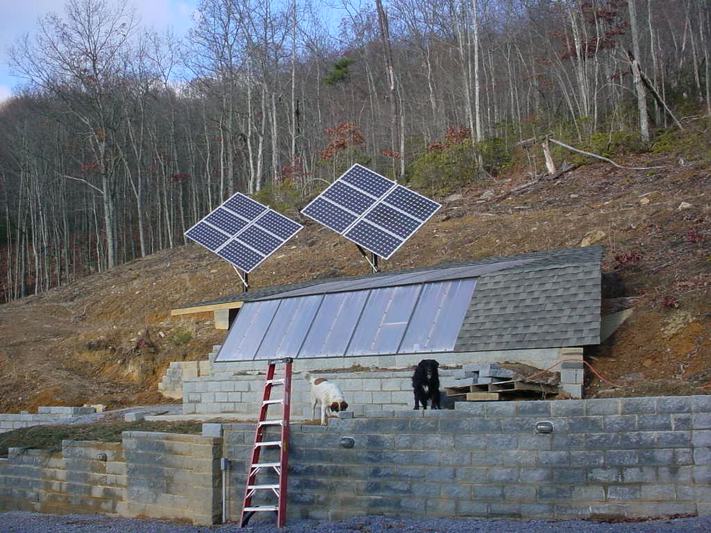

We started down the road of solar power about 5 years ago, first putting up 12 175w panels (2.1kw) on a couple of single axis tracking mounts I welded up in the shop. Built a little green house for the wife at the same time so I'd have a place on the left end for my "power room" ( charge controllers, batteries, inverters, etc ). The system is grid tied, the batteries are for backup power in a grid down situation. Transfer switch in the house garage let's me flip between the two.
Since the initial arrays, I expanded them to 10 panels each, added another tracking array of 10-245w panels, and two fixed arrays of 10-255w for a total of 11kw. We now produce more than we use, and the utility company owes us 400 bucks as of this date. They cut us a check at year end if we have a credit at that time.

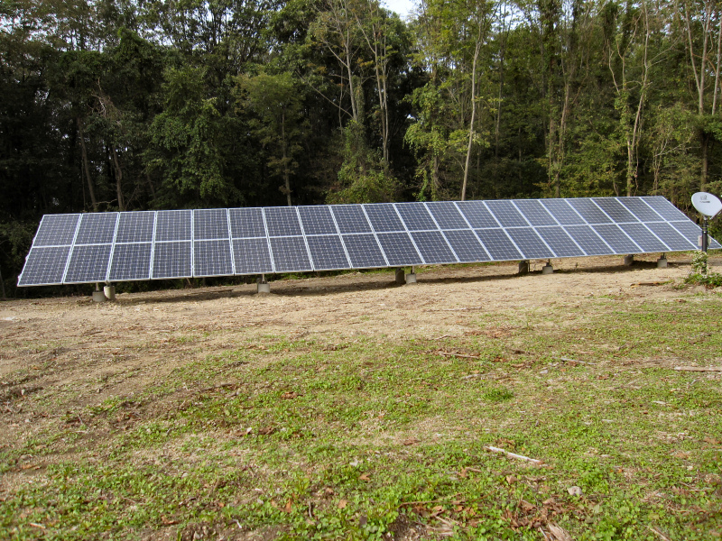

I have a ground array of 40 x 230 watt panels connected to a grid tie system. Been in operation nearly 2 years and producing 1 MWH/yr. This gives us about 60% of our usage. Stats: 2800 sq-ft home with 4 adults in NE PA. Heating/cooling is with ground source heat pumps. Heat pumps also contribute to domestic HW with desuperheater loops. Pool (3/4 HP) adds to the summer load. Shoulder months of Sept, Oct, Apr and June are usually zero or negative utility consumption.

This a pic of my system after the 3rd array was added ( Nov 2011 )

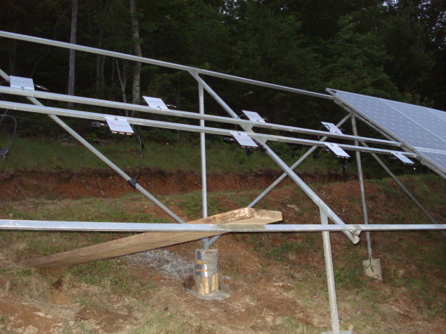

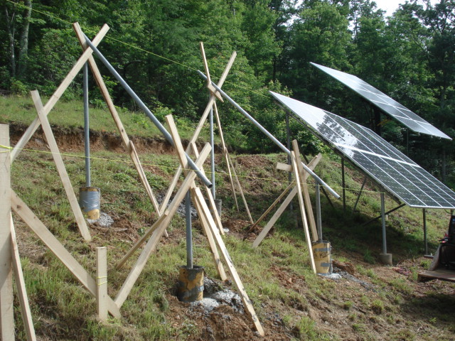

And this was in June, adding the last 10 panels onto the previous 10, which are ground mounted/fixed, and using the micro inverters.
Using the Enphase inverters, you can monitor the power production online, so here is the website where you can see the public side of mine: ( Note: My previous 30 panels don't show on this website right now.....I'm working on a way to incorporate it into that data )
