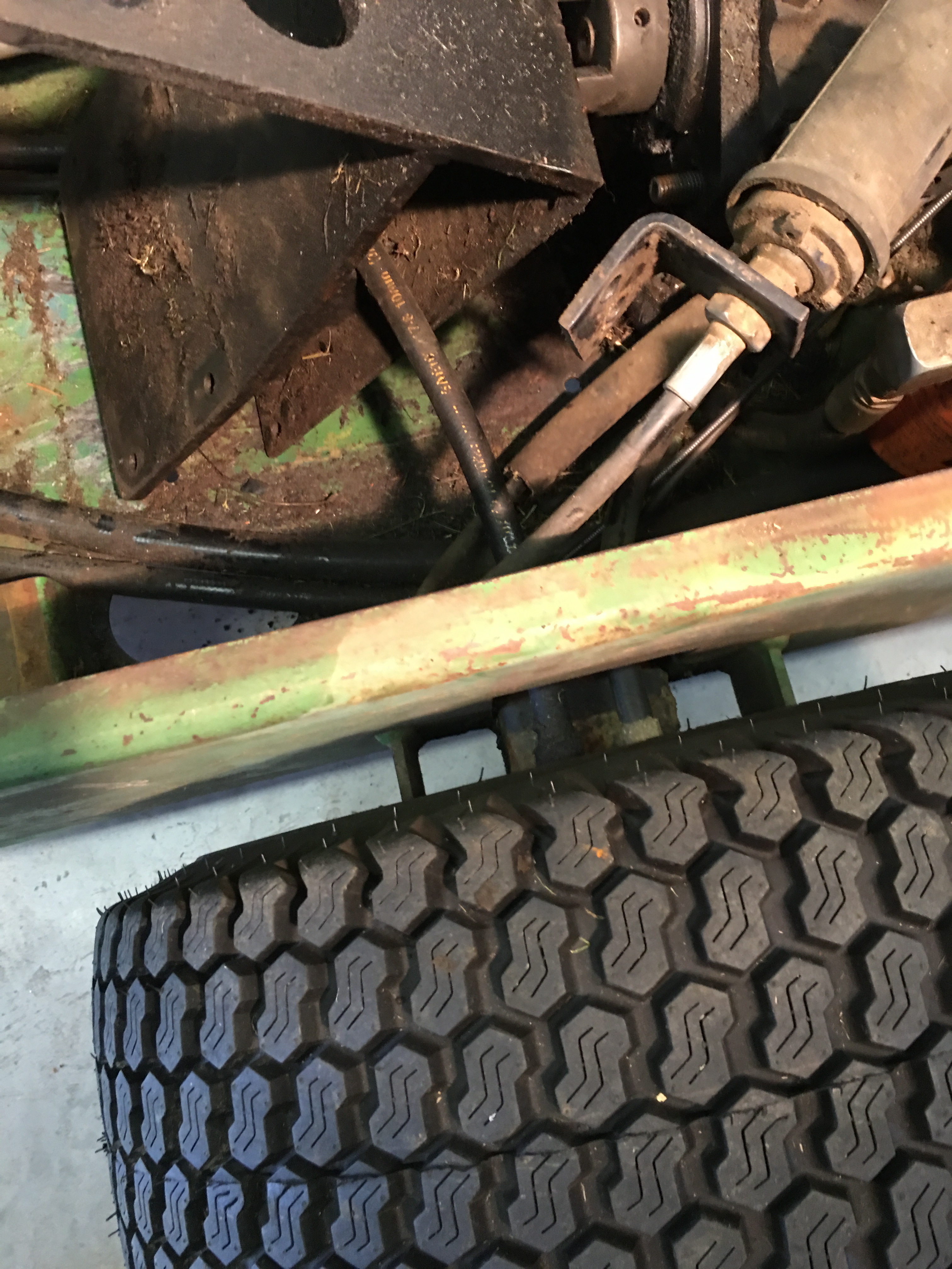

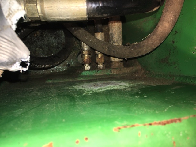

I pulled the 22hp Robin out today. Engine stand is unbolted, however the right rear wheel motor hydraulic line runs through the middle of the stand. Looks as though I will have to disconnect line at wheel motor and pull it through to get the engine stand out. The two hydraulic lines from the oil cooler have a cracked insulation, so I am probably going to disconnect and have two new ones made up. I have to put in a new engine stand made for the kohler. This job is a lot harder than I anticipated.

Hang in there. It always seems harder when you actually do it, but doing it is 10x the reward.
I worked for a guy who always suggested that we double our time estimate and multiply by 10 to get what it was really going to take. It was pretty accurate... :)
All the best,
Peter
   / Swapping Robin out with Kohler today #10
Before you crack any hydraulic fittings...
- Clean everything really, really well. Dirt is your hydraulic systems enemy.
- Make sure you have a plan to plug and/or elevate any opened fittings and hoses higher than the level of the reservoir tank or plug it well. It can and will drain all of your hydraulic fluid onto the floor if you drop the open end of a hose, or open a fitting that's lower than the level in the tank. Several folks have found this out.
As you've guessed, now is the time to check and replace any questionable hoses. You don't want to find them after you've put it all back together.
