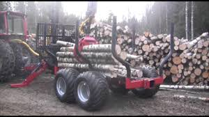

In my country, it's very common to see tractors pulling log cranes and log trailers. Even driving on the road with a full load. Also, in Europe, the tow ratings of tractors can be found on the spec sheets, both brakes and un-braked.
Some of these trailers have brakes, some don't. Some have hydraulic drive on the trailers, some have mechanical drive, others don't. Some mount the crane on the tractor, others mount the crane on the trailer. There is literally an option for all tastes.
Of course, the tractor and trailer are matched to each other (most of the times) and the operator does need to be aware of the stopping ability of the entire combo and how it will behave. You won't see a tractor much smaller than a large frame 50hp tractor often, however I've seen some 35 HP tractors doing this work as well.
People who do it for a living and can justify the extra expense, will shield the entire bottom of the tractor and also fit R1 Forestry tires. Other tend to run R1 Radial tires.
The bigger loggers will usually run a bigger 150HP+ Valtra tractor with the matched logging trailer.
