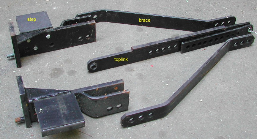

By "rigid mount", you mean a subframe, correct? A subframe is always
better, except in cost.
Now if you are comparing the use of cat 1 toplinks above instead of the usual
anti-lift bars that come with subframe mounts, then I would be confident
that using toplinks would be about as good.
The photo shows the braces you get with Woods 3-pt hitch setups. These
2 Z-shaped braces may have more meat that a std cat 1 toplink, but I
am confident the std toplinks will be fine.
Of course, I am in no way suggesting that anyone should put a hoe on a cat
1 3PH, especially on a little B.

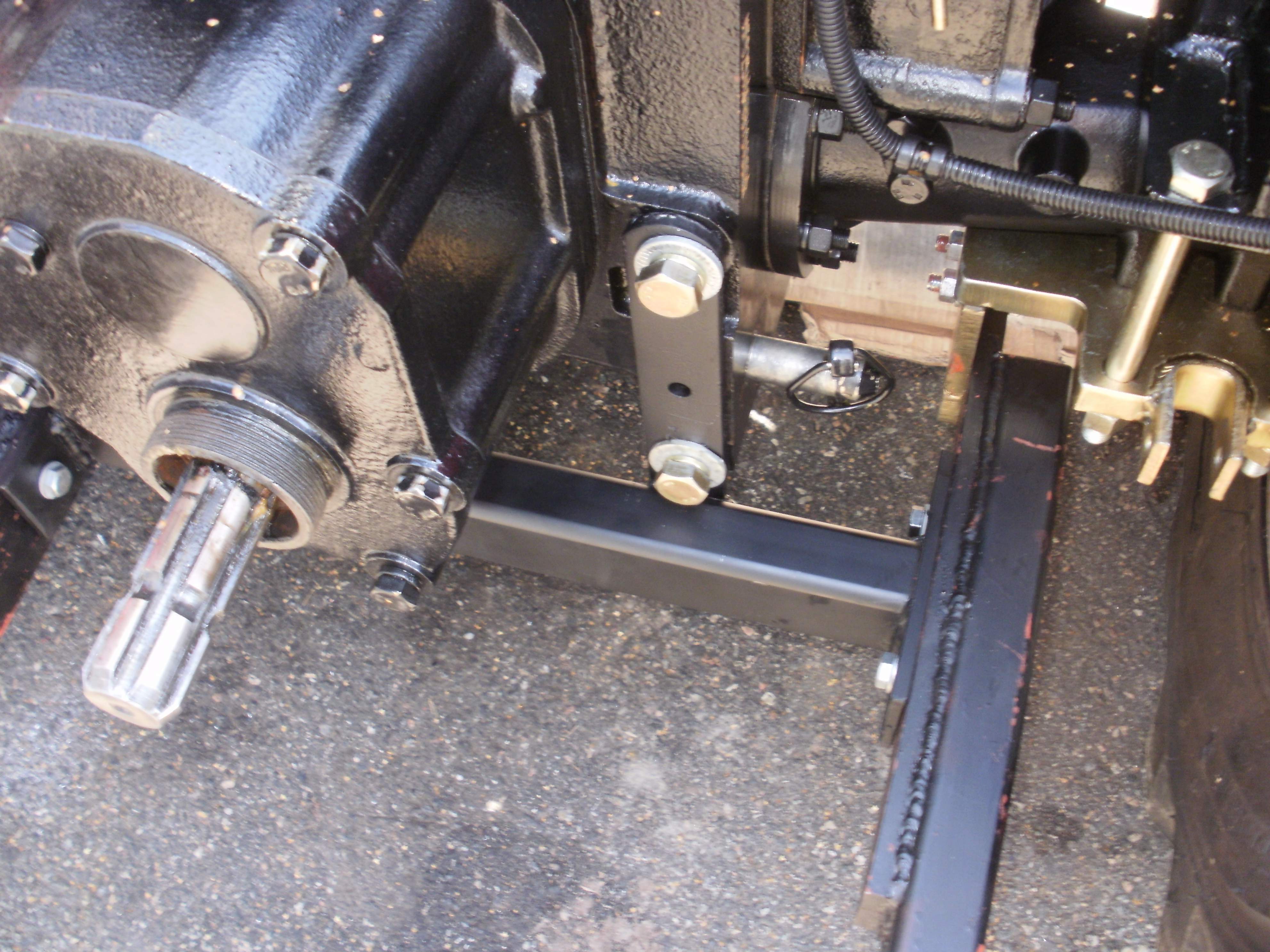

I have a Gherardi side shift 7.5' backhoe, very similar to the Tifermec. Both are Italian made.
Mine came also with this 5 point setup. This is more rigid than the 3 point for sure but I felt it not be rigid enough for the 4850 lbs (2200kg) breakout force so I made a subframe. Cant be more rigid than this. The hoe wont move and inch in its mountings.
Here is some pics, with 5 point and with my "subframe" I kept the top link and the extra 5 point links. The pivot lock is where the lower subframe arms is attached to the backhoe. The two extra links I moved away from top link bracket, it is now mounted on the lift arm hole/bracket. This is much beefier than the Cat 1 top link bracket.
The "subframe" is attached to the FEL frame which is connected from the front to the rear axle. I also took the hitch bracket away and bolted the "subframe" there instead. You can see it in pic 4.
One of the other advantage with a sub frame is that the backhoe is much more closer to the tractor, this make some stability.
I use my tractor more like a TLB than a tractor so the backhoe stays on all the time except during winter time.

Thanks for posting pictures of your Gherardi backhoe. It looks like a twin of my Tifermec except for the side shift. I really like the sideshift feature. The standard five point setup on these two backhoes is identical.
I hope to start my subframe this week. I am struggling with the toplink part of the design. I'd rather not have to remove my sidelinks and I must be able to easily remove the backhoe easily as I am always changing attachments.
