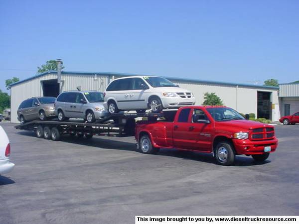

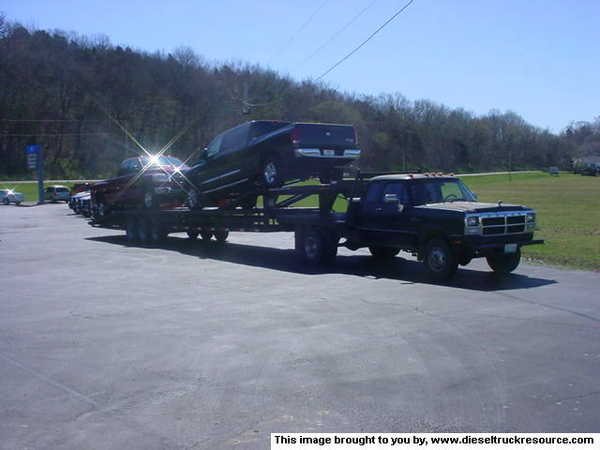

These are the kind of loads I haul..........

Those loads don't look much in excess of a duallies trailer tow capacity, but it does have a suspicious squat to it. You'd be pulled over in my state and checked in a MVCE station.
I bet you're over GCWR on the first picture with the two trucks in tow. I'd guess the GCWR is only ~22,000. I bet those 2 trucks weigh 7,500 each, the trailer weighs 4,000 and the empty towing truck weighs 7,500. That's over 26,000 lbs. No way that truck is rated for 26,000 by Dodge. I don't care if you "register" it for 100,000 lbs, that doesn't mean you know more about what the truck can carry than Dodge, right?
If I am caught anything over the GVWR on my dumptruck, I'm fined and put out of service until the load is transferred to another truck.
Why should you be any different? Just because you truck is a little smaller?

I'm not saying I am legal, I am not even close to legal. The first pic the two trucks weigh about 7,500 each, the trailer goes 8,000, and the truck pulling goes 8,000.
DOT in my state can not run a VIN and know what axle ratio a truck has, and that will affect GCWR. Maybe your state is different?
The GCWR decal on a road tractor is not the manufacturers rating, it is what they are plated for. And most states that is 80,000, except for farm vehicles(at least in my state) which I believe can go up to around 100,000k while transporting commodities, and you should see some of the rigs those guys run if I make you nervous!
Neither of those loads are over on axle or tire ratings on either the truck or the trailer.

That's all I'm saying. I don't feel comfortable operating an illegally loaded (overloaded) vehicle. I think that' what the whole converstaion is about. I can hook my truck to a 20K trailer. Will it pull it? Sure. Is it legal? No. Is it safe? I don't think operating any equipment beyond the manufacturer recommended capacity is safe, ESPECIALLY when you've got innocent people riding down the highway nexty to you who could be harmed or killed.
"The first pic the two trucks weigh about 7,500 each, the trailer goes 8,000, and the truck pulling goes 8,000.
DOT in my state can not run a VIN and know what axle ratio a truck has, and that will affect GCWR. Maybe your state is different?"
Definately different. A simple cell phone call can fetch a lot of information on all the information of a vehicle, especially when it's a cop doing the asking ;)
Axle ratios? Why do you keep bringing this up? Axle capacity is what counts, not ratio.
"The GCWR decal on a road tractor is not the manufacturers rating, it is what they are plated for. And most states that is 80,000, except for farm vehicles(at least in my state) which I believe can go up to around 100,000k while transporting commodities, and you should see some of the rigs those guys run if I make you nervous!"
That's incorrect, it most surely IS the manufacturer's rating . Most (not all) bigger trucks will have the GVWR stamped on the door jamb sticker. Most light trucks, although they have a GCWR, do not usually have the GCWR stamped on the door jamb sticker
"Neither of those loads are over on axle or tire ratings on either the truck or the trailer.
Something must be. With the weights you describe, I'd bet your rear axle is over. We know for sure, even by your own admission, you're over your trucks GCWR. That's enough to be put out of service and fined at a minimum and have the shirt sued off your back in a serious accident with personal injury.
