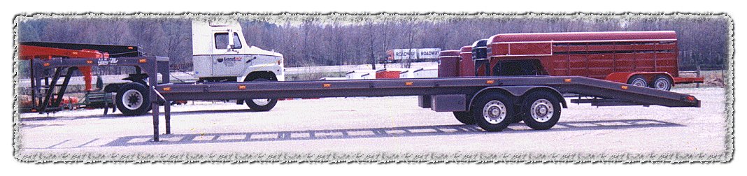

I don't know, I am tired of debating.
I know I am HIGHLY ILLEGAL the way I am running. I am having a big problem deciding what to do right now. I am thinking about selling my three axle trailer that has a 24,000lb GVW and going to a 2 axle trailer that has a 14k GVW and going to a mega cab dually (Dodge) which has a GVW of 10.5k instead of 12.2K like the quad cab dually we run now. Or going to a Chevy crew cab dually (I have one ordered) with an 11.4k GVW. Any of those combos would get me back under 26k and out of the troubling territory I am in now. I have just gotten to like being able to haul two trucks and a Jeep all at once. I am thinking about going to this trailer here and having them make it about a 40' deck instead of the 36' that it is. I'd be losing 8' of deck and one axle. I would put 14 ply tires on it instead of those crappy 10 ply they come with. The trailer I have now came out with 10 ply tires and I had trouble, switched to 14 ply with metal valve stems and 100psi and have never had a flat or blow out since.
Why don't you get yourself a medium or heavy single axle tractor with a 5th wheel and tow any trailer you want? Just get your CDL and get it overwith. You know you want to have one. ;)
Chevy Crew cab, huh? I thought you were "Cummins" Luke? ;)
I would like to, and it is not an issue of money, just hassle. I don't want to get a CDL, a DOT#, fill out a log book, get a medical exam, and all the other crap that goes with it.
You still haven't figured out who I am? I sell both brands you know!

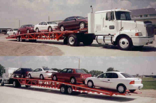

A rig like this is what I NEED, but I don't want the hassle.
Yes, I remember you!
A CDL is easy. You only need a DOT# if you travel out of state. They're free and you can apply for one on-line. I don't get one cause I don't haul with my truck out of state. Log book is only needed if you travel past 150 AIR miles of your home. Med exam is easy, too - a 1/2 hour physical you need once every 2 years.
You must be really out of the loop on rules. :D You need a med card for any commercial truck over 17,000 GCWR. Heck, you need a med card for any commercial truck over 7,000lbs doing interstate commerce. You need a fire extinguisher and 3 red triangles for any commercial truck, period. Basically, any 3/4 ton truck or 1/2 ton truck that crosses state lines needs the driver to have a med card.
So if you're transporting cars the way you are set-up, over 150 air miles from home, you need a med card, fire ex and red triangles. You might also need a log book if you're 150 air miles from home.
