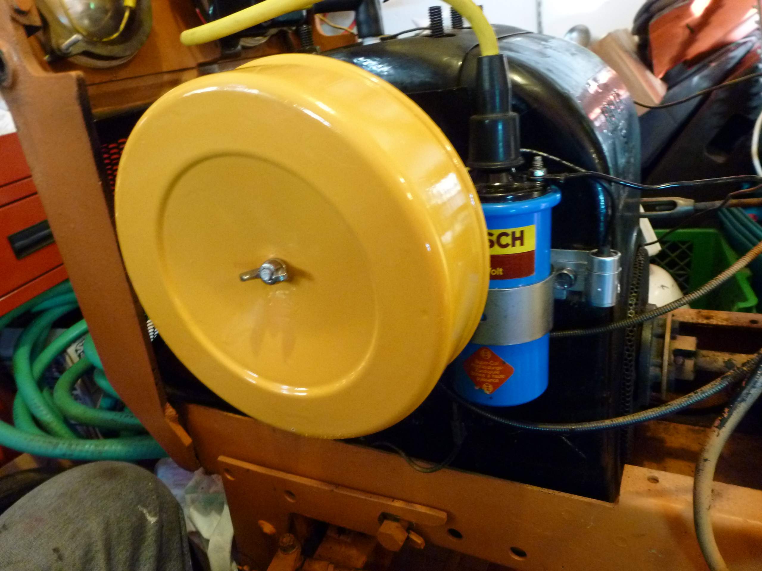

I have had great success with Valspar from TSC on a properly cleaned and primed surface, either bare metal or with prior paint. In fact, that was a reason to go to TSC....bummer. The IH Red Valspar is amazingly durable; I know sadly too well when I oversprayed it on my newly tiled workshop floor. The IH Red has held up well outdoors also.
My fallback is Rustoleum on white or black. Yes I know I could paint my 1968 Cub Cadet with modern emergency yellow paint, but I really do want the oem look. Boy am I glad I bought a bunch of that Valspar, which I am slowly using, and doing my best not to get CC yellow on the same floor. The prior owner used hardware store yellow...see the pic...at least he prepped the surface decently because it's pretty solid. I'll prime anyway.
I wonder why the parting of ways of TSC and Valspar? Just for a better margin? ??Maybe not.
