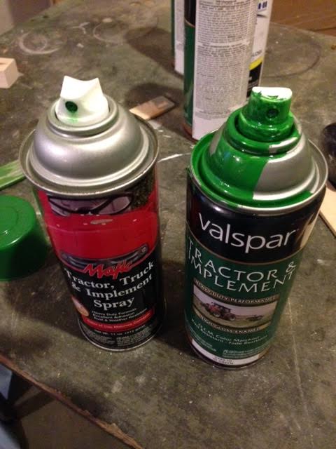

Paint.jpgI have had my problems with getting yellow to cover as well. Here is a picture of nozzle problems with the Valspar. I was just painting along today and "bam" paint everywhere in my hand. The other issue I have with Valspar is that is is not as glossy and you end up with flat unblended edges when touching up.

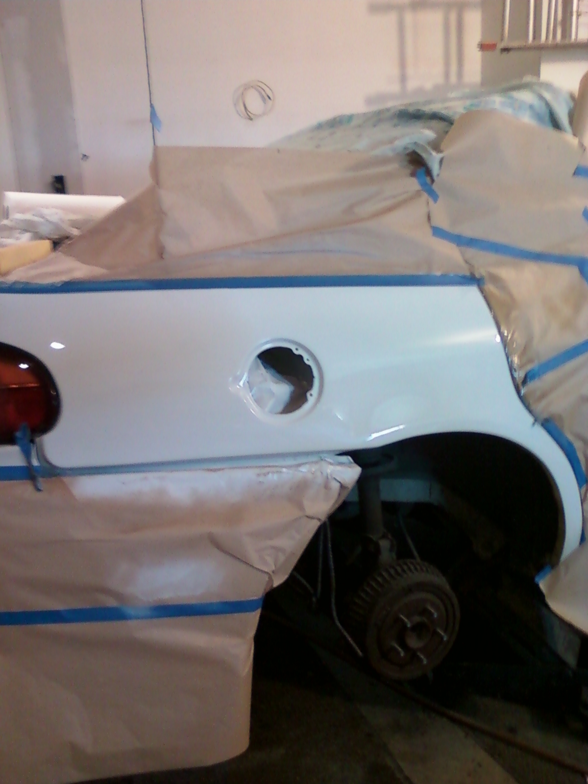

Though I have been retired for a few years now, I still get conned into doing stuff like patching a rust hole around this fuel filler.
Since I had no interest in doing this, or any additional painting, I could not justify the cost of the materials I would have had to buy to do this little job, and only use very small amounts of the products. So, I primed, painted, and clear coated this repair, entirely with spray cans.
After I buffed it a little the next day, it looked just like the rest of the car.

View attachment 346766I have had my problems with getting yellow to cover as well. Here is a picture of nozzle problems with the Valspar. I was just painting along today and "bam" paint everywhere in my hand. The other issue I have with Valspar is that is is not as glossy and you end up with flat unblended edges when touching up.
Do you think it is a nozzle problem or the paint is just too thin? Can you switch the nozzles between the cans?
