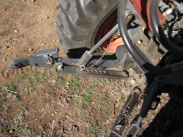

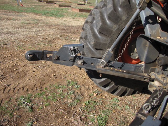

Here is the ones I made for my B7800.

I saw the Stabilworks stabilizers mentioned in some other threads - which was got me thinking about this whole thing in the first place. It made me remember some thread I saw (probably quite a while ago) - where people had retrofit the telescopic stabilizers from "higher" model Kubotas - onto some of the other models.
From the pictures he posted - it looks like LeeJohn has the telescopic lower arms on his tractor too , as well as the telescopic stabilizers.
As near as I can tell - the B2910 was the only B series tractor that came with the telescopic lower arms. The Kubota site doesn't show any of the current B's coming with them.

Jim_Wilson is asking about 2 different things:
Telescopic stabilizers - this has been thoroughly discussed.
Telescopic lower arms - (with the Heim fitting). - Does anyone know if these can be reverse engineered onto a machine that doesn't already have them? It looks like you'd have to buy the whole lower lift arm assemblies and hope they fit up to your tractor's existing 3pt hardware.
   / Upgrading 3pt hitch components on a B3200 #9
You pretty much have to buy the whole arm. Generally $150ish per side IIRC from some old threads. They came on the B2710, B2910, B2630 and B3030 from what I have read (see also http://www.tractorbynet.com/forums/...29xx-telescoping-stabilizers.html#post1733488 )
