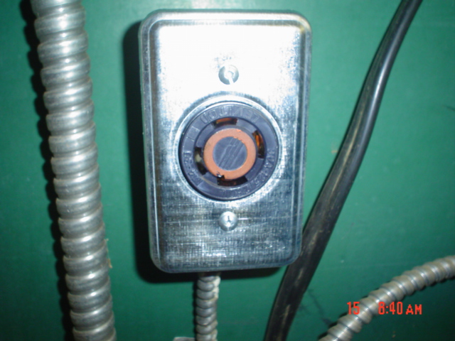

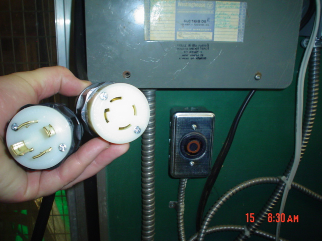

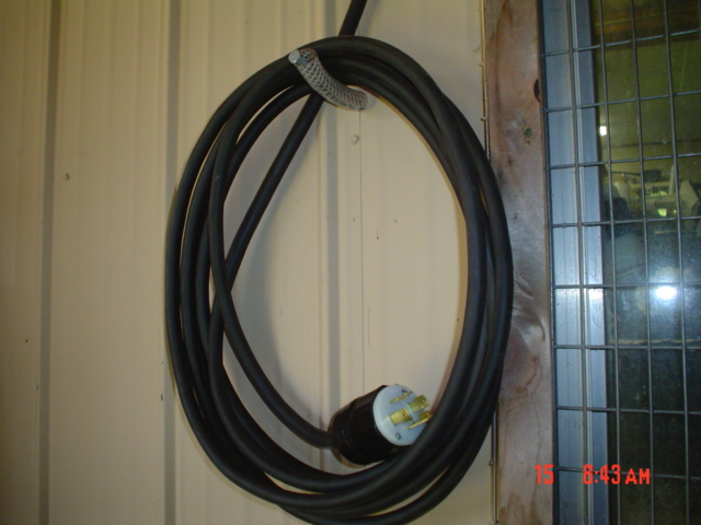

This is the plug/outlet that the electrician put in for me. Hydro goes out we just have to unplug from hydro and plug in from the generator. No chance of a back feed as only one plug can be plugged in, pretty simple. Our 5,500 watt generator will run the ½ horse submersible pump in our 2,000 gallon storage tank. Nice to have water if the power is out for 5 days. :thumbsup:
