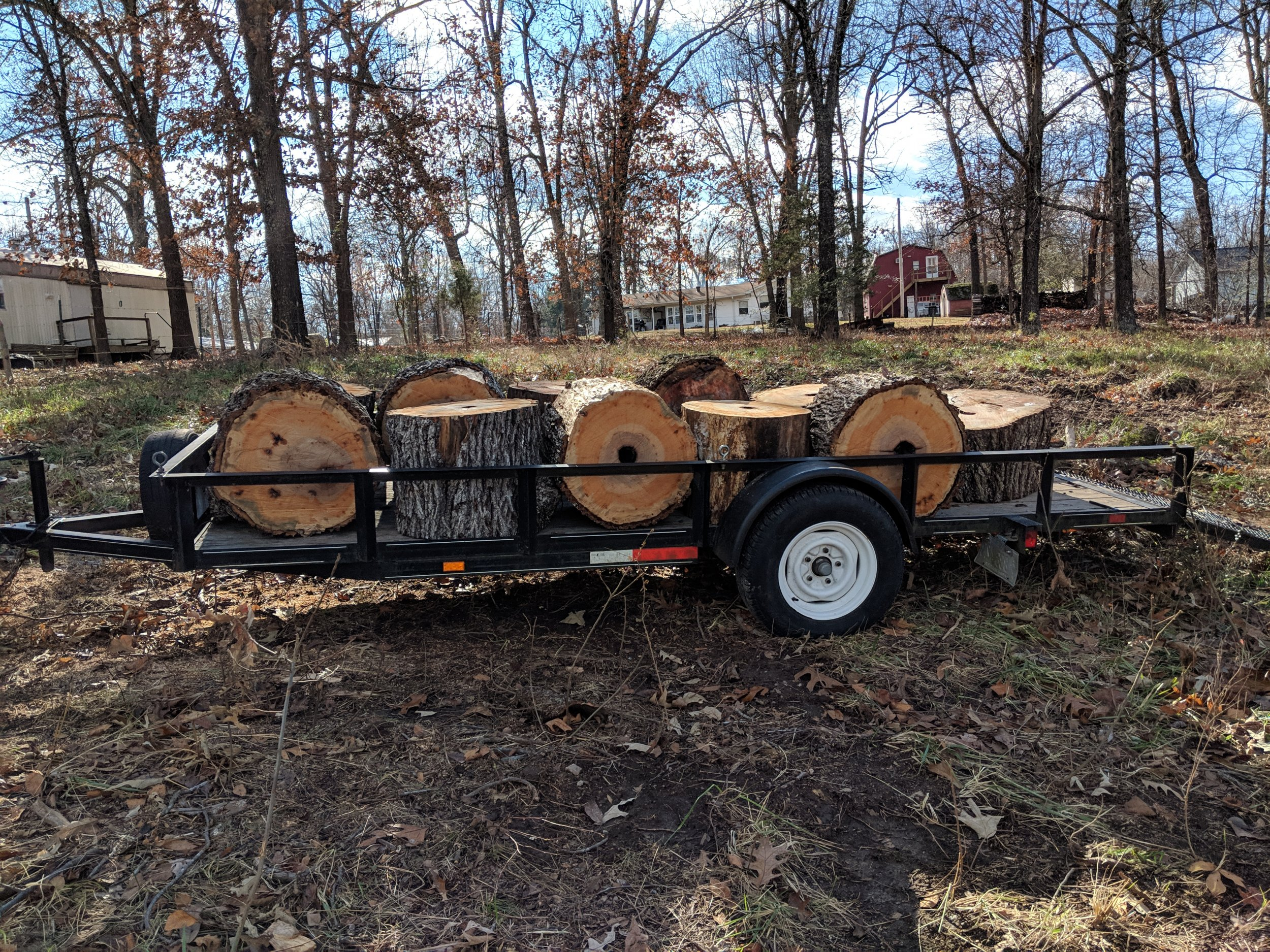

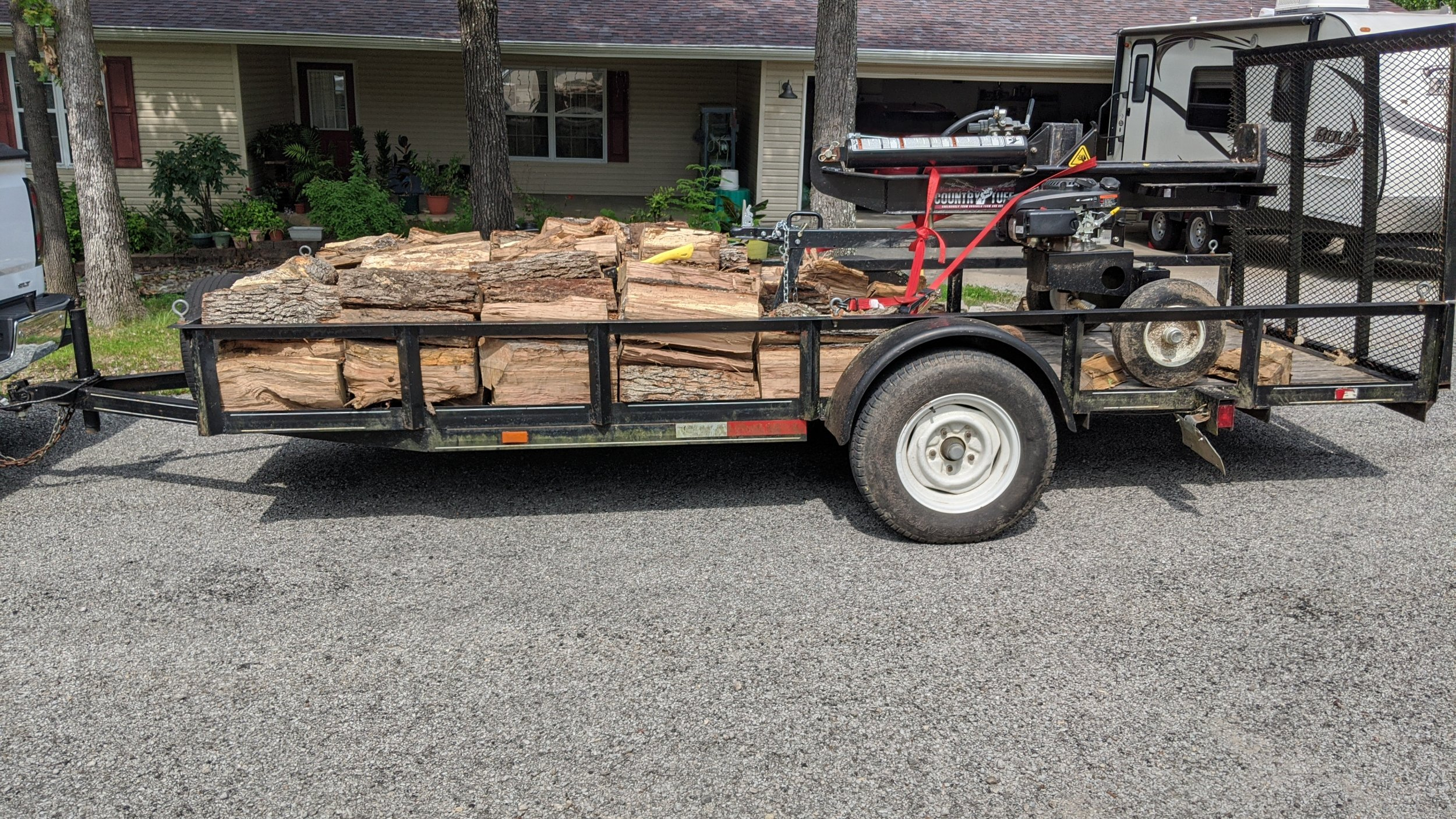

We’ve had our 18’ car hauler since 2002. Has a diamond plate deck and brakes on both axles. 7000# trailer with 5500# load capacity. It was $2500 back then. Was well worth the price. We’ve used it countless times to haul the tractor and attachments to our remote property, the Little League park, my wife’s church, friends’ and relatives’ houses, etc. We’ve also used it to pick up mulch, gravel, black dirt, firewood, furniture, mattresses, and yes, even cars! :LOL:
As I mentioned in a previous post, I made simple side walls out of 2x12s with 2x4’s that fit in the stake pockets/tie downs. They are easily removed or added as needed.
I put a pickup bed tool box on the front and keep an assortment of tie downs, chains, straps, load binders, tarps, a shovel, an axe, a machete, sledge hammer, spare lynch pins, can of spray lube, some tools, paper towels, and a bunch of other stuff as needed.
Really happy with the solid metal deck. It allows me to carry materials that can’t fall through the spaces VS a wooden plank deck, and allows me to drive the tractor right up onto the trailer and scoop items off with the bucket, toothed bucket, forks, etc., without worrying about damaging a wood floor.
