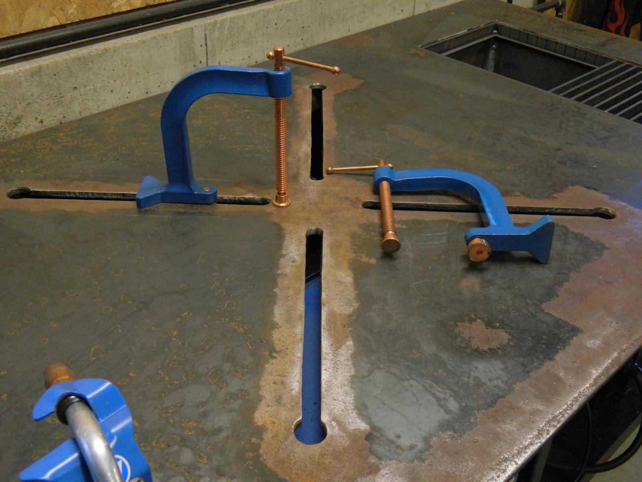

Makes me glad they don't salt the roads here.
Seems like they put the cheapest piece of steel right where it carries the most load. :confused2: I could have painted it tho..

Heres a pic of my welding table I put together a few years ago I got a good deal on the 1/2 "steel plate from my local steel supplier.It's only 3 ft wide by 6 ft long I have a small garage but it's a big improvement over the portable strong built table (folded up just to the right in pic) I had been using.
[/IMG]
   / Welding Table #83
[/IMG]
Prefect table size. How high is it? I am getting ready to start the build of another new one for myself.
   / Welding Table #84
[/IMG]
Looks a lot like mine but I dont have a lower shelf, I store the Mig and Tig under mine.
   / Welding Table #85
Gizmo2 its 32" inches high......I used 1/8 " square tubing for the legs and frame.I was a little concerned about the steel plate it was warped but luckily the heat from the welds drew it down and it sits fairly level now.I used my tractor with forks to set the steel plate on the tube frame. If I recall I think the hardest part was doing the welds on the under side of the table top.I probably should have set the steel plate on the floor and then welded it to the frame but I wasn't sure it I'd be able to flip the table back up right without damaging the concrete garage floor that suckers is heavy.:)
   / Welding Table #86
32", Looks to be higher than that. Seems low to me. My current table is 37" high but I'd rather have your table...
   / Welding Table #87
You can always chop your legs by 5 in;)
