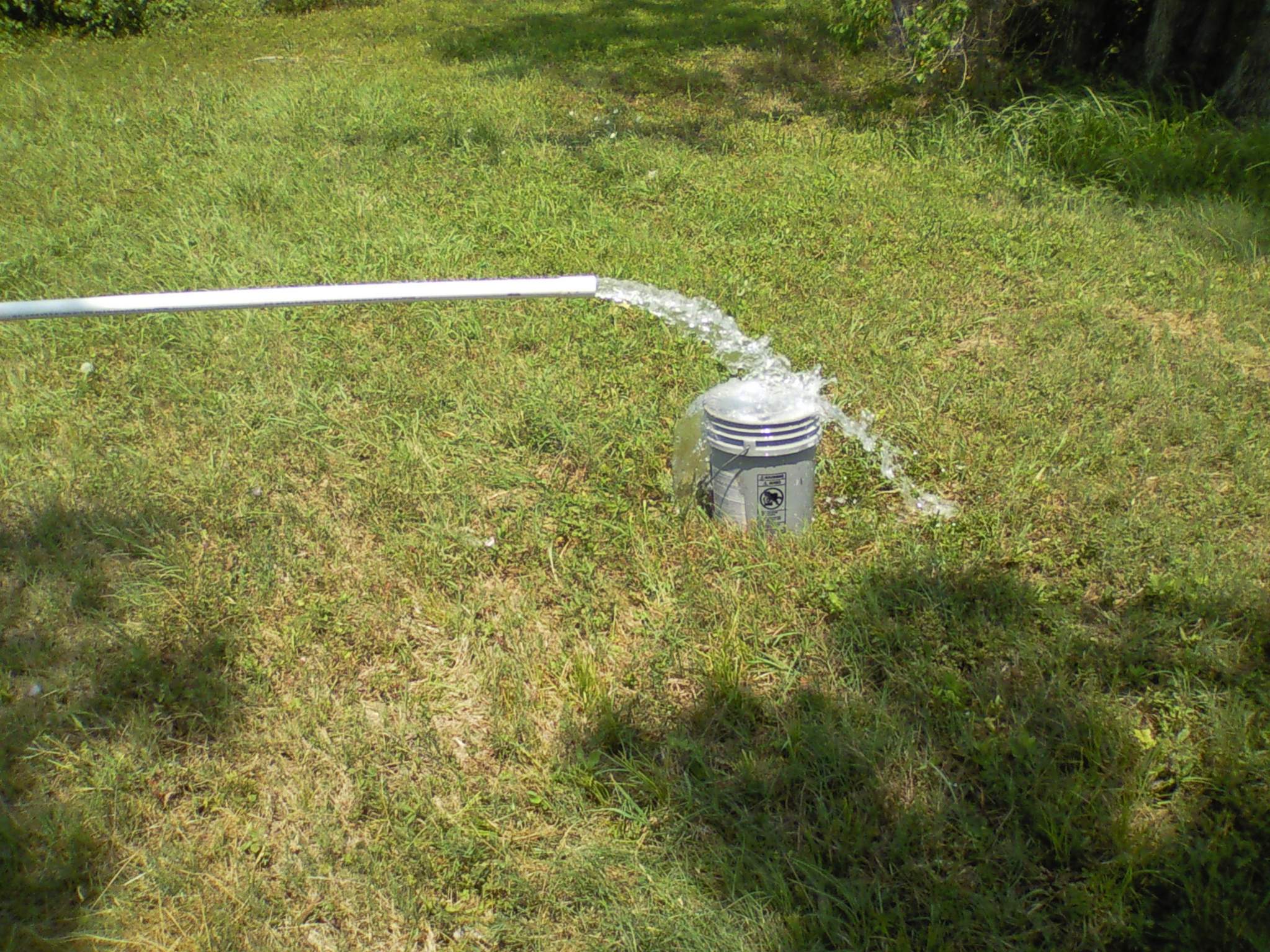

And I really don't appreciate the personal attacks. It might be 1", or it might be 1.25". Hard to tell from the pics. What difference does it make that you have to get your panties all in a wad?
Just for your information, he's only losing energy out of the top of the well, not pressure.
People like yourself is why people that "know" don't like to post much on these forums. Those who do, do. Those who don't, never will.
I may have overlooked some of the OP details, but this thread went all over the place and I lost track of what exactly it is he wanted to do, which is why I asked him to PM me.
This is how you get 50 GPM out of 1.25 pipe BTW

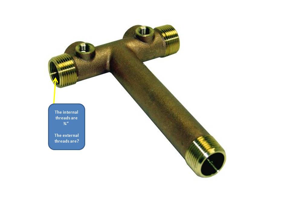

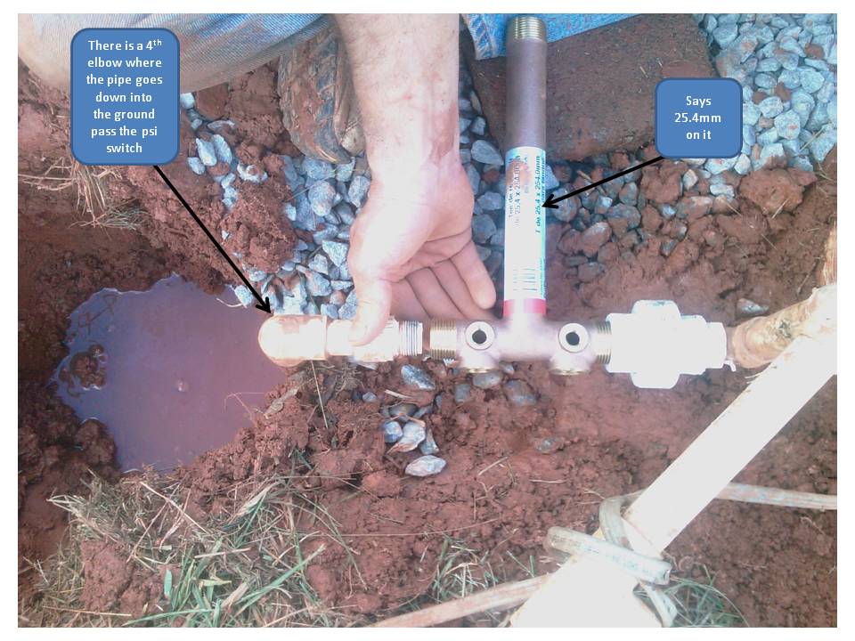

Well (not a pun :confused2:) I looked at the setup last evening.
The galvanized elbow is a reducing elbow not sure what size though. I've attached some pics with some labels on it.
The bass fitting "T" that goes to the pressure than says 25.4mm on it which converts to 1"
How hard is it to swap out the galvanized reducing elbow?
Does it hurt to tee off before the pressure switch?
Our pressure switch is set at on at 30 psi and off at 60 psi.
The sprinklers are used to irrigate pasture not lawn.
/QUOTE]
Depends on if there is a union below the cover.:)
Otherwise it may require cutting, threading and adding another union.:)
Not difficult.
May have to support the tubing if the cap comes off.
Might be a good time to reconfigure the piping.:thumbsup::thumbsup:
