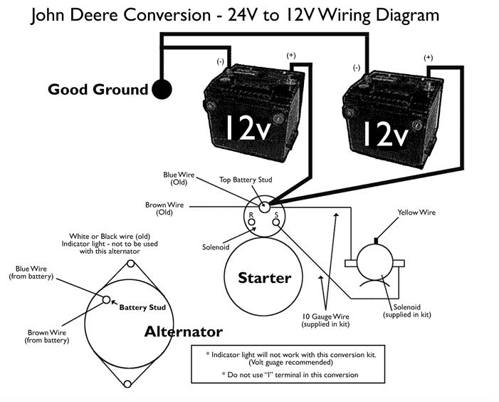

What is the best 24 volt to 12 volt conversion kit for a 1963 Deere 4010 diesel? I intend to use 1 group 31 battery. Mounted by the starter. I need a

24 volt starters converted to 12 volts don't appear to perform as well as a standard 12 volt starter.
The starter is replaced, not converted
   / What is the best 24 volt to 12 volt conversion kit for a 1963 Deere 4010 diesel? I intend to use 1 group 31 battery. Mounted by the starter. I need a #25
That's right. To convert it would require rewinding the starter with additional turns of wire so as to get the same power. Usually to rewind you drop down a size or more in wire diameter. There used to be a Vietnamese family locally who rewound generators but they no longer do. They had special winding lathes.
A standard 12 volt starter for a 4010 is what you want, if they made such a thing.
But I wonder if it is worth the trouble. Why not just leave it 24 volt? They really do start easier on 24 volts. And I imagine if you are going to 12 volts you will fill that battery space with a matching battery to run in parallel anyway. So the batteries are no different, only hooked up differently.

Do some research on the subject and you will find why I am doing the swap.
The long skinny batteries don't seem to last. The generator sucks for lights.
I have a group 31 battery here.
I have a cab, the oem battery boxes aren't even there anymore.
The battery will be mounted by the starter.
The battery box has been there with the 2 long batteries for long enough to rot out and require replacement anyway.
I converted the last 4010 I had and liked it that way.
Do you have a conversion kit to recommend? One that comes with the alternator and mount ready to go?
I've heard of a lot of conversion kits requiring messing with the alternator or mount. If I'm paying for a kit, I just want to install it not change pulleys or mounting brackets
Thanks

JD 24 volt to 12 volt conversion kit
OR
Thanks. What is the difference between the 2 kits. I don't need any battery cables if that makes a difference.
Have you used these?
I saw these in my searches. But didn't see any reviews.
I have read a few places that some kits need the alternator. Pulley and / or the alternator mount bracket revamped.
Any issues like that with these kits?
I hate jacking around and having to return things. I am not going to pay for a bolt on kit and then have to revamp stuff.
I know any battery cables will have to be revamped since I will be using only 1 battery out of the International 4700.

I know many running 1 group 31 on -, mostly 4020's and it is working fine.
I would rather put the battery money towards a conversion than spend more on batteries that I have not got any longevity out of.
I just had to replace the battery in my 1975 Ford Backhoe last year after that battery lasting so long, that we couldn't remember when it was installed.
I and others I know haven't been getting 2 years out of the long skinny batteries.
If I can get by with 1 group 31 as others are, I will be money ahead at battery change time.

You asked about conversion kits. No I didn't research them. If it was my tractor I wouldn't order a kit but just get 12 volt starter & alternator then perform simple modifications on wiring harness. I never liked the location or life span of the long/narrow batteries on JD 10 & 20 series rowcrop tractors
