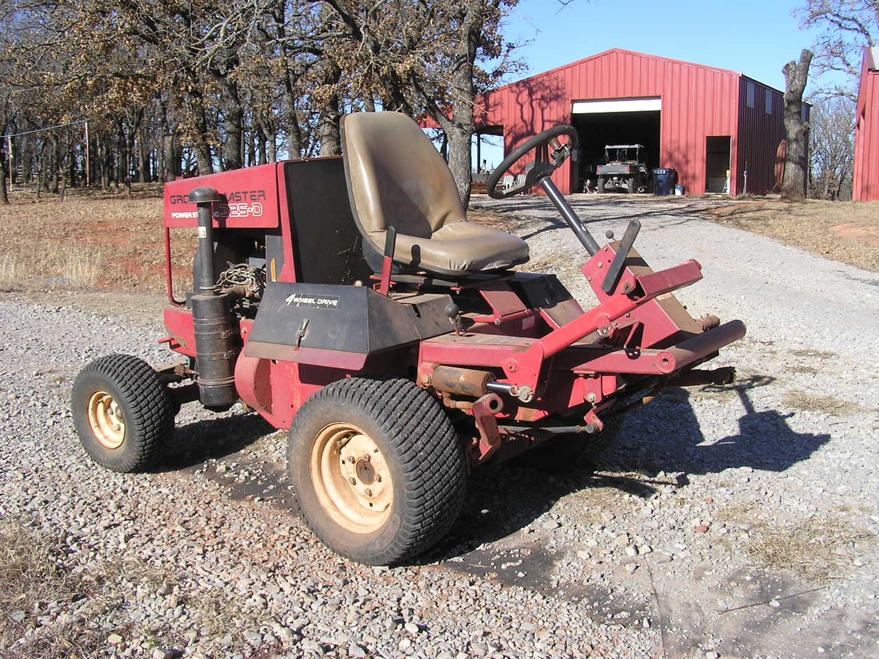

local ad
seller says it is a 2021 Kabota (sic) diesel 4x4 ride on mower
photo says RANSOMES ... or something like that
I have NO IDEA of Brand, Model, HP, year etc ... the ad, description, year, price, colour, and seller's reputation are all SKETCHY
curious if anybody knows anything about it ... looks interesting, but not at all as described - I called him a scammer, his response was "what do you mean?"
oops, forgot the photo -
Skip it. Reel mowers are commonly used on Golf courses. Lots of maintenance required.
   / What is this machine ???... #44
local ad
If "sketchy" move on to something else. Some people say it's a Kubota because the engine may say Kubota on it and ignore the rest.
It does amaze me that people can type "Kabota" in their ads when a Machine has KUBOTA decals all over it.

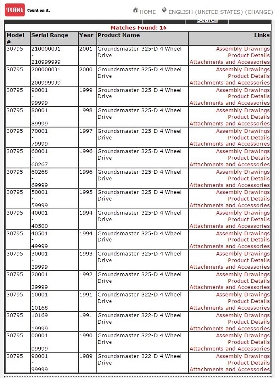

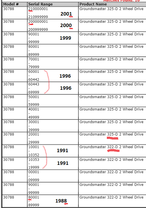

Was that model/style 322D made after 1991???
willy
   / What is this machine ???... #46
willy
Yes, but with a 25 hp. diesel engine.
Here are the serial number charts:

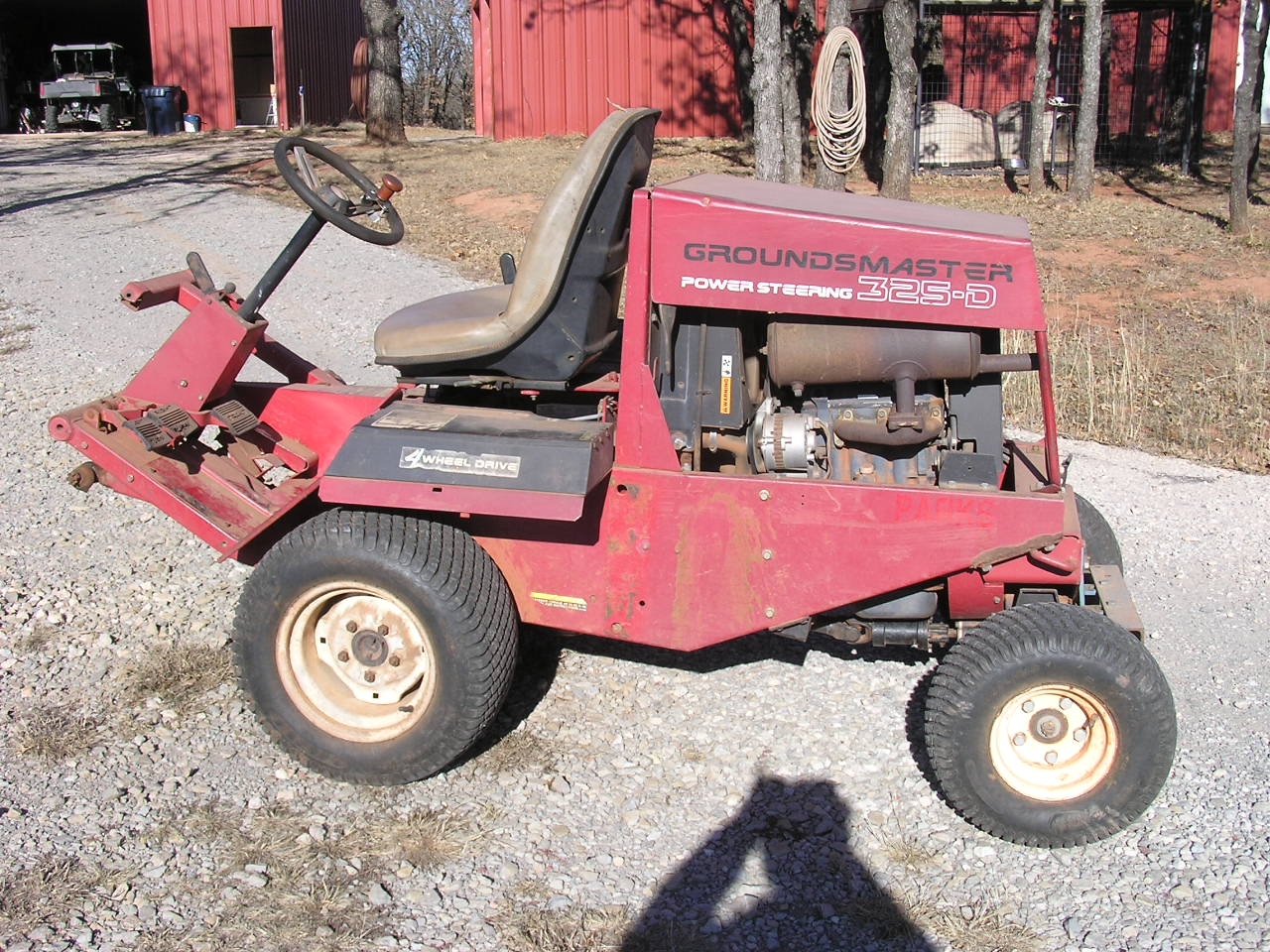

My 1996 325D. Pictures from 2015:
