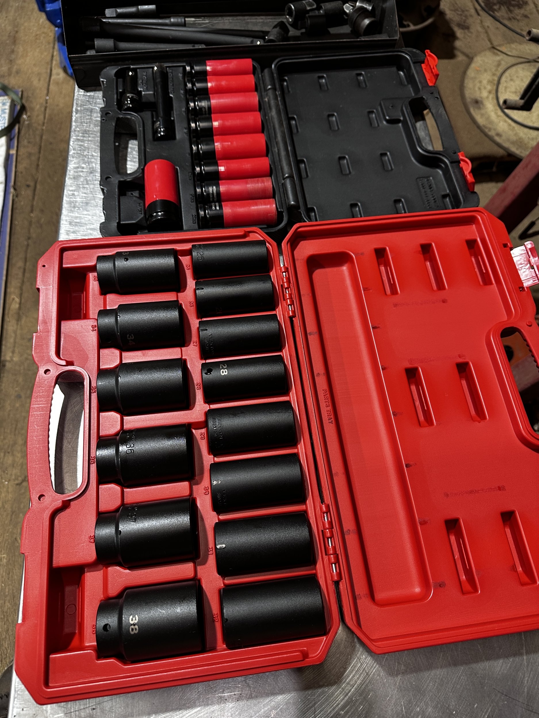

Try Grey Pneumatics for your impact sockets, AKA/ GP. I have a set of the below sockets for my aftermarket wheels. We also purchased GP tools for the shop. Good quality and reasonable priced.
1511TP
