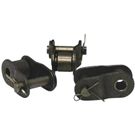

just curious what are these half links everyone is refering to. my understanding is that the distance between each rivet has to be the same all around the chain so I'm having trouble wrapping my head around the idea of a half link. it would jam on the sprocket if it was half the length.
   / When do you replace the chain on a 3-PT. snowblower? #19
It is a link with a male and a female end;
   / When do you replace the chain on a 3-PT. snowblower? #20
It's not actually half the size:
