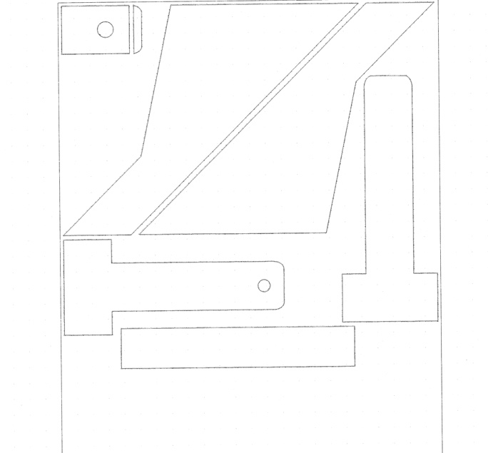

ok....i spent about an hour redesigning what i want to make. ran it thru the cad program, ran that thru the vextractor program, then ran that thru a program called Enroute to set the cut parameters and do the nesting to save on materials as much as practical. Im cutting the parts out of a 24" x 48" piece of 1/4" plate stock i have laying around. a bit rusty but will clean up ok.
ill cut the 1/4" plate material tomorrow...if time permits and weld it all together. The amazing thing about cnc plasma cutting is i can cut these parts out in a few minutes, and pick up the pieces almost immediately after by my bare hands.....not sure how that works, but the metal doesn't get very hot. 30 seconds cooling time is all it usually needs for 1/8" stock, about 45-60 sec for 1/4" plate.
heres a lame picture of the nested art work. the program doesn't have a good way to send a copy to my printer. i have to do it a round-about way and convert that to a JPG to post. Ill take a few pics while cutting and after cut.

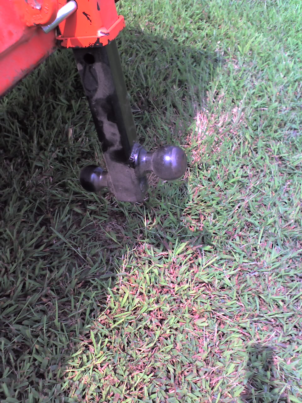

Yup, that's all I've had to do for the last 15 years or so with several different tractors with different buckets. You'd have to have a really short insert, a really odd bucket, or a tractor with very poor forward roll for it to not work. Attached is a pic of a double ball insert (2" and 2 5/16") that will easily jam into the ground. Even if you had a bumper pull (which would be a 2" ball 99% of the time), as you can see, I could pick it up off the ground. Pictured it is on a Kubota 5030 and I easily move my pintle hitch trailer, dual tandem 20k GN trailer (trailer weighs over 7k) and a 7k bumper pull car trailer. Simply put, it ain't that complicated. :)

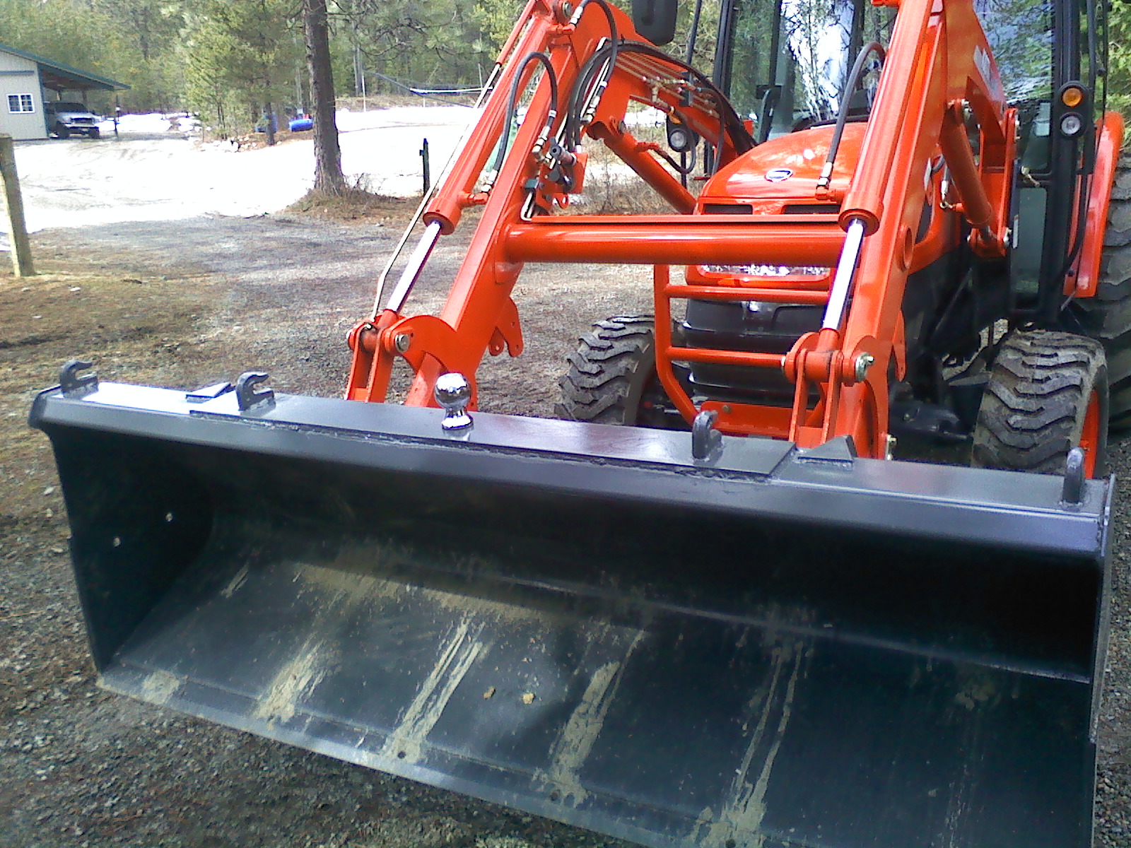

I replaced my middle bucket hook today with 2 separate hooks in line with the bucket arms.
After reading multiple post here, i decided maybe i best relocate my hooks.
I was adding a 3/8 upper plate and a 3/8 lower plate (inside bucket) to support a 2-5/16" trailer ball so i can move my wifes new horse trailer.
since i was having to add the steel plate anyways, why not make the plate larger and add the 2 bucket hooks. The plate stock was cut from my scrap pile. It took me 6 different stops to locate weldable bucket hooks....no one had them and i picked a real lousy day to forget my cell phone.
i left the outer 2 hooks but those are only used to prevent items from swinging.
