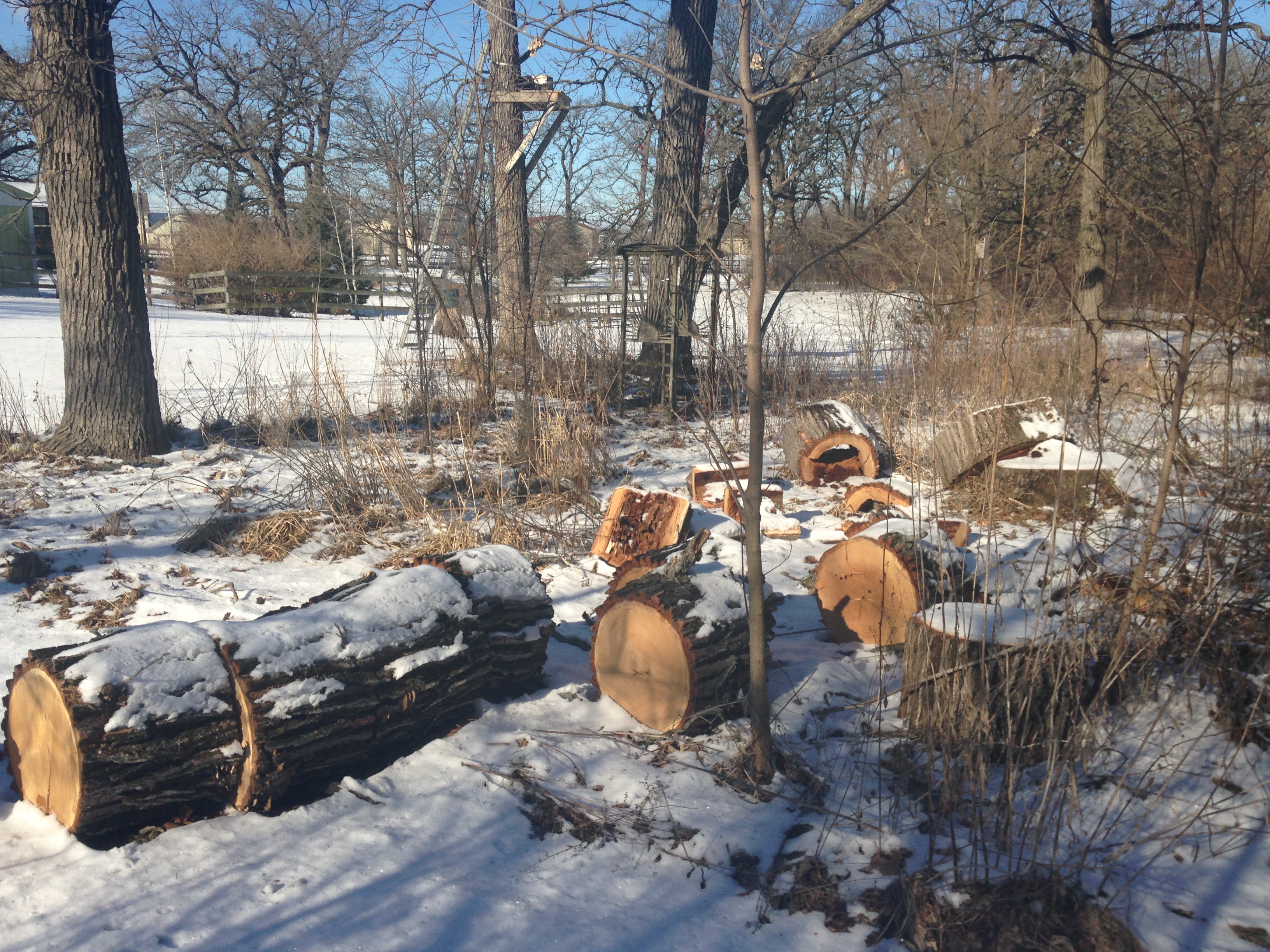

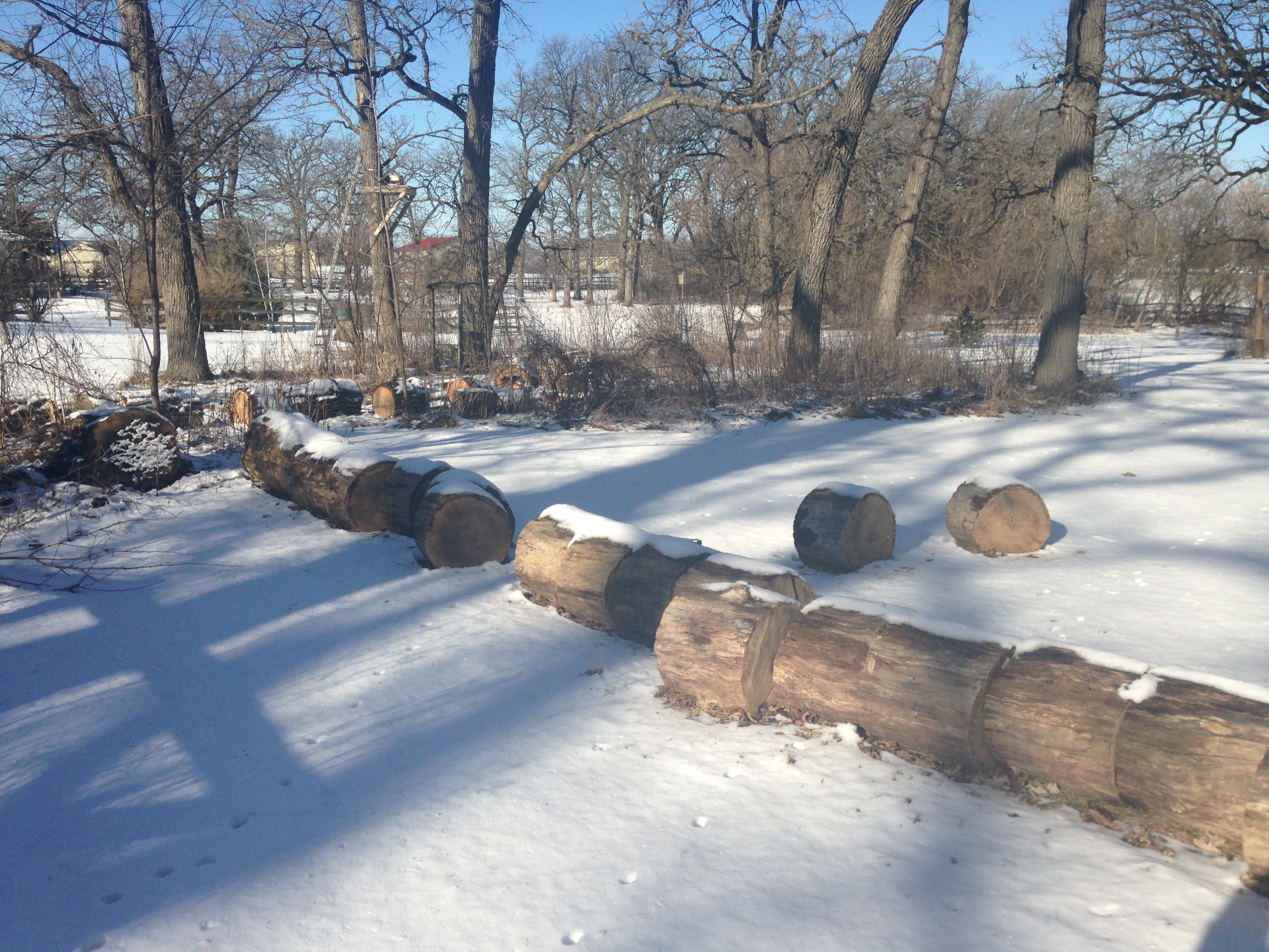

The main duties will be manipulating oak cuts as pictured below and servicing my wife's penchant for placing large rocks around the yard.

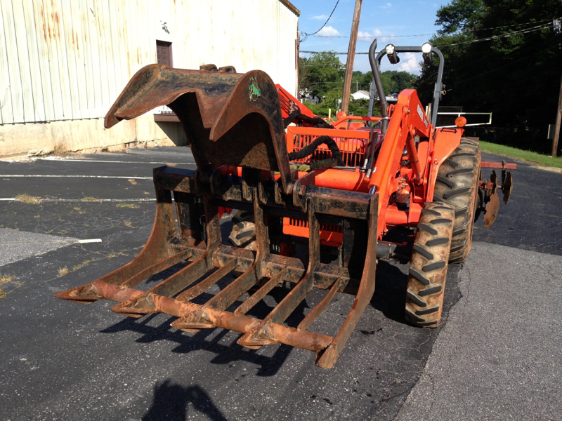

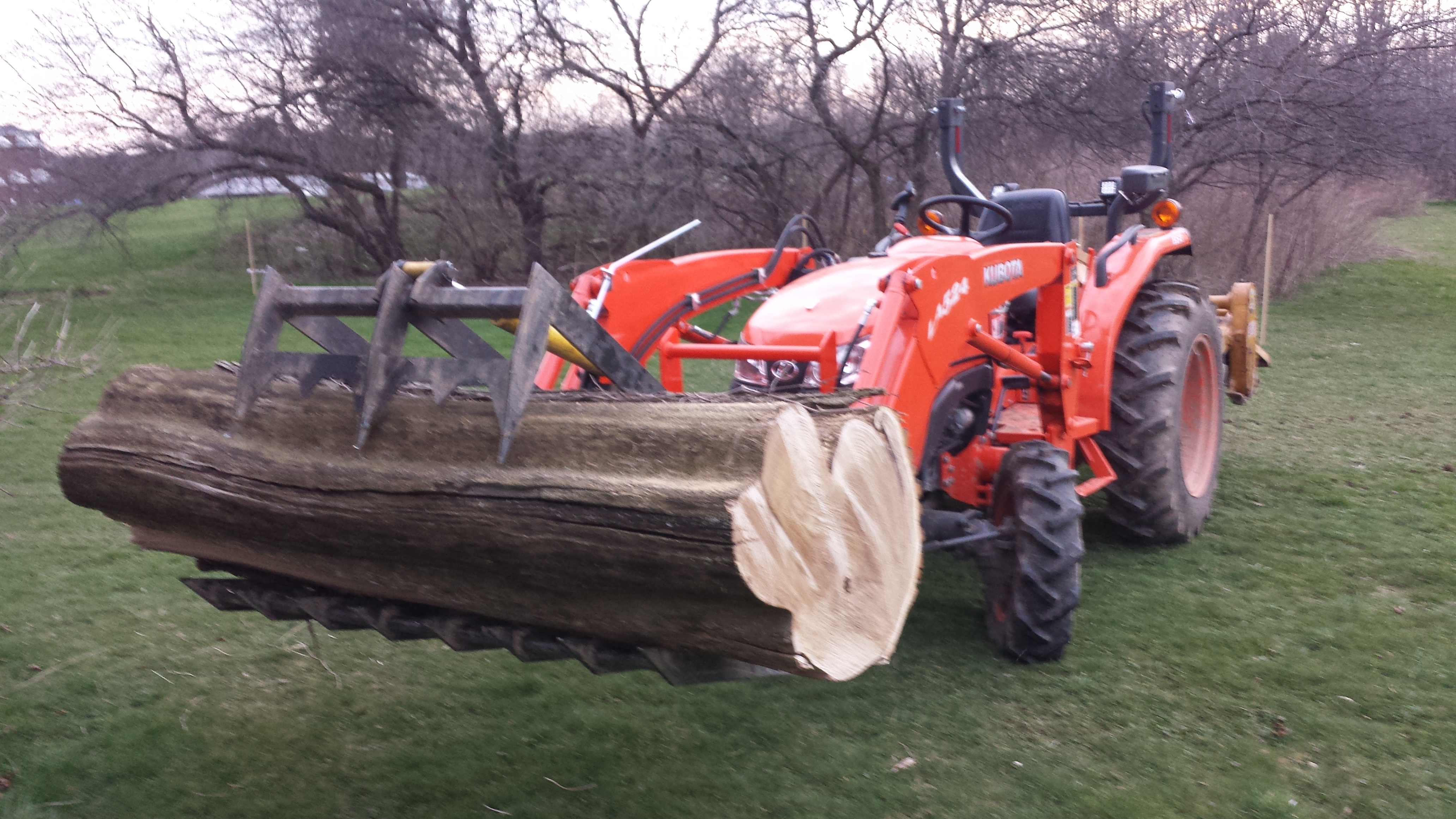

I built an L type 50" wide grapple for my L3200 and it handles logs really well. Stays on my tractor 90% of the time.
/ Yet another B2601 Grapple question... #4
I have the EA 50". I use it mostly for carrying brush/tree limbs. As far as crunching power, it will hold anything your tractor can lift. The EA forks lock/mate top and bottom. This is sometimes good and sometimes bad. It's bad when you want to grip something that is smaller than the internal volume of the grapple.
