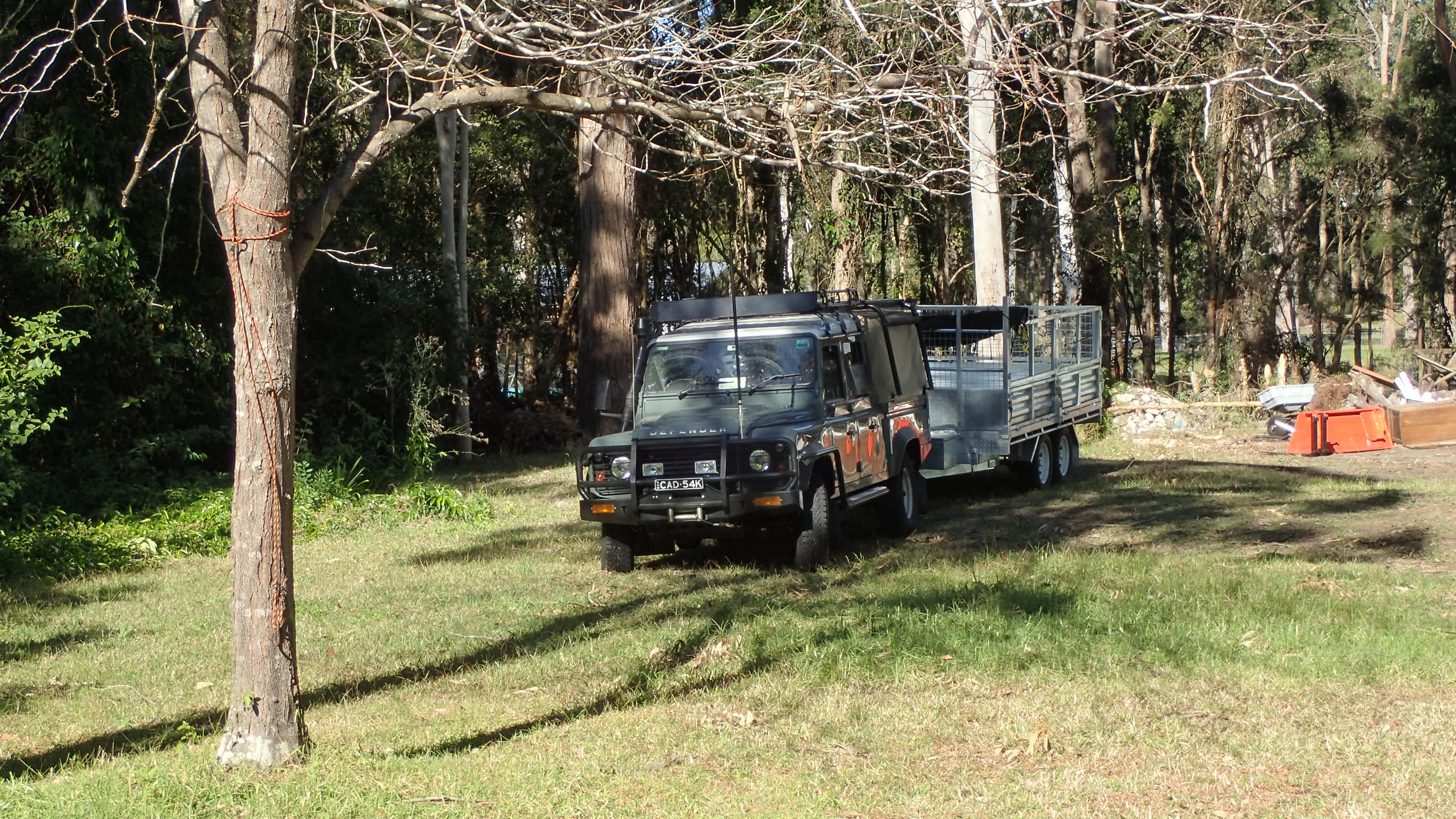

   / Your towing rigs and trailers #3,321
Here is me on the weekend, outback Australia style!

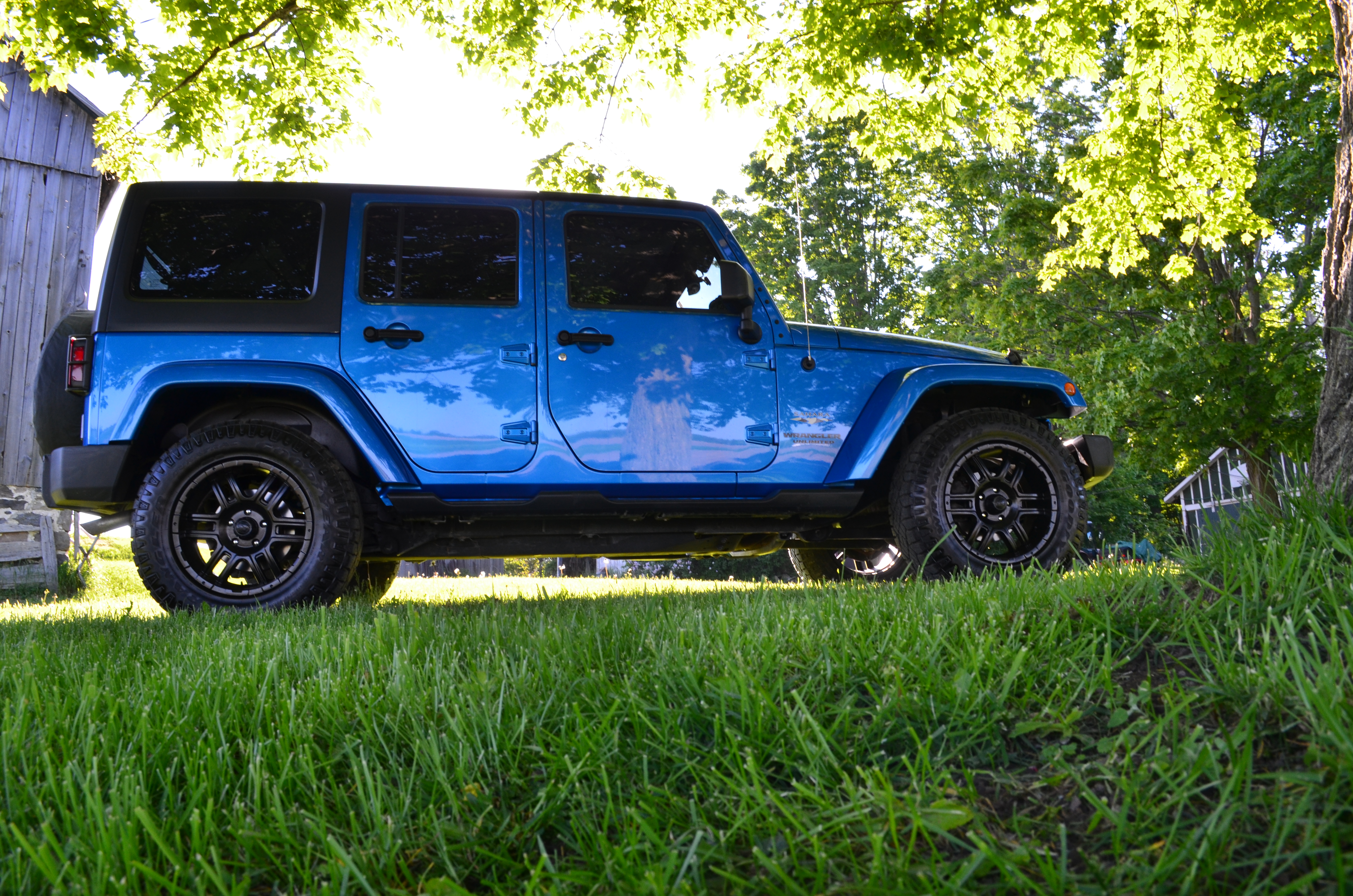

   / Your towing rigs and trailers #3,323
No trailer yet, will get one eventually.
