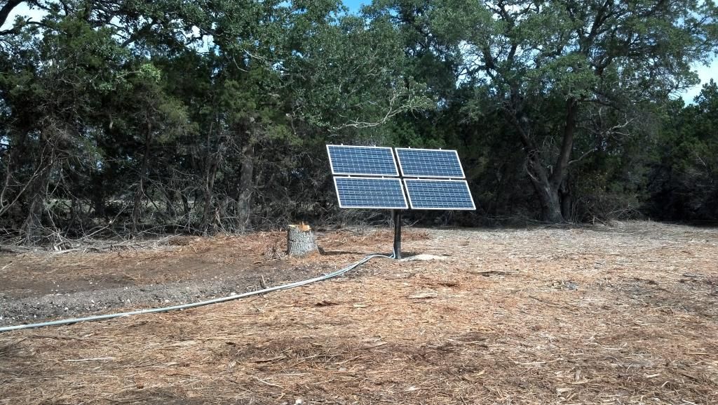

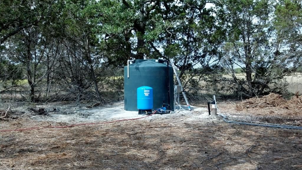

A non pressure tank? So another pump is required to provide pressurized water ?
That would be 1.75 gallons per minute? there are times when my pump with 12gpm at 60psi is not enough here.

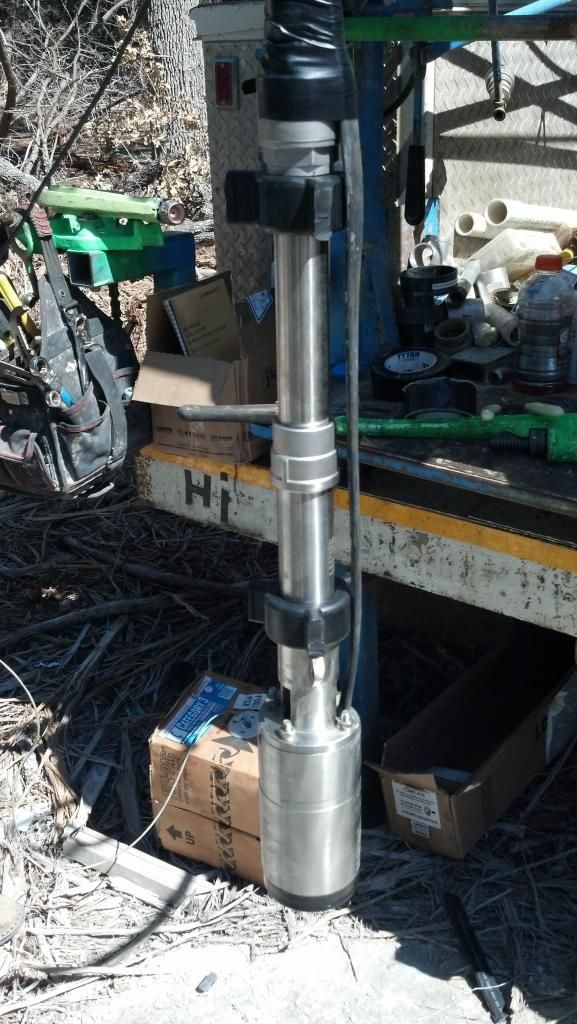

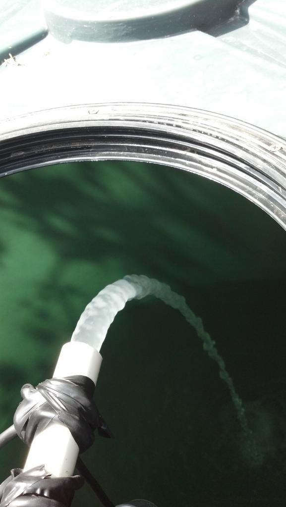

Correct, we use a holding tank with a separate pump to pressurize the system. At best the solar panels only gets about 6 hours of good light so about 5-6 gpm from 400', with actual head about 380' or so. I had my doubts that a solar powered pump would be able to do the job and I am happy to say it can.
This little Lorentz pump...
Produces this at 400'...
Holding tank and pressure tank.
Solar Panels
It is a pretty nice little setup, even without grid power we have water and the system can be pressurized via generator. Future plan is another solar pump with batteries for pressure. We have kept garden watered, grass watered and orchard watered and the tank always remains full.
