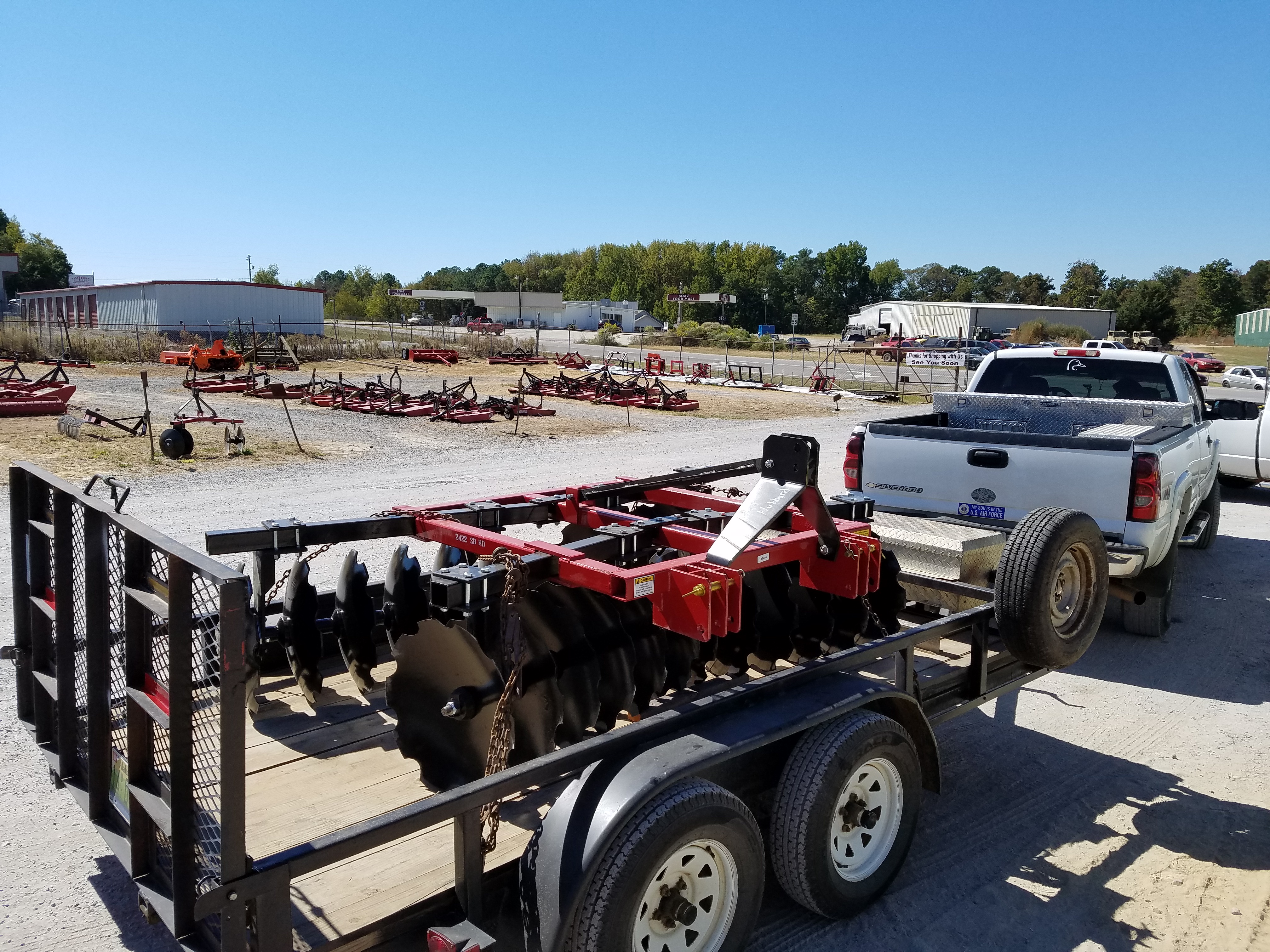

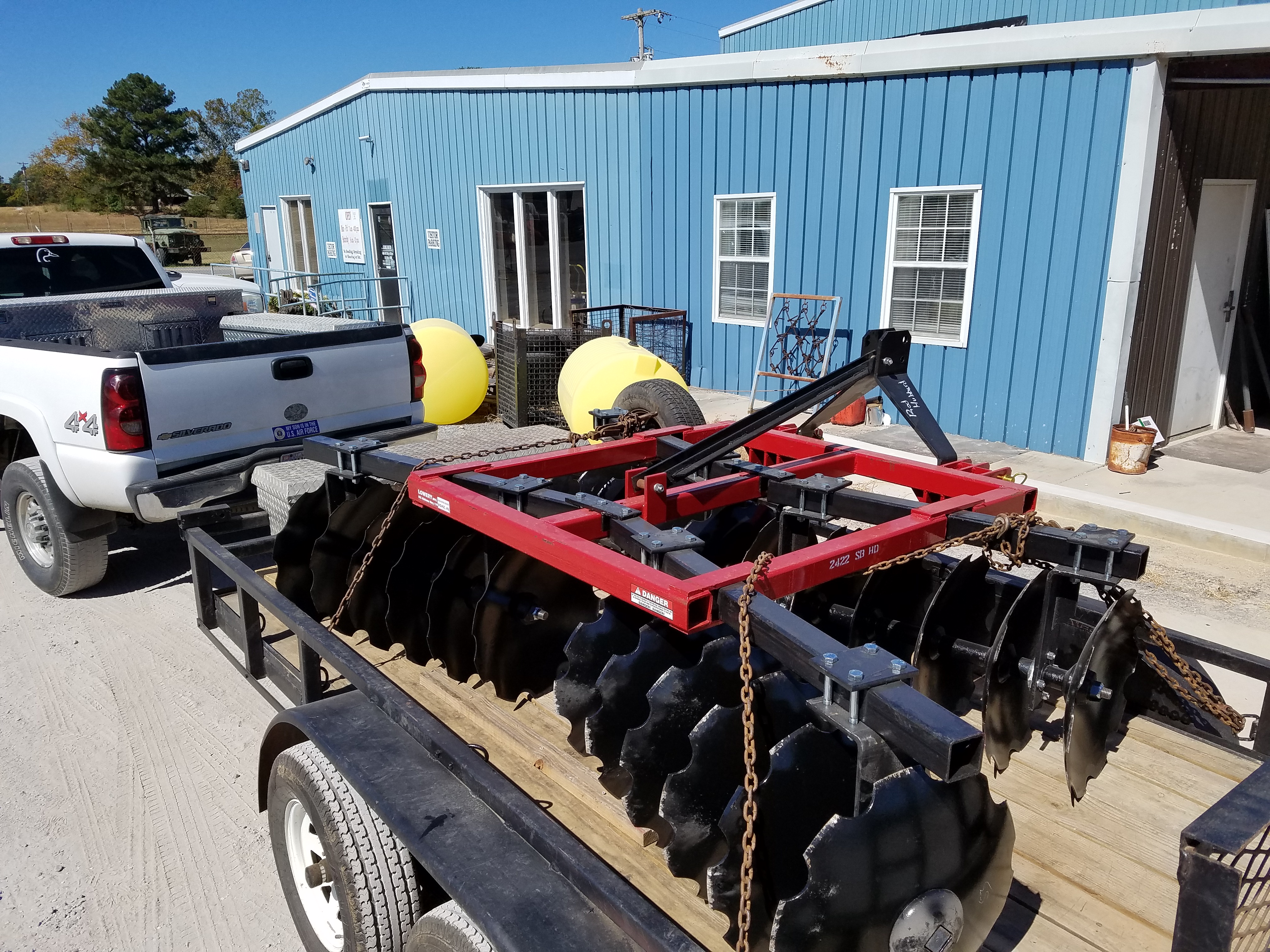

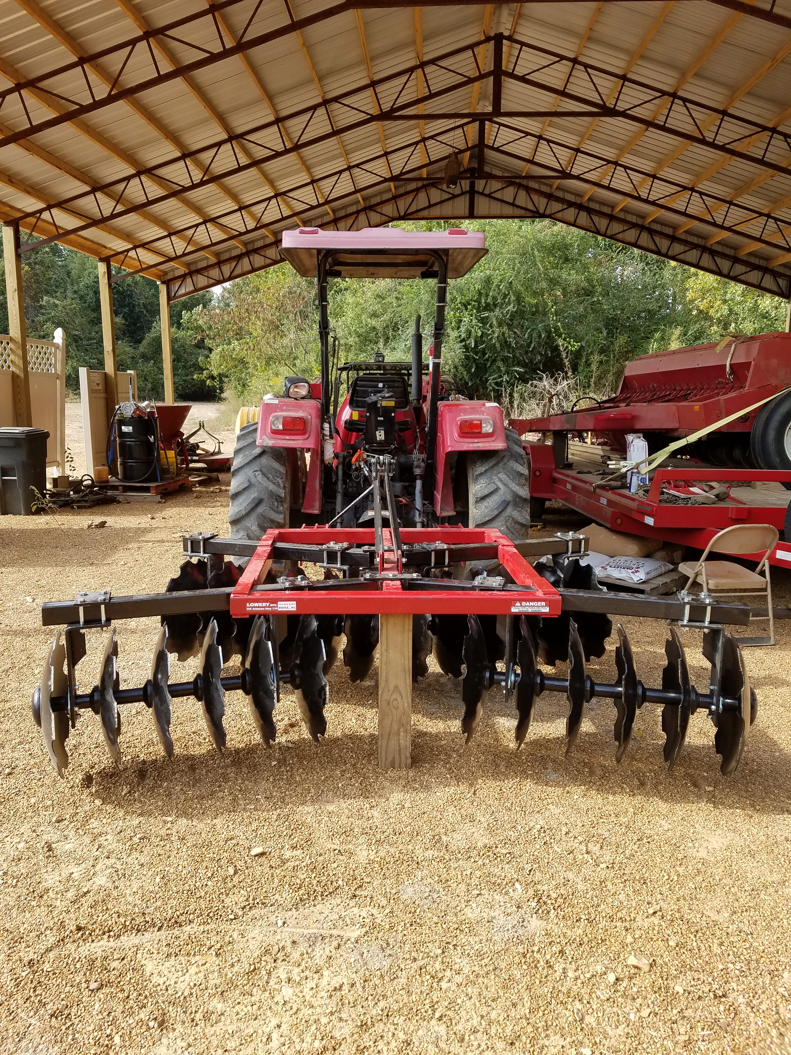

I have a 3Pt LMC 2422 HD Disc that cuts almost 9'. All my MFWD 5500 (55HP) wants in good ground.
If I could have a do-over, choice would be 2420 (24 Blade-20" Diameter). The big blades have a deep concave and will not cut as deep in new or hard ground.
View attachment 502573View attachment 502574View attachment 502575
If a disc designed like this ever needed extra weight, there is a easy and inexpensive way to add it. Put the disc on its side and pour ready mix concrete into the square tubing. In addition, this method does not change the physical appearance of the disc. Ken Sweet
