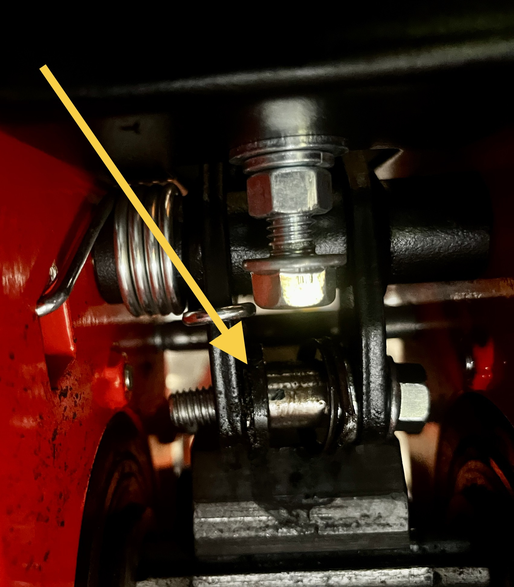

We have a DR Power K55 Kinetic purchased in 2014. Wanted to buy a SuperSplit but they never answered my phone calls despite being local. DR was closing their factory store in NH and I arrived on their last open weekend. It was pouring rain and they had a floor model at a crazy great price so into the van it went.
Engine is a Chonda and to my astonishment started first pull after sitting in the shed for 9 months. We use no-Ethanol fuel.
Recently the bearing that holds the rack gear down on the pinion broke. Purchased a replacement from McMaster for $36. Also discovered I was supposed to be greasing the engagement arm bearing and pinion every 10 hours of use. Oops.

Looking at the parts diagram, the SuperSplit has two bearings with a support in the center. The DR has one full-width bearing.
There are quite a few other differences: two return springs, safety interlock handles, etc.
All industry-standard stuff, any industrial supply or bearing supply shop should have them.
