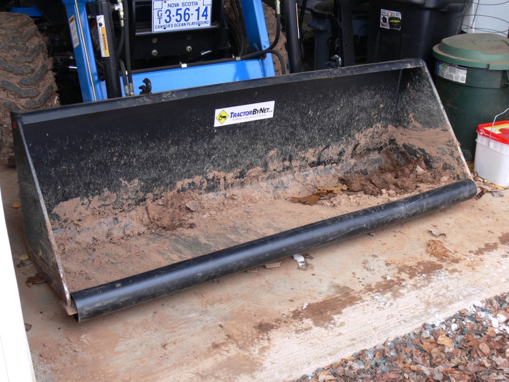

A number of threads here have traced the trials, successes and foibles of using a piece of PVC on a snow blade. Run it through the table saw, and bang it on. It sure works great over gravel, but easily shattered in cold weather.
Here's why:Quality Control
Some here have suggested ABS plastic as a much better alternative. Here's my photo, clicked on the run, of my newly installed ABS pipe.
What a difference!! It's 15 degrees colder today, mid-teens, and yet, no breaking. Very pleased.
(Although the paint is sure peeling on that blade!)
No doubt HDPE would be even better, but I just couldn't find any in town this morning.

So help me out...........the purpose?:confused: Is it better than the steel edge on a gravel driveway? If so what diameter ABS pipe did you use?
/ ABS Plastic Pipe Snow Blade Edge
Purpose- To skid, to prevent moving gravel, especially early in the year before the ground is frozen or in spring during thaws. And no, shoes are not the answer as they too gouge big time. The pipe is slick!! Many guys slit a steel pipe, but plastic is quick and easy.
Diameter. Some use 3". I prefer 1 1/2 inch. Although this particular piece of ABS I was lucky to get at all, and it is 2".

Just applied mine yesterday. Have to remember not to backdrag! ;). I used 3"

Gotta tell ya. The price of ABS is no more than PVC.
Once I had used up my scrap PVC, that was it. I went through 3 yesterday. Enough. I sure as heck wasn't going to buy any just to break it. Read that link above about properties of PVC versus ABS. It is a short read, but very insightful.
Just plowed 3 hours with that ABS and it doesn't have a mark on it. Go to admit, I am impressed.

Thanks BP -- like I said in the other thread, ABS is all I have used , just from being frugal and it's availability -- nice to see it is working out for you. I have used the 1 1/2" up to 3" and settled on 2" in the end.

I sure wanna thank you for putting me on to ABS. It is incredible stuff.
As for availability, it supposed to be available at some/most Lowes. I got the only stick in town, but "town" here means hokey little mom & pop hardware store. They said, "We got that piece by mistake. You can have it for $4.00"
It was 10' long!! Woo Hoot!! That is precisely two times my 5' blade.
Thus, my single ABS pipe edge was $2. usd. Come on, how good is that?

does this also help with the blade digging in and tripping the springs? we got a whopper here in WI. some drifts were 4-5' tall. my biggest problem with my tractor mounted plow on a gravel driveway was that the plow would dig in and trip the springs. it was annoying and slowed me down. i have shoes/skids on and they didn't seem to be the problem.

I'm curious if it would clear a concrete drive or make a mess.
Should work just fine unless the snow is really packed or icy --- it should stop the plow from tripping as often if it is tripping because it is catching -- if it trips from weight you need more spring or more angle --JMHO
