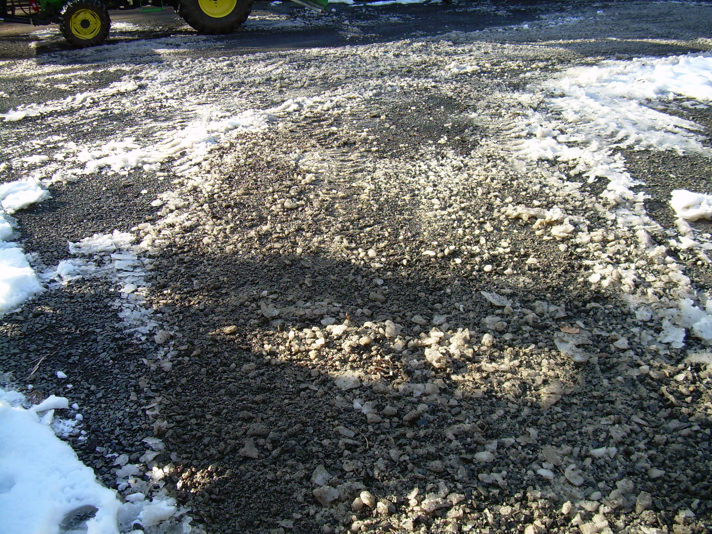

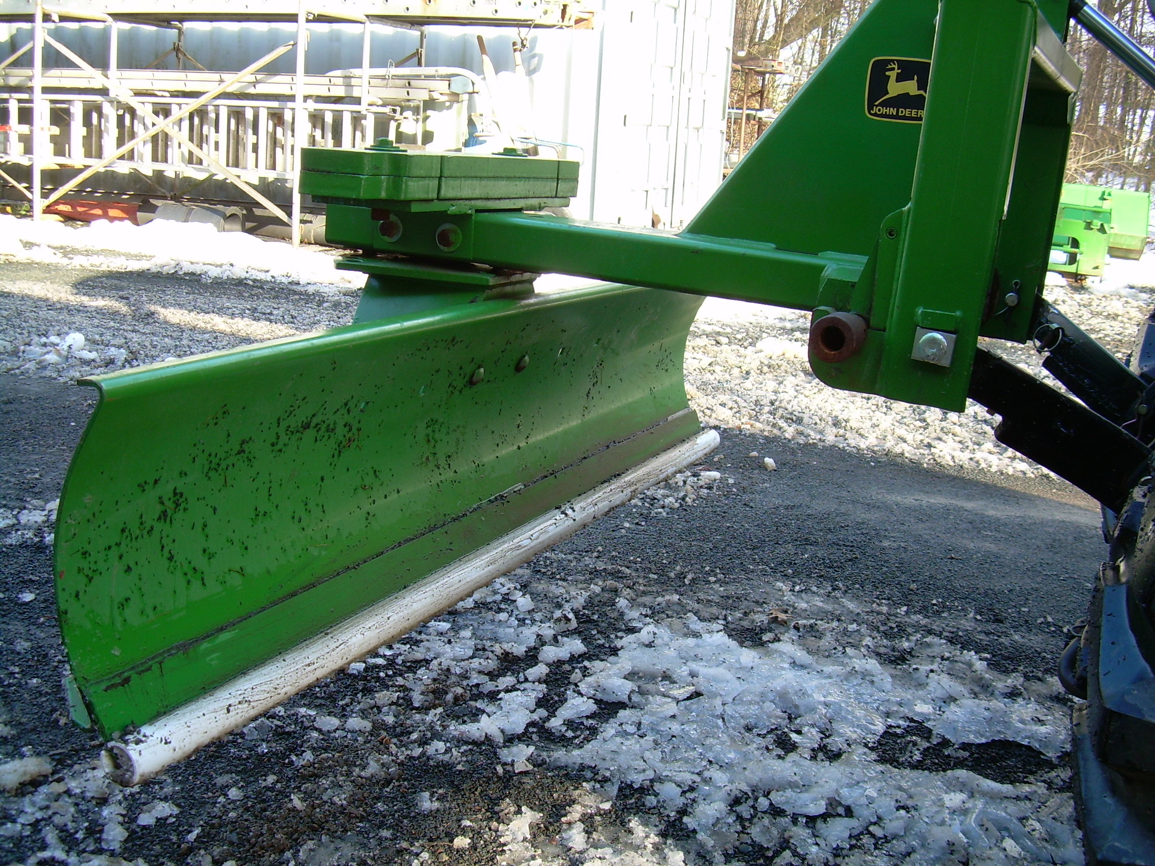

After seeing all these blades with pipe installed, at first I thought it was kinda silly but out of desperation I tried it myself. I used 1.5" with a single blade kerf, slid it on length wise from one end. Put it on my 60" rear blade to help with our first wet snowfall on unfrozen gravel yard areas.
Wasn't blown away by it as my first attempt with weighted blade dropped in full float caused considerable digging in not as bad as with no pipe, and this ground was uncharacteristically soft.
I could lower it a little lighter where it would still scrape but not dig in, I only made a few passes so the jury's still out on my opinion.
Ended up having to go over everything with 6ft rake cause it was so messed up, mixed all the stone and slush evenly, good thing cause now it's frozen solid.

Try the 3" next time the ground is soft. You should find that it doesn't dig in as bad. The larger diameter will tend to slide ove the ground better without digging in.

A PVC Backblade Installation Report: A quick update on the durability of my 1-1/2" PVC experience. We had about 15" of new snow on unfrozen gravel and grassy parking areas. At about 0 deg. F, I had good clearing performance with my 72" KK backplade and also the similarly shod FEL bucket; no torn surfaces and no splits, no dings and no breaks in the PVC pipe. That's not to say the problems experienced by a Michigan member won't hit me here in northern NY, but after 4 hours of plowing, so far, so good. Have some tough plastic well pipe in reserve when and if the PVC tanks.:)
