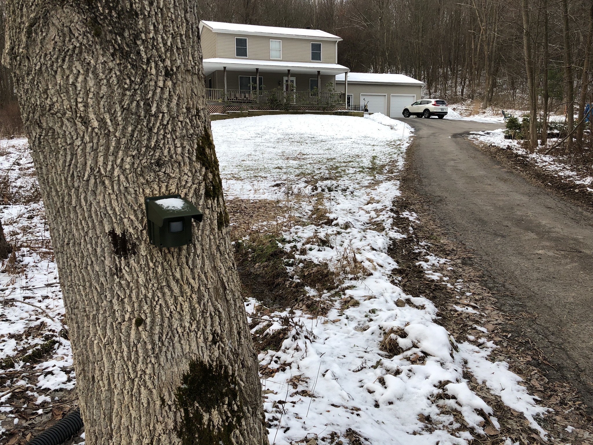

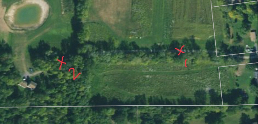

I would try different receiver locations also. Mine sits right on the window sill. I know nothing about the 500 model but wholeheartedly recommend the 1/4 mile unit. A straight line from mine to the house is pretty much solid trees. I marked on the map the location of my sensors. I also posted a picture of the one closest to the house.

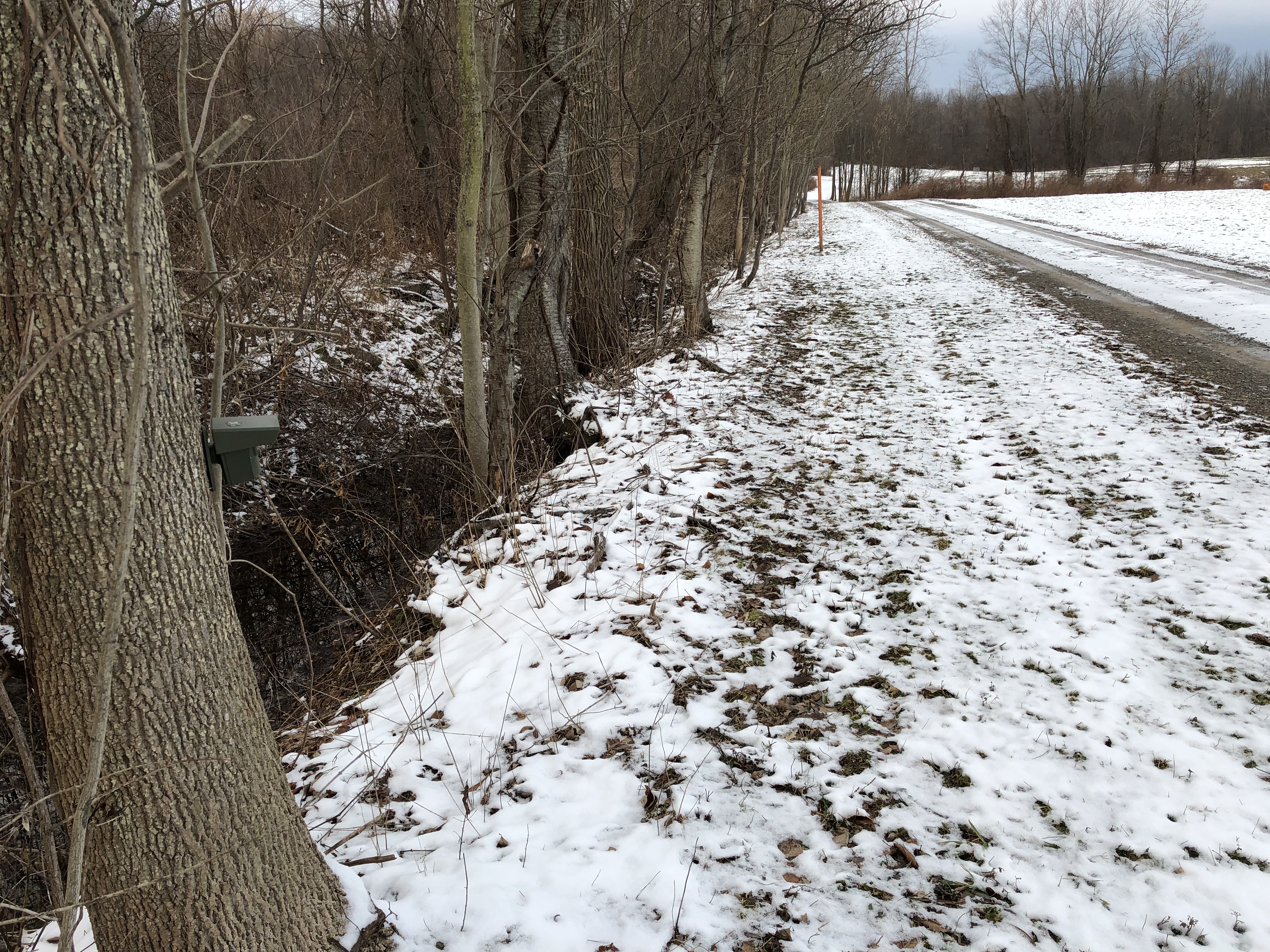

Here is the furthest one from my previous post.

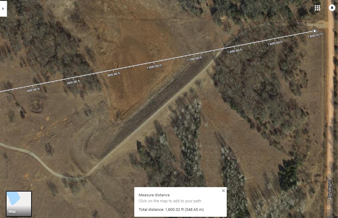

It worked :thumbsup:. Range testing will have to wait till it quits raining :(. Got just over 2-1/4 inches so far.
Well it quit raining, so I set the receiver in a upstairs window, put a short hose on the transmitter and took it to the gate. Held the transmitter above my head, it worked from the gate posts on either side, but there were a lot of dead spots also. Move it two inches and it would work, just like any UHF radio system.
Google maps shows it to be 1800 feet, the first 200 feet is through the trees, so it might not work when the leaves turn green.
Of course it worked fine on the downhill side of the trees, it is line of sight to the window.
