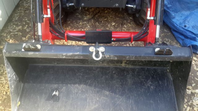

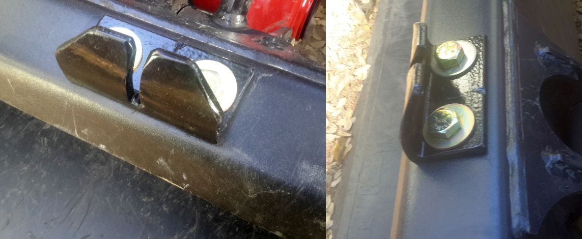

I did this as alternative to "hooks" and I had angle iron and bolts already available, just took a bit of fabrication....
bucket-jpg.575638
slots-3-jpg.575642
eyes-3-jpg.575637

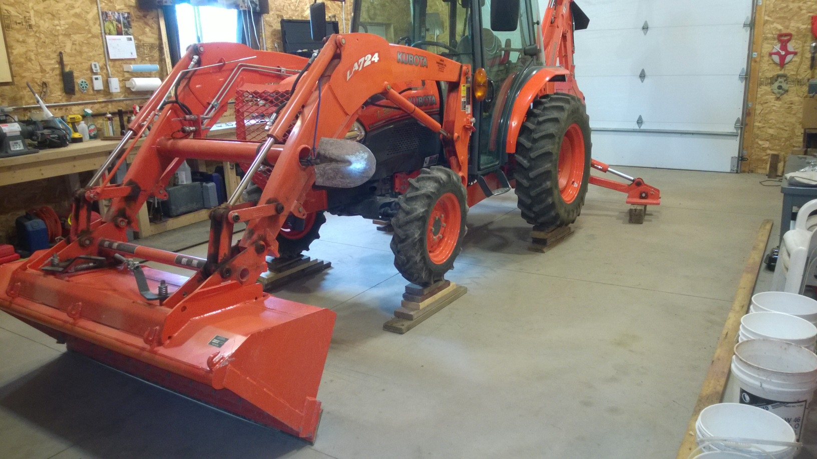

I bought 5/16" kennyd hooks, so you can use 1/4", 5/16" and 3/8". I have 5 welded on my FEL bucket and 1 each on my
BH bucket and my Ripper tooth. I've never needed a strap on there yet, but I have D-rings on short chains with hooks.

   / Attaching bucket hooks to a Kubota MX5400 with L2236 bucket #23
