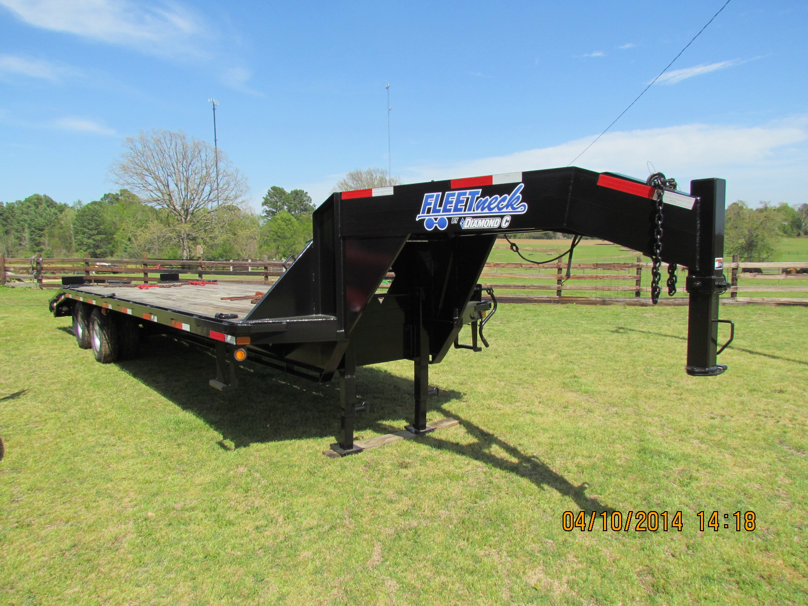

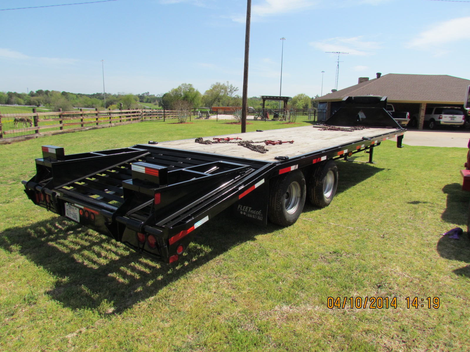

I have a 28' Fleetneck built by Diamond C that I've had since 12/98. Diamond C Trailers I had it built with 12,000# axles. I've re-floored and painted it twice since I've had it. No problems with the trailer, only regret is that I should have made it at least 32'. I compared these with the Big Tex and the Fleetneck was a much better finished trailer.

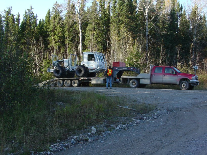

What is mounted on that vibroseis buggy? Can't really tell from
the pictures but it looks like the plate is missing and some sort of rack is on the top.
There is only two things I will haul with the trailer. A rubber tracked crawler which is only 14' long bumper to bumper and the backhoe tie down points are away from the ends due to the loader and hoe.
the pictures but it looks like the plate is missing and some sort of rack ...

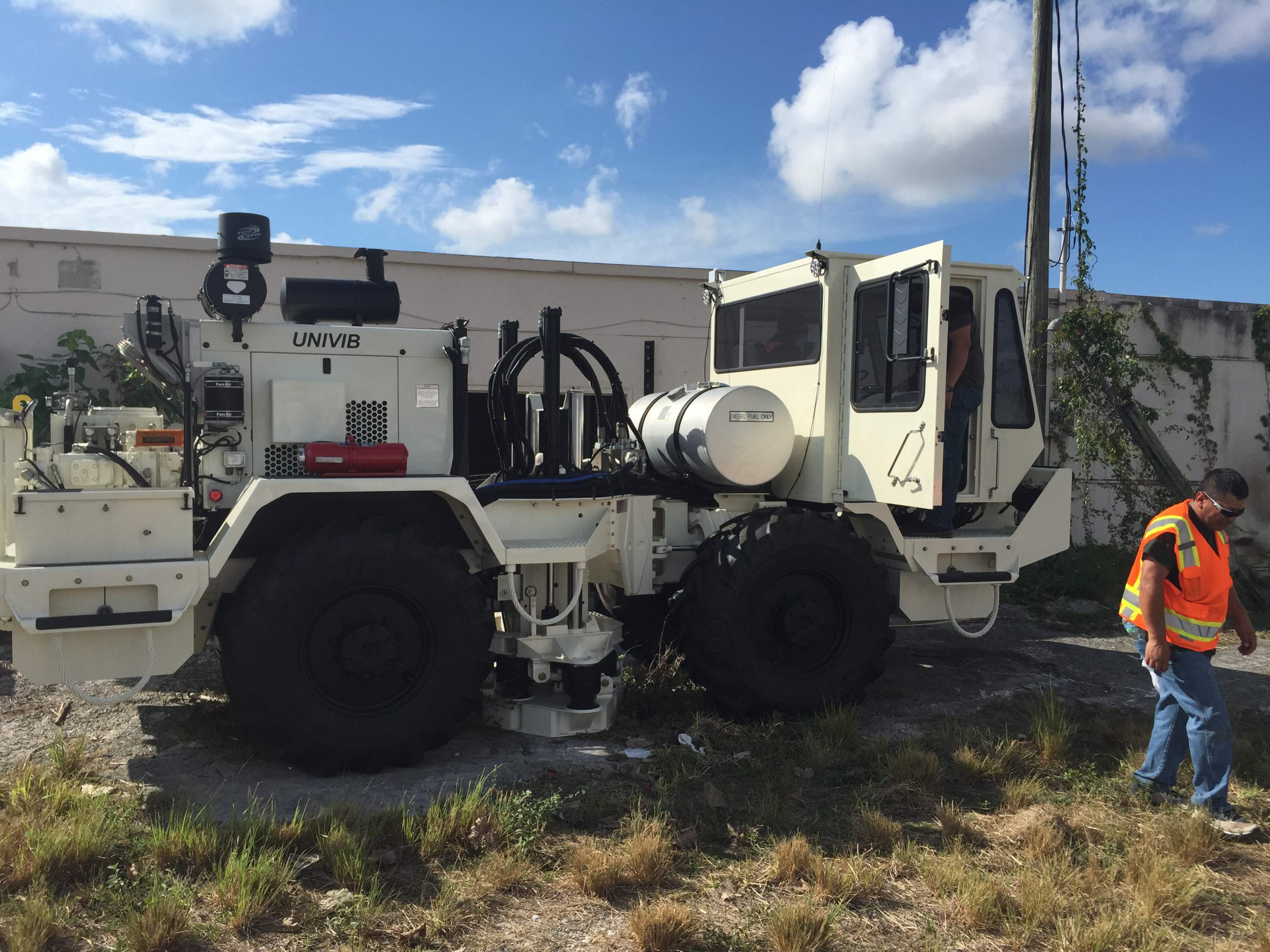

It's a mini vibe. Has a 300 lb mass for doing shear work. It's one of only a couple that are in use. That machine is 18' bumper to bumper.
/ Big goosenecks
#12
That's is a cool looking unit. We worked on a project with a mini vibe in Miami Florida earlier this year. They had that thing running down city streets through neighborhoods.

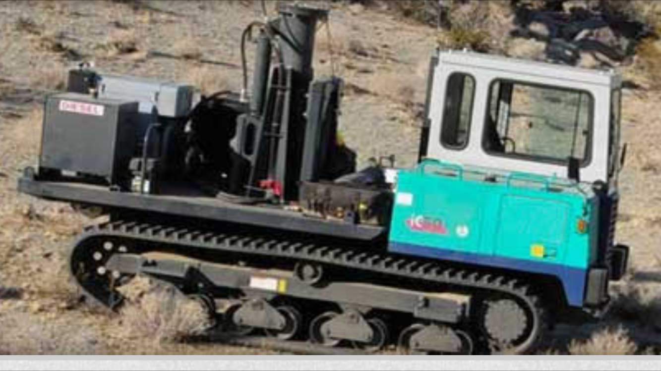

The tracked machine I will be hauling is a seismic weight drop unit.
