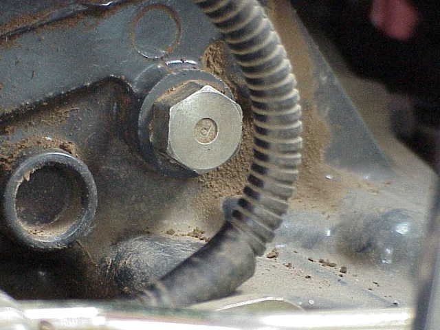

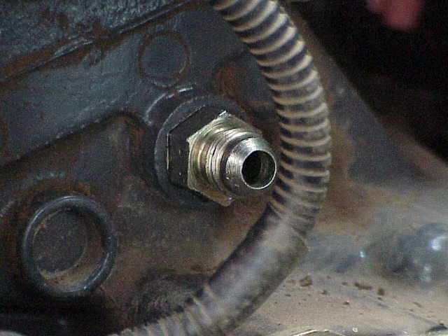

HarleyScooter,
Can you post a photo of the fitting you added on the right side of the rear diff/ trans as a return to tank line and/or provide any information on that installation?
Thanks
   / BX24 rear remotes/hydraulic top link #26
Fran, sorry I have not been on the site for a few days. The fitting I used is a
9/16-18 o-ring to a #6 JIC male adapter fitting. I used all 1/4" hyd. lines and #6 JIC end fittings. The only caution I will tell you is when you use the 90 degree JIC hose fittings on both ends of the hoses, you must be very sure of you fitting alignment or you will not be able to connect the hoses. I will attach pictures of the stock plug and then the adapter installed. I borrowed the pictures from a thread by Junkman.
Scott

   / BX24 rear remotes/hydraulic top link #27
Scott,
No problem on the delay!
Thanks for locating the great photos and the tip on the 90 degree fittings. I was driving right by and stopped by my dealer and asked what Kubota had to offer, which was a Rear Remote Valve Kit ($284) which required one of three hose sets (around $179) which sounded kind of pricey, but apparently they pull off the FEL Valve, instead of using the BH. Do you know why they would go that route?
Fran
