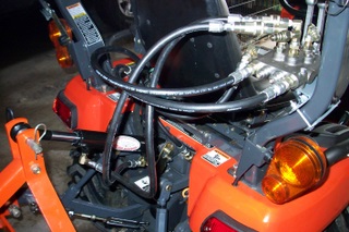

Also, my dealer suggested mounting the Rear Remote Valve on the FEL Valve Mount rather than the ROPS and I assume the Fender, any thoughts here?
Think about how you are going to use the rear remotes.
If you are turning to the right to look back at the implement your left hand will be on the steering wheel and you right hand will be right next to the fender or ROPS. This makes it very easy to use a fender/ROPS mounted valve while you are watching how the implement reacts.
If the remote valve was mounted on the FEL mount tower then you would have to cross your hand over to use the remote valve or turn back facing forward thus loosing your view of the implement. Awkward at best and impossible for some people. This way kind of makes it difficult to adjust as you are going.

Well it's done and it actually works. Thanks all for the expert advice.
