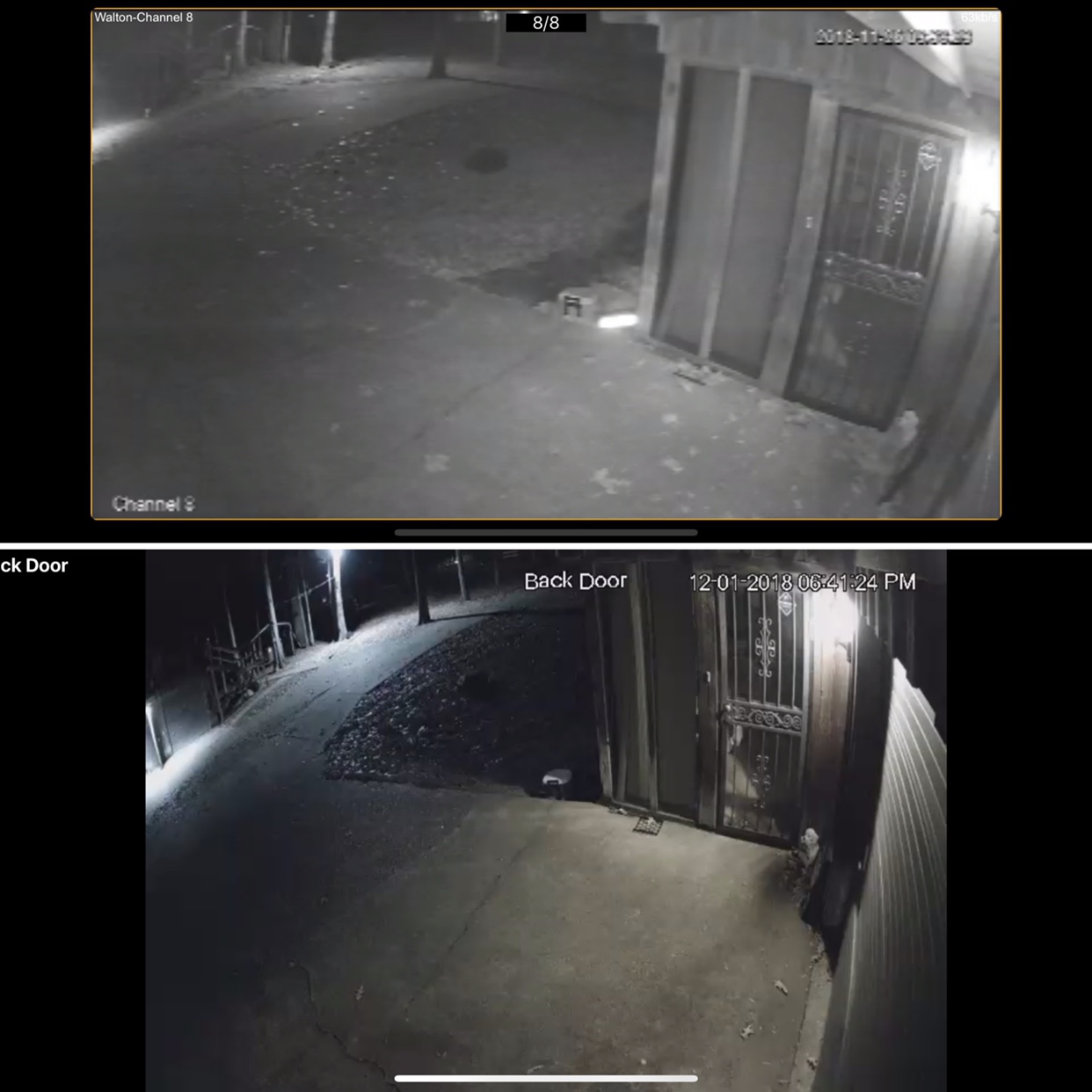

I just updated to lorex 16 channel NVR, 4 4K billets and 4 4K 4X zoom bullets. Ordering a few 2K cameras and 2 8TB hard drives for plenty of memory.
Very happy with ease of install.
Attached is a 4K 4X zoom camera then using digital zoom. The camera is about 100’ from my house ( ballpark distance)
Here is an example of 1080P vs 4K. Keep in mind, quality is much better on TV than on phone. 06D24B7E-EC95-4D0E-89EF-7B1464504884.jpg

Great comparison pic 1080 versus 4K.

Here is an example of 1080P vs 4K. Keep in mind, quality is much better on TV than on phone. View attachment 581431
Is there any reason why a person could not drop the frame rate on a 4K camera to the point the CPU can keep up compared to 1080P? It would seem a frame rate of 5 or 7 per second would be adequate, even less. We are not talking evidentiary video. I would rather see clearly what I am looking at vs smooth motion.
   / Camera Security Systems??? #210
Yea, wouldn’t be a problem.
