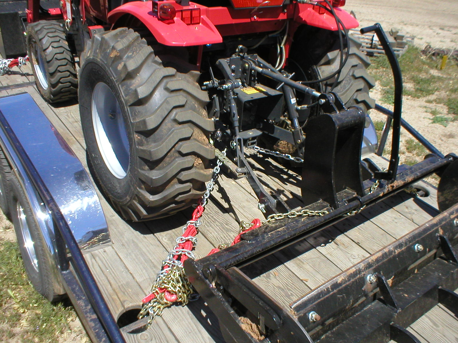

On the front axles I can attach a chain however it appears that it will hard to get a straight pull using the rear axles. The R4 tires are so wide there is little of the rear axle exposed.

Put the chains in a X fashion. What I mean is hook to the right axle and the left side of the trailer, ect.

Can't really see in my picture, but the chains cross under the tractor just as Diamondpilot said, in an x and it gets it so that the chains just clear the tires.

It looks like maybe you need longer chains. I can still see some of the chain binder. ;)

Thanks. I had not thought of that. Thats why I enjoy TBN in that I can benefit from real world experience.

Harbor freight binders and chains, no problems. 3/8 chain on the tractor and 5/16 chain on bucket and Gannon. Although I use these on this tractor-trailer, on our bigger stuff, it is all USA made stuff. ;)
interesting tires on the trailer, load range?
