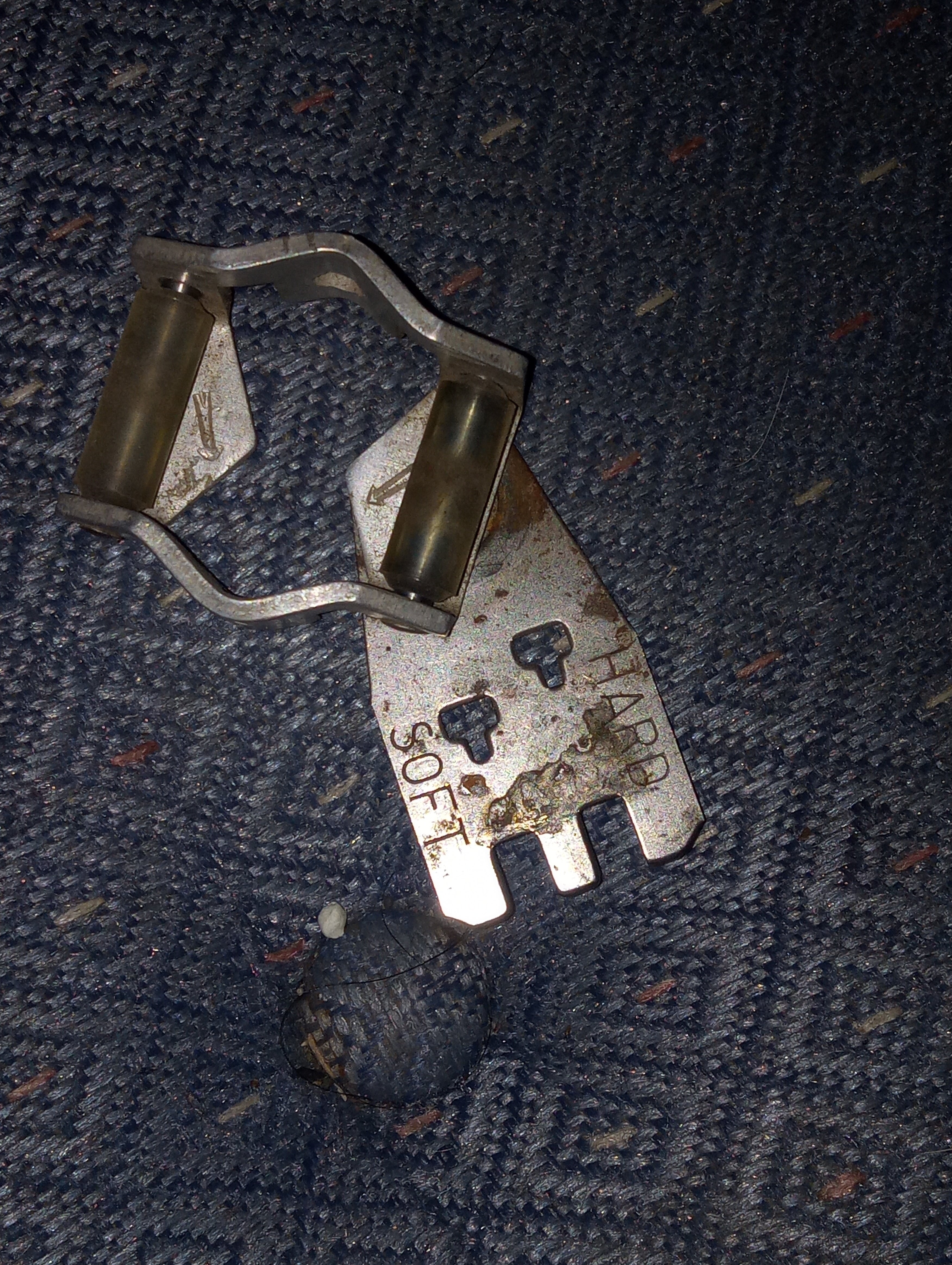

I use the little Stihl and Oregon guides that clip on the file. But even after years of various mechanical work. I still am not consistent from one side of the chain to the other.
Every 3rd or so sharpening, I use one of the Oregon jigs that clamps on the bar. It's still manual sharpening, but I get both sides of the chain sharp consistently.
/ Chain sharpening difference? #48
I have the dealer sharpen after about 5 hand filings. This has been my file guide journey.
Touched up the chain, but pretty inconsistent by angle and side to side
Not much better
Improved angle and side to side consistency, but funky to use
Worked great! Roller helps keep angle consistent
My favorite so far! Part of it is Pferd files are great, built in depth guide and rakers get filed at the same time.
