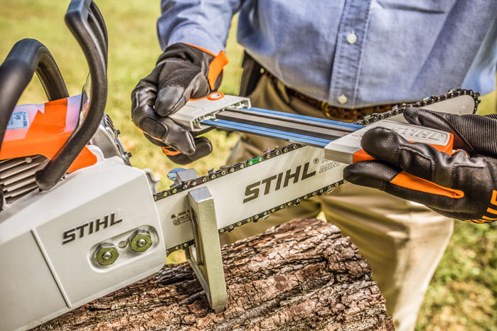

I bought the Sthil sharpener, one for the CS490 and one for the pole/limber trimmer/pruner....
Carry a Rigid container with collapsible handle on the front bucket. The container has everything I can think of for field work. hatchet, Sthil sharpeners, wedges, bar oil wrenches, gloves etc.
Cut a few tress, drink water sharpen chain, more water cut again until too whooped to continue....
Often wonder when does the chain get replaced though.
The Sthil tool sharpens and file the rake so it all wears pretty even.

I bought one of these a few weeks ago. I was skeptical but thought it would be good for touching up the chain in the woods. It works great and takes only a few minutes so I bought another one for my 3/8 chains
That's all I've ever used (well, the older, more basic versions of round file guides).
I've recently splurged on the stump vice also shown in the picture, instead of resting saw on a work bench or truck tailgate. Very handy in getting a consistent file angle.

Like YLee Kioti in post #5 I have the Stihl sharpening guide/holder that sharpens the rakers and teeth. I later found the Pferd sells what looks like the same holder much cheaper. Both are available on Amazon. I carry a simpler file holder guide for touch-up in the bush if I happen to dull the chain on a rock or dirt. I touch up the chain with the saw in a vise after every tank or two of gas. Keeping the chain sharp greatly reduces the work, and it just takes at most 10 minutes.
