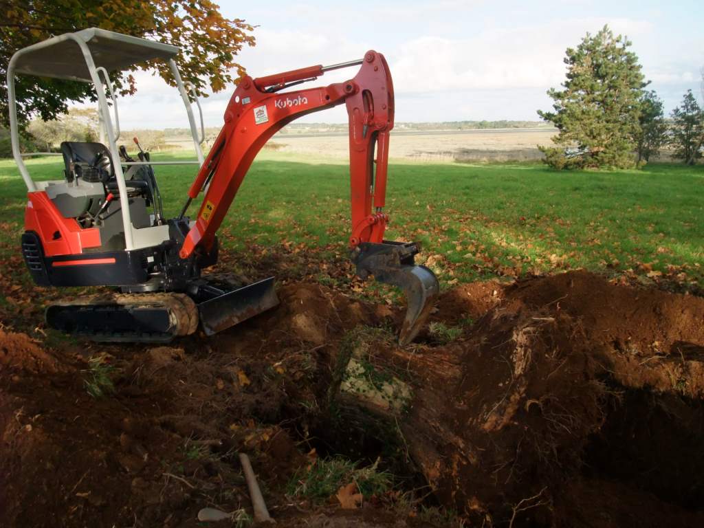

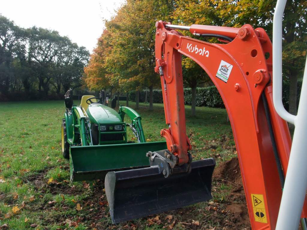

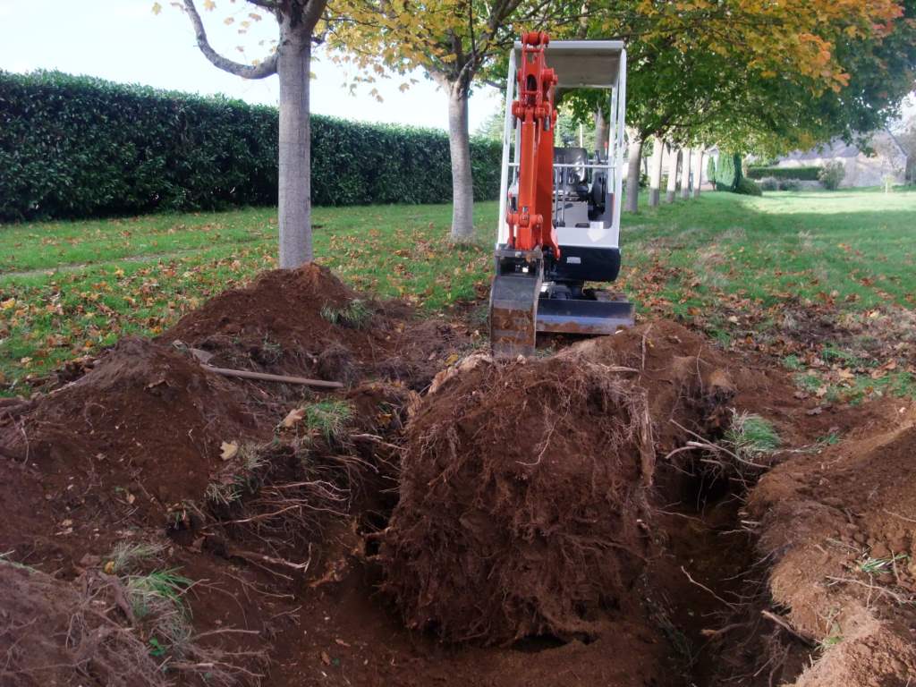

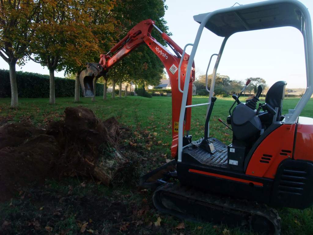

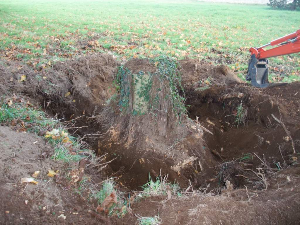

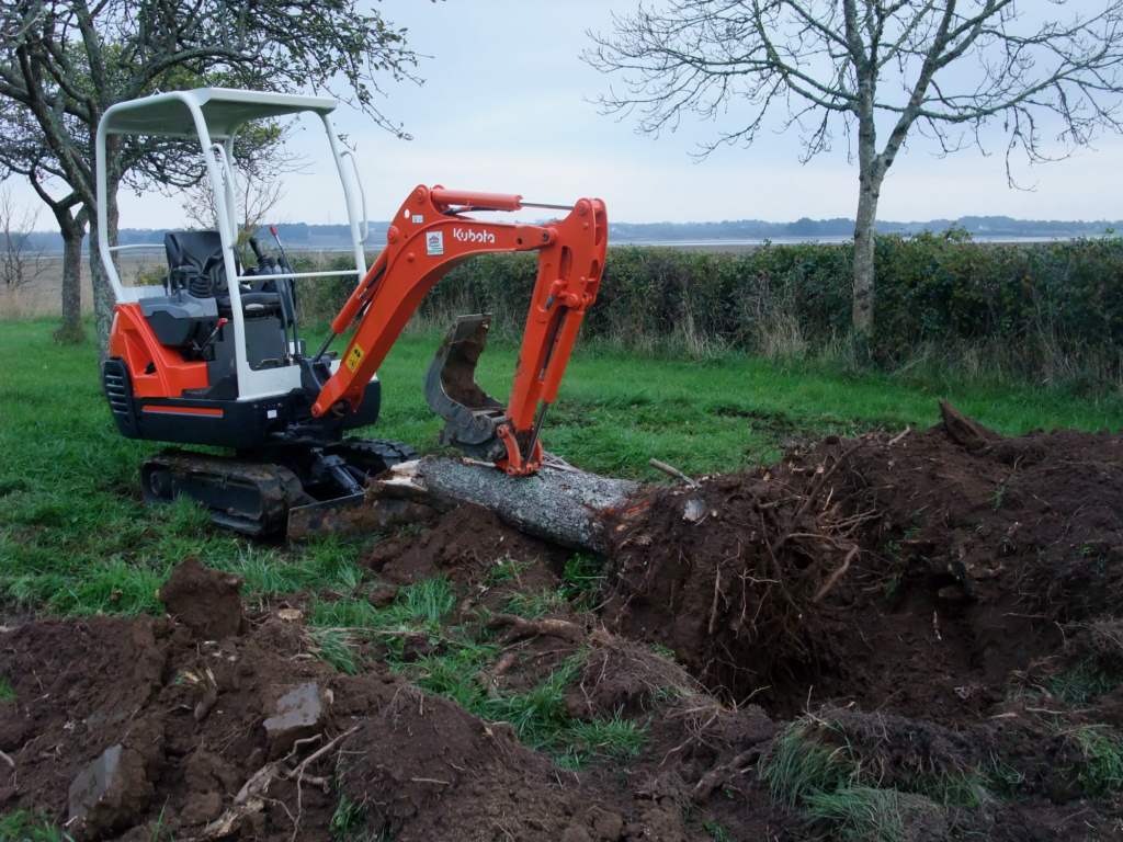

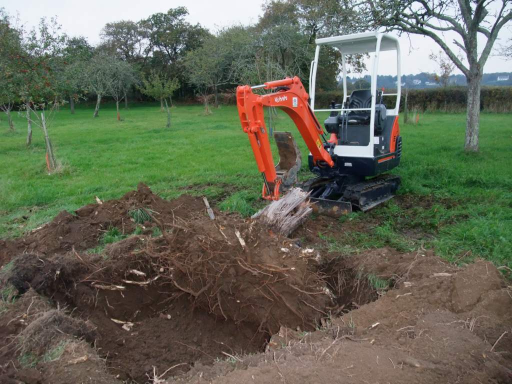

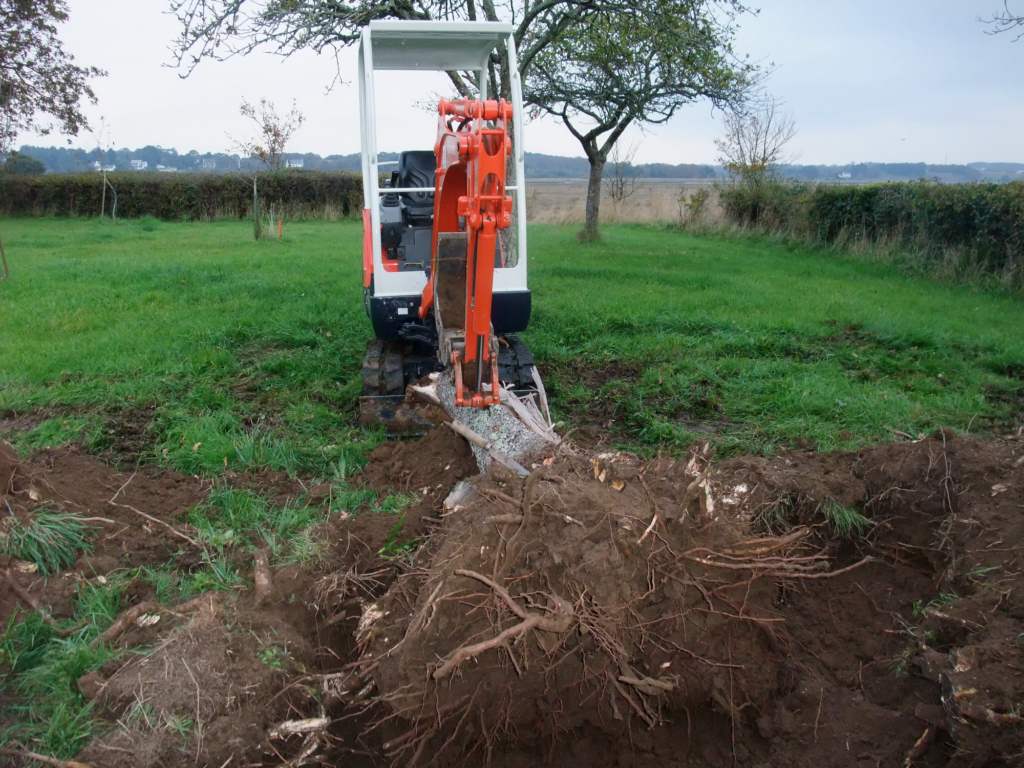

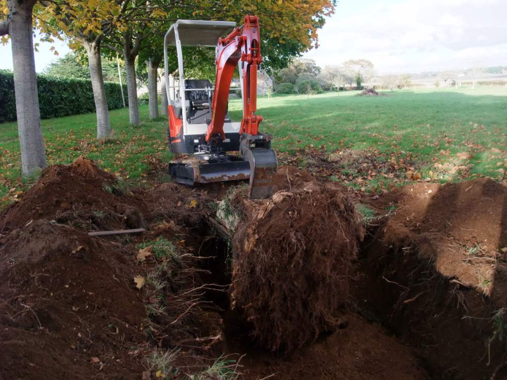

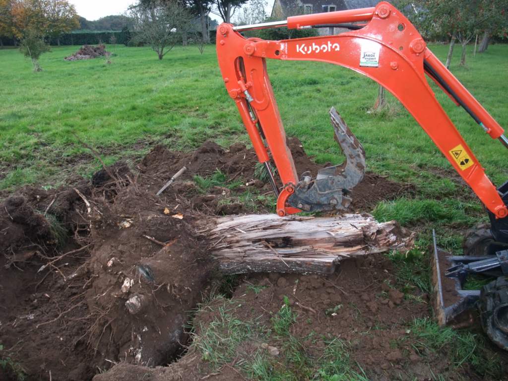

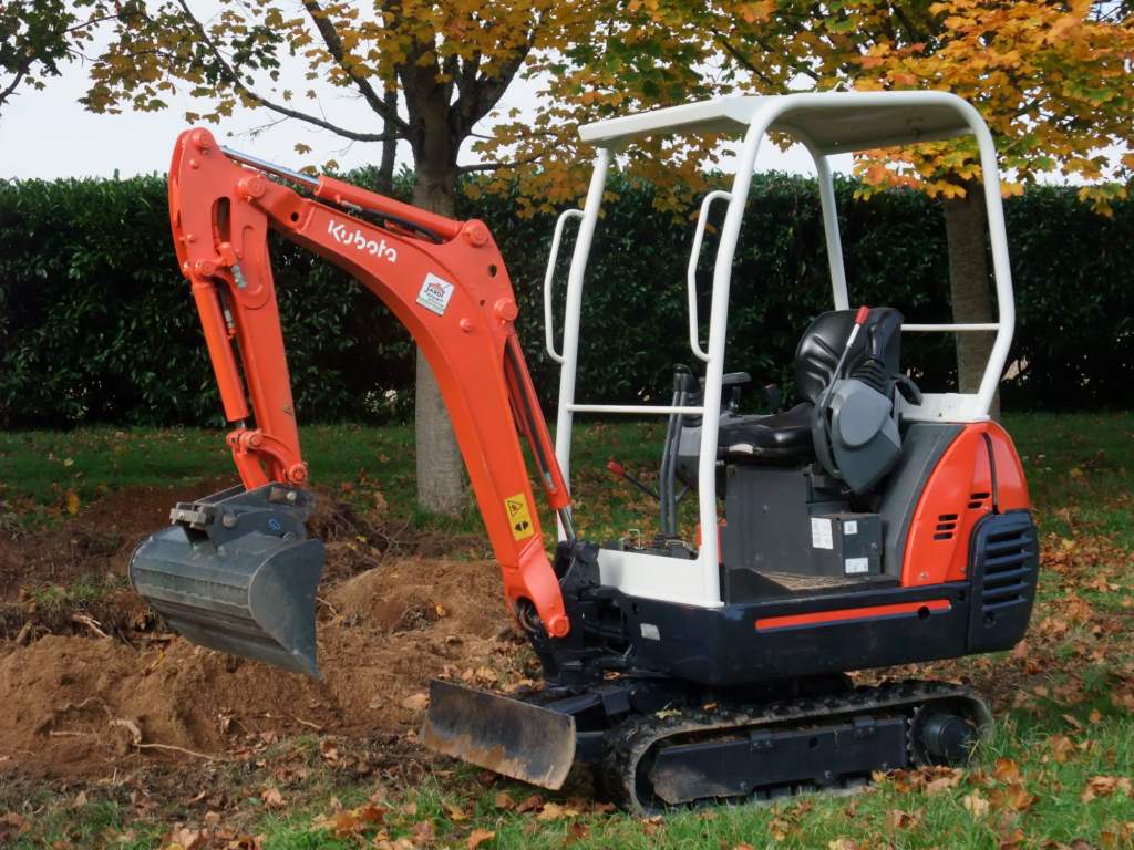

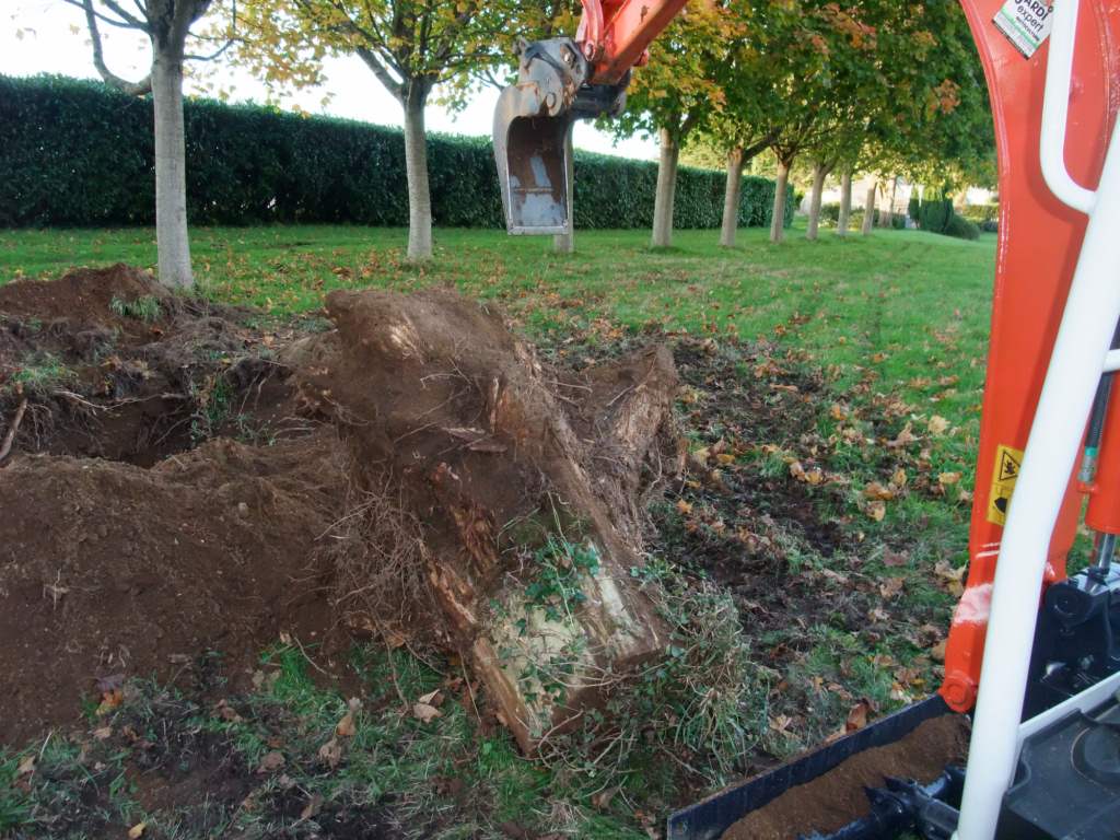

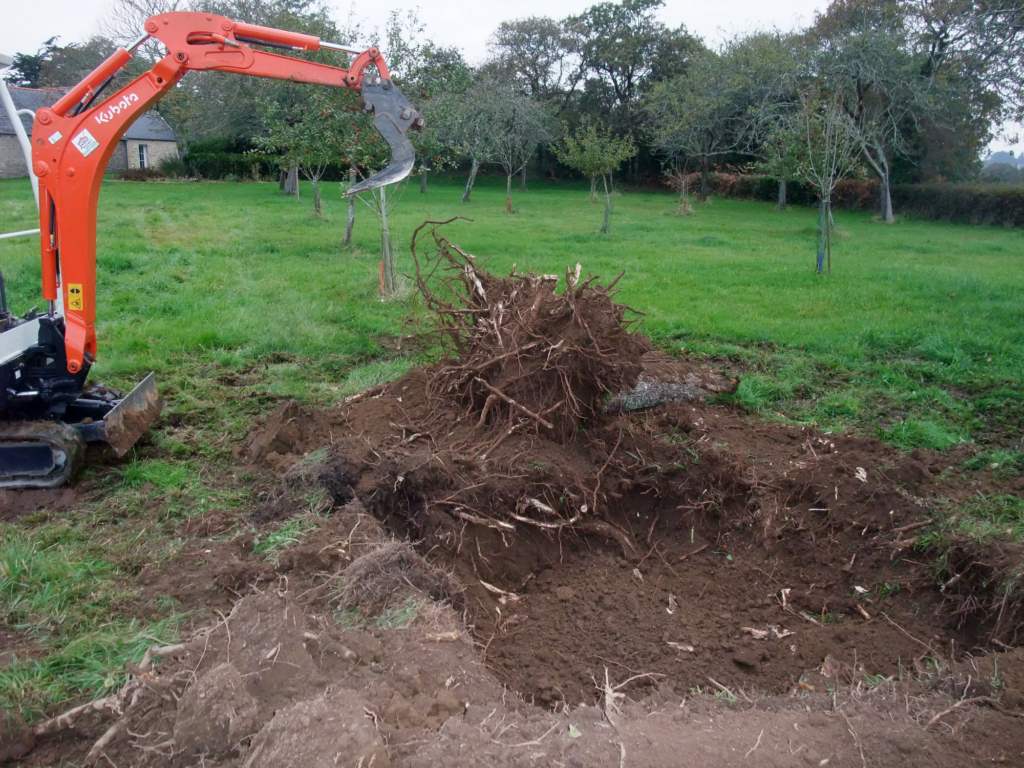

Like many others, I think the best way to go about it is renting a mini excavator, even a very small one like mine if you are not in too much of a hurry. Much more efficient than a tractor to get a stump out.

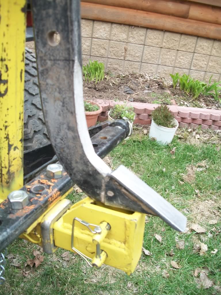

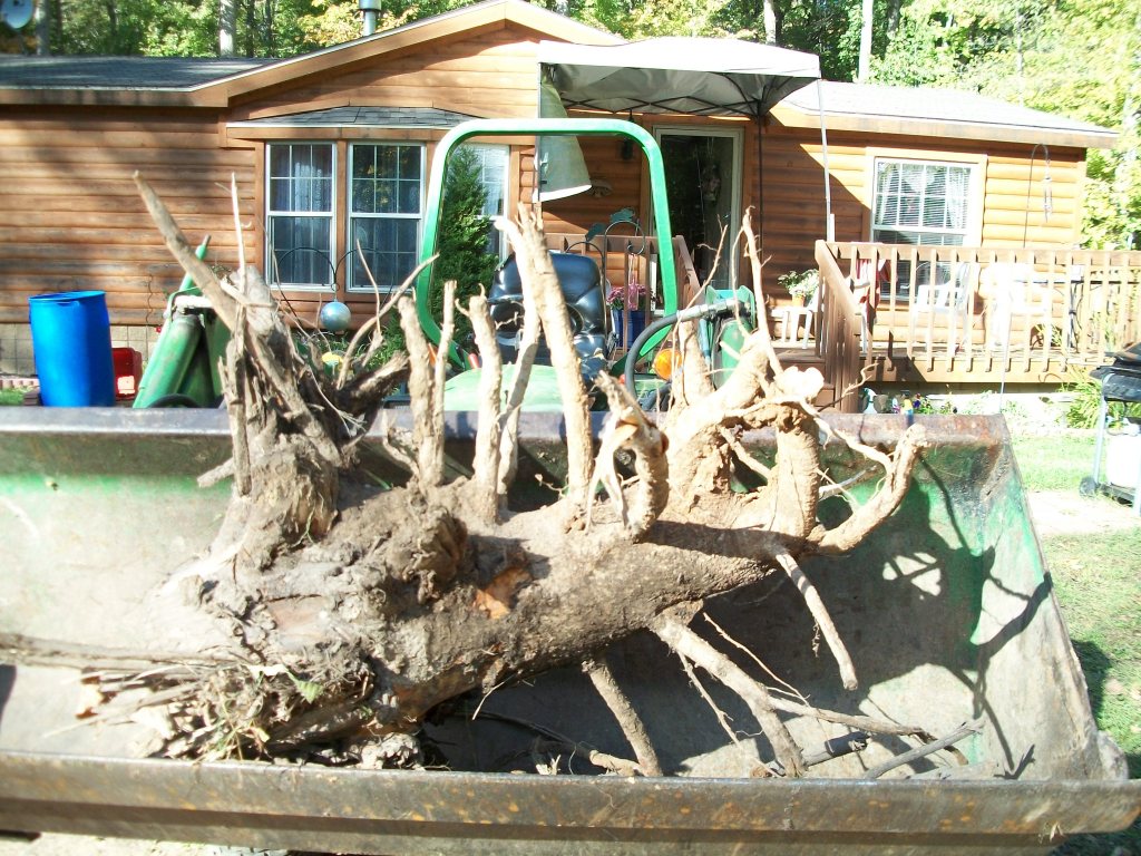

I was clearing a small area today. I used a tool that was posted on a forum. Not sure if it was on this forum but the tool works good. I have used it many times before. I work alone so this is a slow process. Lots of up and down on the tractor.
Some of the brush that I pulled.
The largest tree pulled today. It is 4" just before the root. I pulled it out with the engine idling. I have pulled larger trees out but my tractor is on the small side so I am a bit limited.

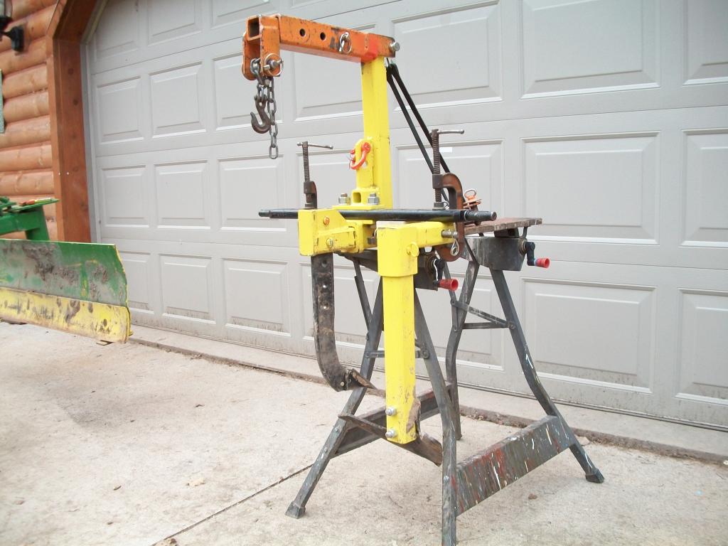

The tool I used. It has a 6' chain. I should have used a 10' chain. I plan to add a straight rod to the end of the chain. This will make wrapping around brush and threading thru the pipe easier.
Here is some info on the bipod puller that was mentioned earlier in the thread. Again I got this info off a forum.
