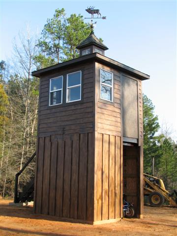

Got off to a late start today. It was 41 degrees at 9am, so I waiting until 11 when it was in the 50's. High today was close to 60, so it was a prerry rough day weatherwise.
The stain is all on, and now I just need to wait for it to dry so I can seal it with the clear coat. I'll do that next weekend.

Eddie was it not been about a year ago you used the gel stain with clear coat over Hardi plank oh your gazebo? Wondering how it has held up, which I assume it has if you are doing it again. Noticed any fading or break down of the clear coat?

Yes, I did the same thing on my gazebo type building for my hot tub. I had experimented with dozens of stains and finishes on sample pieces of Hardi before finding the Gel Stain from Minwax. I even tried other brands of Gel Stain, but the Minwax is what I like the best by a very large margin. It's sort of pricey at $14 a quart, but I did the entire deer blind on three quarts, so it's not really all that bad. The Helmsman comes in gallon cans, and I think costs around $20. I'll buy a new 4 inch brush for that too, but it's really not that expensive.
There is absolutely no sign of wear or fading on the gazebo. I've been inspecting it since applying it to see how it holds up. I can't find any sign of failure. It's only been a year and a half, so it could still fail on me, but I thought it was worth the risk to do it again.
The Gel Stain does take longer to dry and clear coat then regular stains on wood. I might be able to put it on today, but I'm going to wait until a free day this week, or next weekend to do it just to make sure the stain is completely dry.

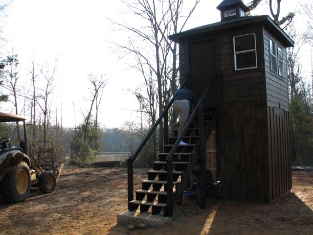

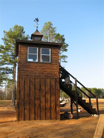

The railing is on!!! The posts and railing went on real quick and easy. It's a simple PT 2x4 the length of the stairs with three posts per side. It won't pass code anywhere without the spindles, but it gives you something to hold onto and a sence of saftey.
To blend the Preasure Treated wood in with the trim and stained Hardi siding, I wanted to stain the wood as dark as possible. I had an old gallon can of Danish Walnut that was ten years old. It was less then a quarter full. I also had a gallon can of Antique Oak that was less then a quarter full. A half quart of Dark Walnut and a quart of Red Oak that was close to half full. I mixed them all together and got lucky. I had exactly enough to get it done!!!!!!!!!!
Doing the under parts of the stairs wasn't what I'd can fun. In fact, of all the words that came to mind while doing it, none are approriate for sharing on a family website. LOL
Steph took the pictures. I apologize for the one of my rear side, but included it because it shows Lake Maribou in the background pretty good. The view of the pond from the deer blind is pretty good.
Steph finished painting the interior today, which is what I was waiting on before staining the steps.
It's starting to look like something.
Eddie
