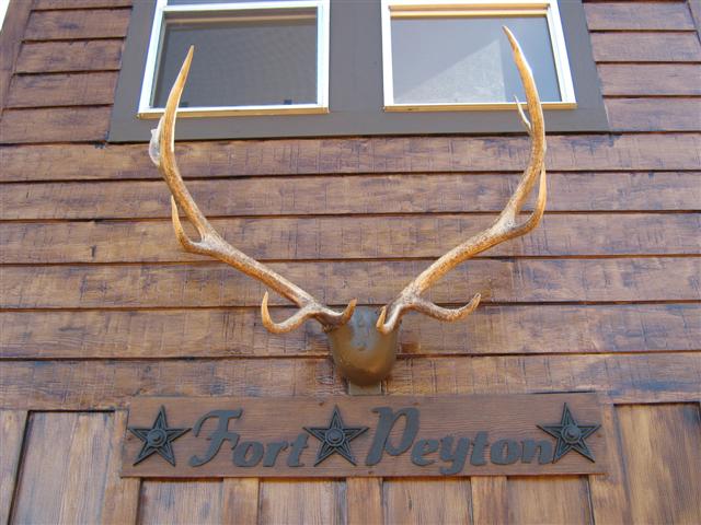

I think I finished it today. There is still the decorating and all that to do, but that's something that will never be done. :D
First thing that I had to do was clear coat the siding. It only took me three hours to do this, which suprised me. I was thinking it would take all day, but had hoped I could get it done with enough time to install the sign.

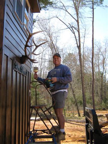

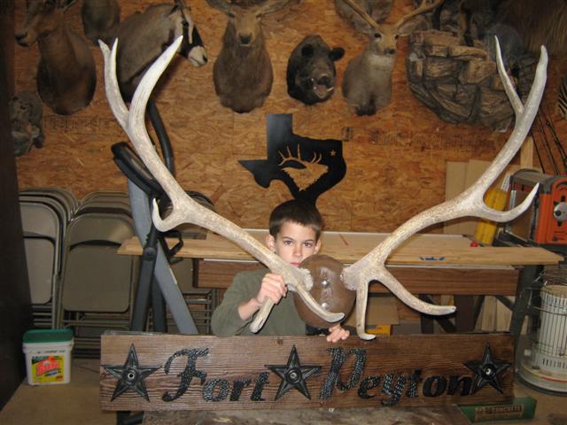

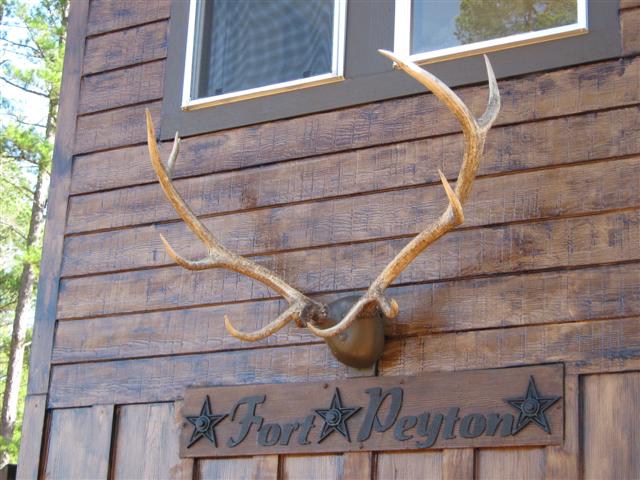

Several months ago, I started building the sign. Steph and I decided to name the deer blind and kids playground, Fort Peyton. He's our son and it has a nice ring to it. Kind of like Fort Bridger or something that might have been used in the "old west."

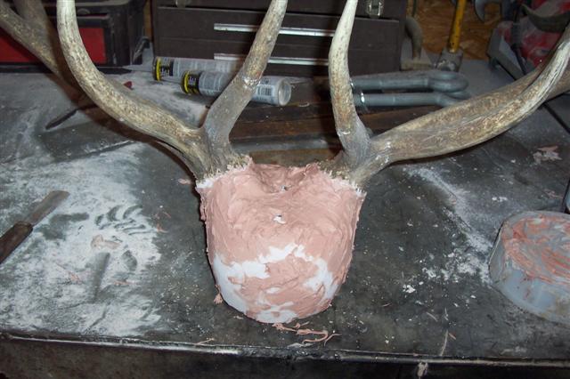

I shot a 6x5 elk in Idaho a while ago and have been tripping over the anters ever since. It wasn't big enough to get mounted, but it was big enough to keep. :) I just needed to come up with something to do with them that I liked. The sign seemed like the perfect solution!!!

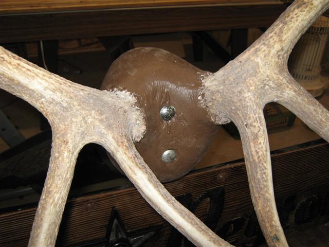

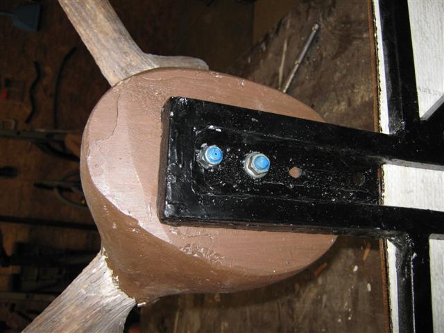

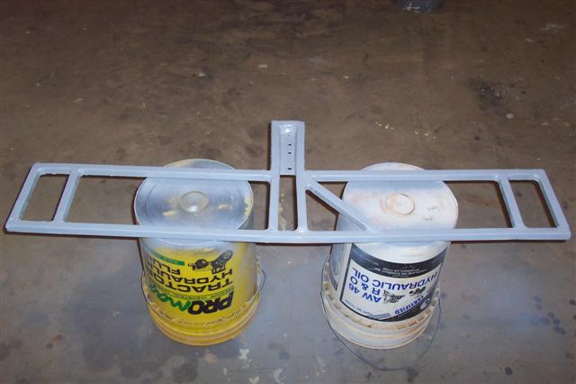

I made a metal fram from one inch tubing that would fit Fort Peyton on it with three stars to mount it. I used a piece of Hardi siding for the board, and stained it to match the siding on the Fort. To protect and hopefuly, keep the antlers together, I cover the skull plate in Bondo. One full gallon of it was just right. I then drilled though it and used two 3/8 cairrage bolts to mount the antlers to the metal frame of the sign. I even used locktite on the bolts!!! The sign is then attached to the floor joists of the Fort with half inch lag bolts. It should be pretty strong.
To finish it off and protect the antlers, I clear coated all of it.
Eddie

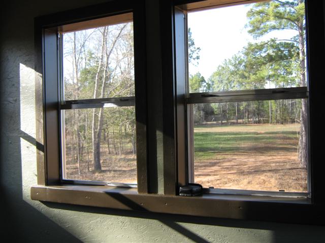

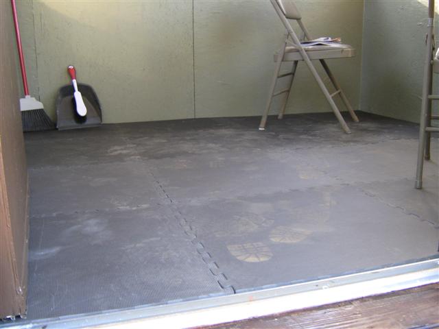

Steph painted the walls a sage kind of green with a whitish greenish kind of green ceiling and the same dark brown for trim that I used on the exterior trim. The flooring is foam squares that interlock. I'm hoping for a level of insulation from them and to quiet down our movements while inside the blind. It's also soft to walk on!!!
I have a Carbon Monoxide detector on the wall as well as a fire extinguisher next to the door. I'm a little worried about running the heater in such a small place when it's cold out.
I still have to install the shelving unit, and some other finishing touches like a clock and some sort of thermometer. I also have an idea that might be really cool, but don't know for sure just yet.
The views are what make it !!!!! To the South, is Lake Marabou. To the North is the food plot and deer feeder. To the west is a road with lots of trees, and to the East is the rest of the pasture that the food plot is part of. In every direction, the view is amazing.

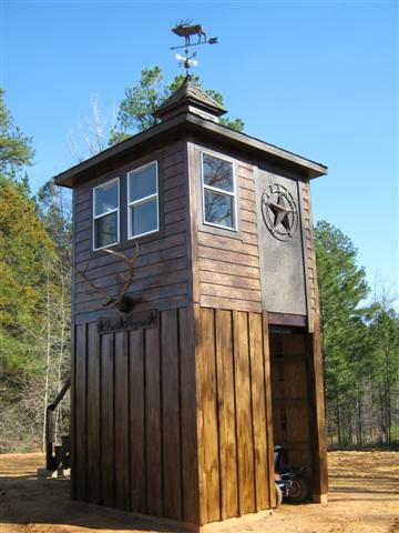

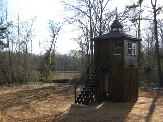

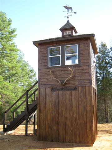

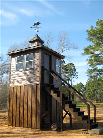

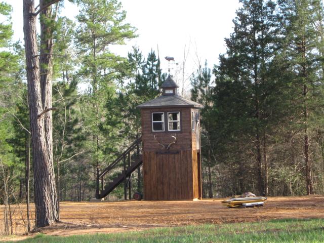

Here's just a bunch of pictures that I took of it when I was done and cleaning up the area. You can see Lake Marabou in the background in one, and you can see the food plot in the foreground in another picture. The way it blends in, and compliments my place is much better then I had hoped for. It doesn't stand out like an eye sore, but adds to the natural beauty of my woods.

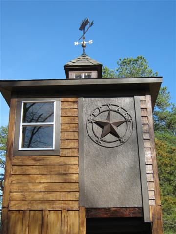

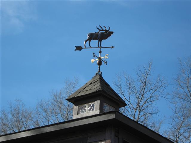

The weathervane is starting to patina, and looking better. The sign looks like it's part of the fort, which was my goal. I had a Texas Star from another project and had been trying to figure out where to put it. The temporary door looks like the perfect place. I'd like to have more contrast there, but since it's just for the time being, I'm gonna leave it be.
One of the things that I like the most about the finished stain is that it looks old. Just standing there and looking at it, I get the feeling that if I told somebody that it was over 100 years old, they might believe me.
We are very pleased with how it turned out.
Eddie
