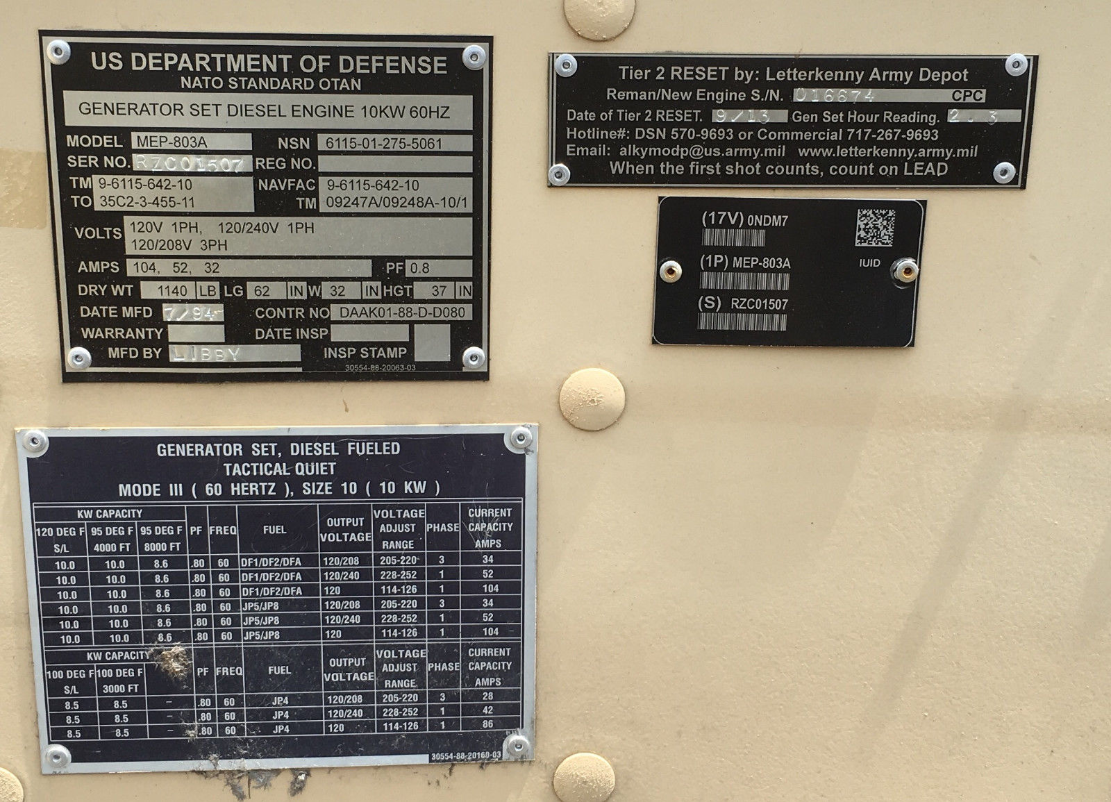

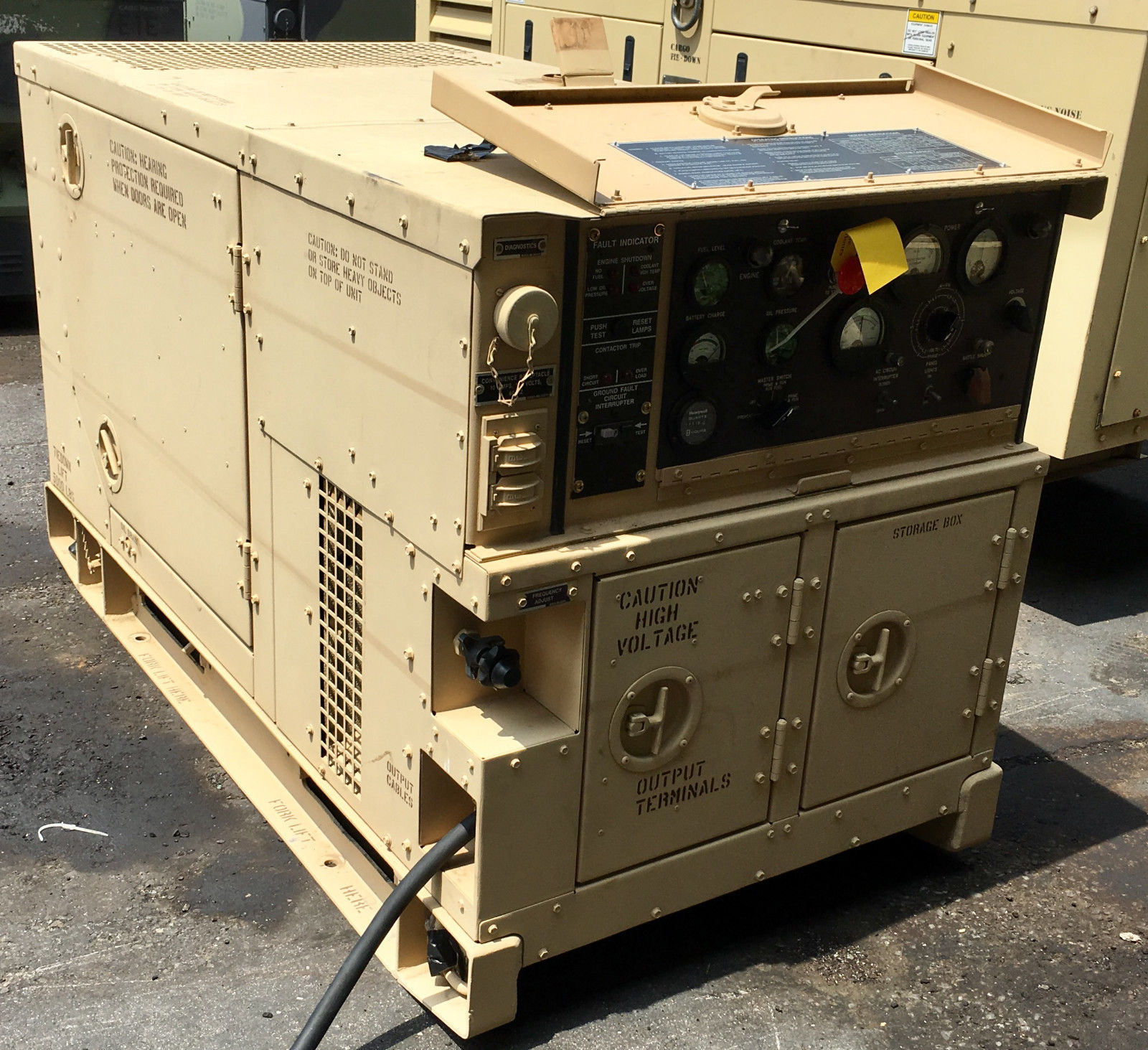

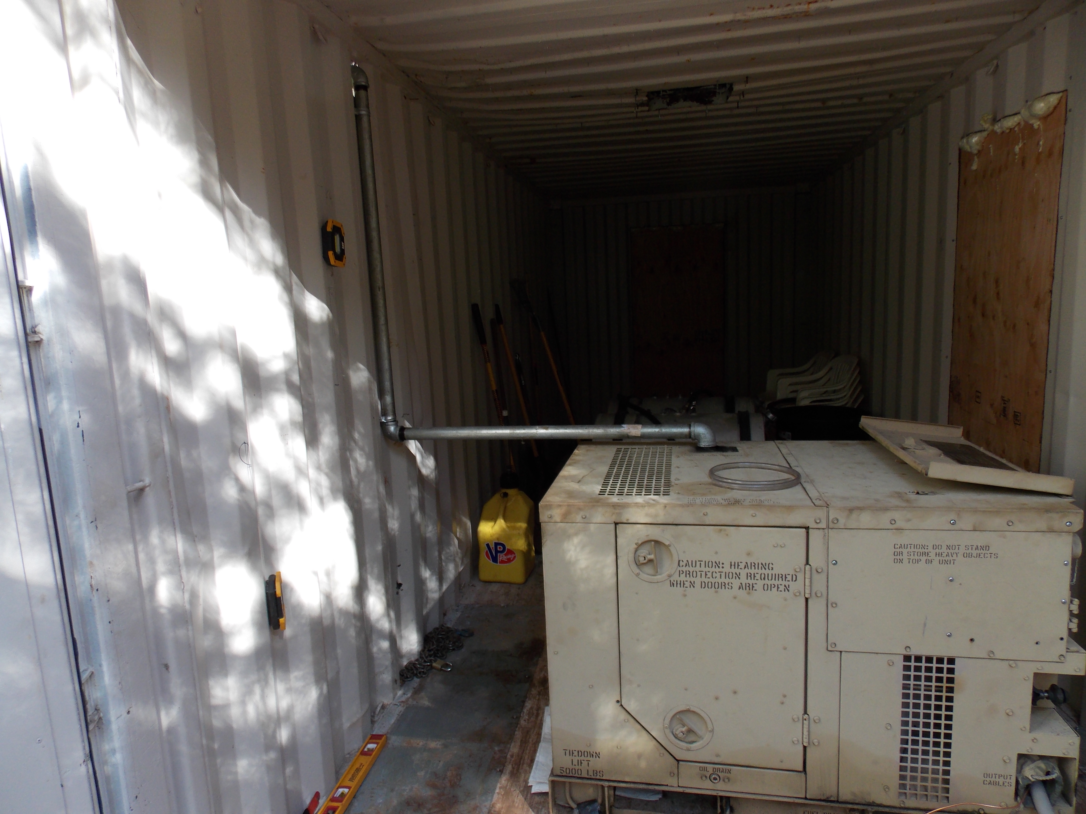

I'm off grid in Nor-Cal also. I installed a military diesel generator in a small shipping container. Its a "MEB803A Tactically Quiet" 10K that can be had on the surplus market for around $4k!! I don't have enough posts to post websites yet but, look at ebay for MEB803A and search google for steel soldiers. The 803A's are technically rated at 10K but will peak at over 15k and are around 78 db. Take a real good read at steel soldiers under generators. Then go to Ebay and check them out. These are really are the cats meow for off grid life!! Please contact me through PM if you would like to talk directly.

Thanks for responding. The OP said he was interested in at least 10kw. Parts are no problem. Green mountain generator has everything you could want and, so does Ebay. Really though, these things just don't break down! Just service them fairly regularly and they run for ever. The price is also reasonable for a 10kw unit. There is six from one guy on Ebay right now with less than 500 hours for $4200 mounted on trailers less than 8 hours drive from the OP!! Military specs because they are way over engineered!

If you read enough of steel soldier you will find that buying mil genset is bit of a gamble, I have 802a but I like reading manuals and fiddling around. Low hours is no guarantee of condition, if you see one with 40 hrs that's 10 years old it has not be seeing regular service and common problem is water in the exhaust that rust a cylinder and valves. Right now on gov't planet the stock of 803 do not run, so guys buy three hoping to get two running. I bought mine from a guy who fixes and sells them and he gave 3 year labor used part guarantee. But I only spent $2500. and if you want over 10 kw the 804 are 15kw but 3 phase only which means really a 10kw unit. A few months ago gov't planet had three 804a that ran and they all sold between $6k and $7k not deal to me. Buy what makes you happy
