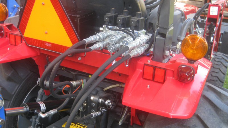

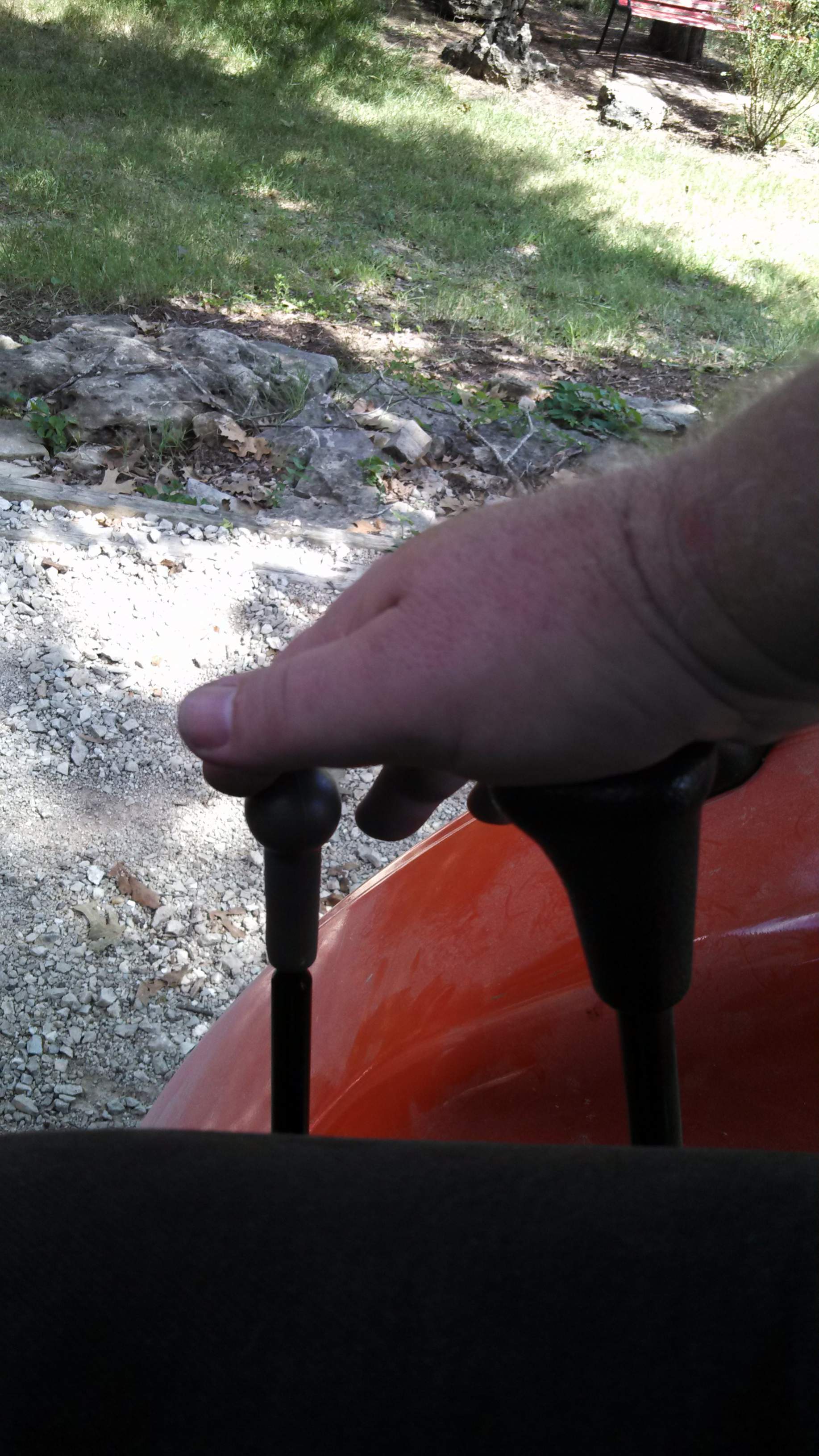

There are lots of way to skin a cat, and I don't have anything against either the diverter or 3rd function setups, but I have got to tell you if you have a conveniently placed rear remote connection, Which the Kioti DK series is, then you have a quick and cheap setup for a grapple. I extended the lever about 4 inches taller so that can keep my hand on the loader joystick and still operate the remote lever to operate my grapple.. After using it for a few months, I find it so easy and intuitive to use I would not switch to either a diverter or 3rd function setup if someone gave it to me.
The ability to feather the pressure is useful to me, and while I went this direction originally to save money, now after using it for about 9 months I like it so well, I would not switch.
I have about $150 total in hoses and connectors, and a few dollars to lengthen the control stick.

I have a 2305 ,the electric diverder is mounted to right lower loader frame with a tee to outlets , one goes to the front for grapple forks other goes to the rear for my hydraulic top link , if I dont want the link to move I just un hook the hoses.

If you are talking about the double solenoid valve, here is how it works.
You need a 3 position switch with the center pin +12 v.
With the switch in sw1, 12v is applied to the curl solenoid of the valve and the curl will work normally.
With the switch is sw2, 12v is applied to the grapple solenoid and the grapple will work.
If you leave the switch in neutral, the relief will activate because no fluid is flowing with no voltage applied.
Select your operation before using the lever.
The other single solenoid valve works different by using one solenoid to route the fluid .
In the no voltage state, the curl will work.
With 12v applied, the grapple will work.
